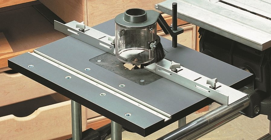

Another question: it also came with the SS router table, just the actual tabletop and fence, no over arm parts, table base or anything else. I have seen pictures of this table attached to the SS using one of the telescoping legs etc. but I can't find any parts diagram to figure out what other parts might be needed.

SS has sold several variations of Router Tables over the years, including stand-alone and mounted models in under-table, OAR, and pin router types. I've had a similar experience where I got one with a used SS, but it turned out to be originally free standing and under-table only, and though it looks similar to one version of mounted table it is not the same. I recommend you take the following steps: (1) See how flat it is compared to your expectations. (Mine was not flat, so I stopped at that point though I may later look into a mounting method that flattens it.) (2) Post pictures of the front and back. (See the picture posting thread near the top under Community, posting pictures is not completely intuitive.) Someone on this forum likely will have the same product and can identify it and provide assistance. If it is the type that you are thinking, it originally used an Extension Table Base as the primary mount with the telescoping support leg.
Suggestion: If you think you'd like to try this mount I would first securely clamp the router table between an extension table and main table in approximately the same position to test it out. Also look under Tool Reviews for a review of the one you have.

As David mentioned there are a few versions of the Shopsmith router table. Can you post a picture of yours? Does it look like this one that mounts on the end of the Mark V? This is the version of Shopsmith router table that I have. I don't remember if it came with a manual. If it did, it was only an assembly manual for putting it together. It is just a table, dust shroud and fence, so pretty simple design.
https://www.shopsmith.com/ownersite/cat ... rtable.htm

While looking for something else, I found a couple of manuals that may be of use. The first one is the parts list for the table that SS most recently carried, same one RFGuy posted a pic of:
Mark V Router Table kit parts list.pdf
End Mount Router Table
(361.46 KiB) Downloaded 1410 times

RFGuy - What is the material of the gray router table? My table is white, MDF, and appears to be both larger and thicker.

Yeah, my router table looks pretty much exactly like the one in the Shopsmith photo that I posted. So it has grey laminate on top and is an MDF core underneath. I share your dismay with Shopsmith for discontinuing certain products. I wish I had gotten the Pro router table model that Shopsmith sold that could mount in the 520 rails, but I have this earlier Shopsmith router table model. However, I just got a Jessem MAST-R-LIFT™ II at a really good discount and I can't wait to get it mounted in a cabinet in my shop to put it to work soon. So, my Shopsmith one is going to be retired...

I am not sure how bad shipping will be but I have everything in the picture with the exception of the table and the fence knobs.
