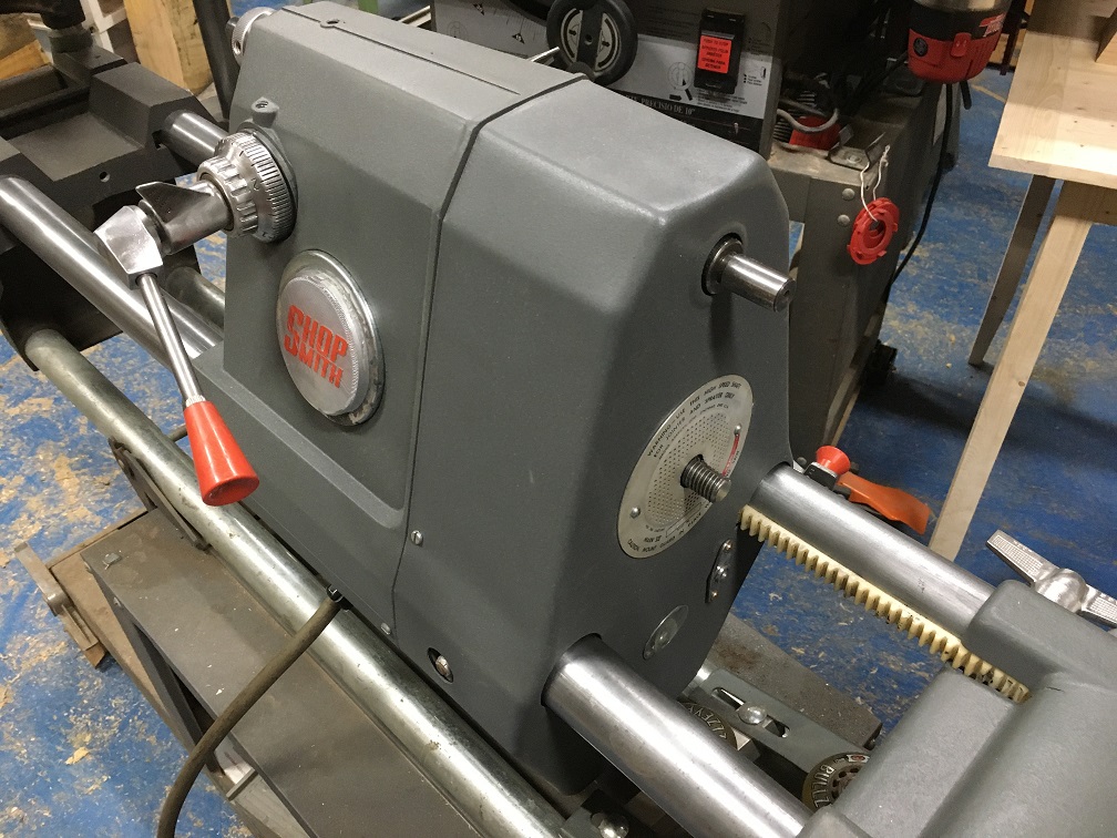

I have continued to work on the VII as I found time. I painted the headstock housing and cover with Rustoleum Textured Dark Pewter.
I have new bearings in the quill and on upper drive shaft and a new motor drive belt in the housing. I do not stock the bearings for the VII eccentric so will order 2. The poly belt was in good condition but geting a bit hard. I put it in a freezer bag with a bunch of silicon spray and left it to sit about 8 hours. When I pulled it out, there was no liquid left in bag- the belt had absorbed it all and was more flexible and looked better.

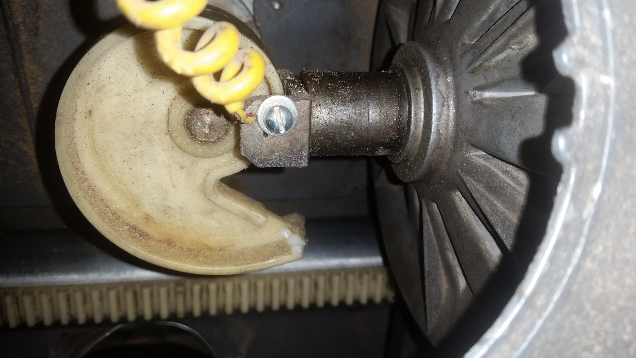

I also had Kirk send me a picture of the gear track part he printed. The original track is 2 15" sections. His printer can print 15" parts but it is more efficient and a better quality if he does it in 1/2- so would mean 4 7.5" sections for a full VII track. I'll keep everyone posted how it goes. I need to send him a SuperShop part as a pattern to replicate but the parts I have purchased from him in the past I am quite happy with.
- VII headstock new paint
- VII headstock new paint.jpg (290.13 KiB) Viewed 11714 times
- gear track printed.jpg (67.63 KiB) Viewed 11714 times

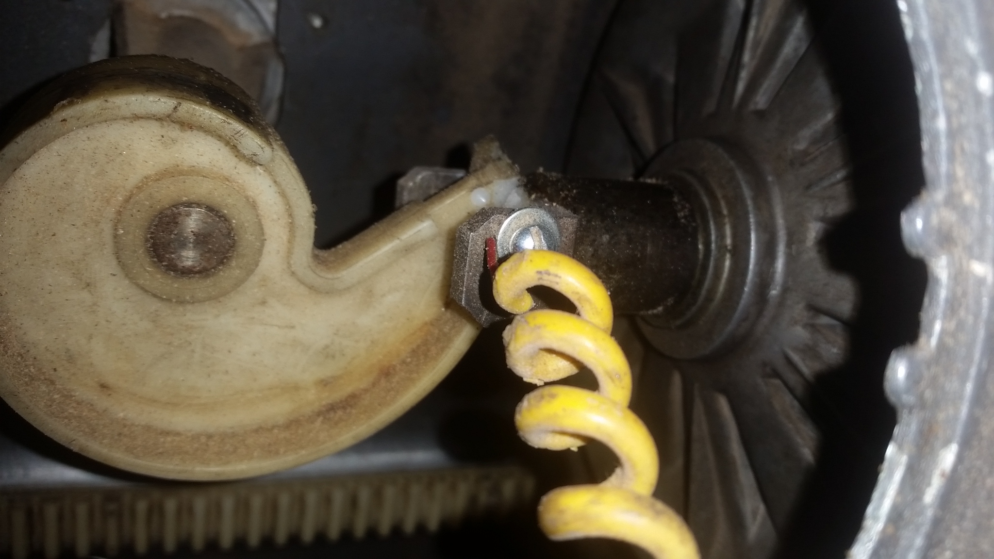

attached pics of my cam at slow and fast speed.

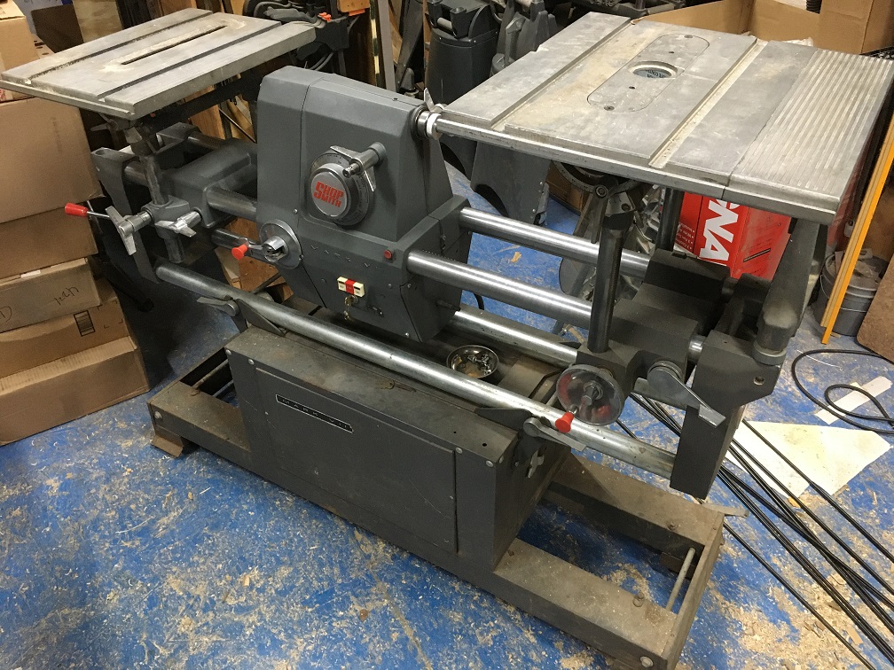

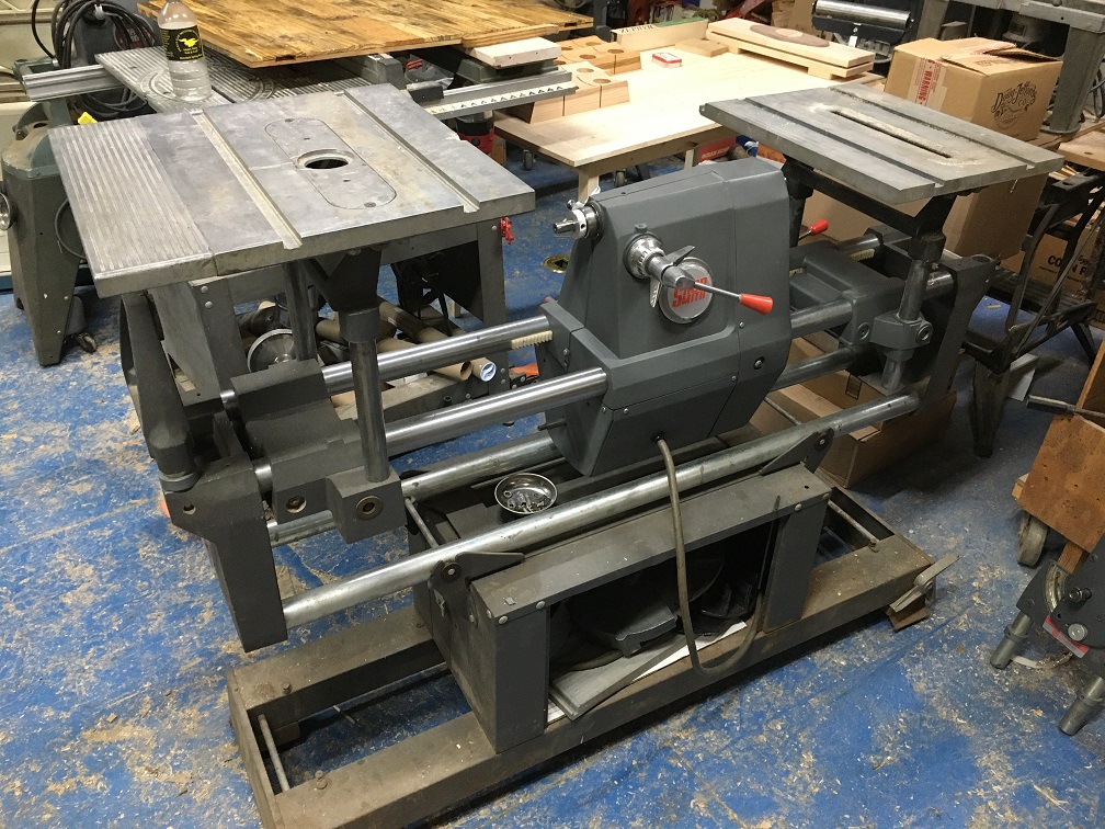

Here are some pics of progress so far. Headstock in new paint and cleaned up front and rear and VII in current state with VII and V carriages - VII carriage has V table with tubes turned 180 and V carriage has slot cut to clear gear track. The ends and base still need cleaning/fresh paint. I probably will not install the dust collector. it is all there but not very effective compared to what I already have. I have a 2HP on a cyclone collector I built. It sucked up a wooden leg from the drill press I was drilling and let go for just a moment. Fortunately it stopped at the blast gate. I may not need the 3 HP upgrade I am considering. :+D
