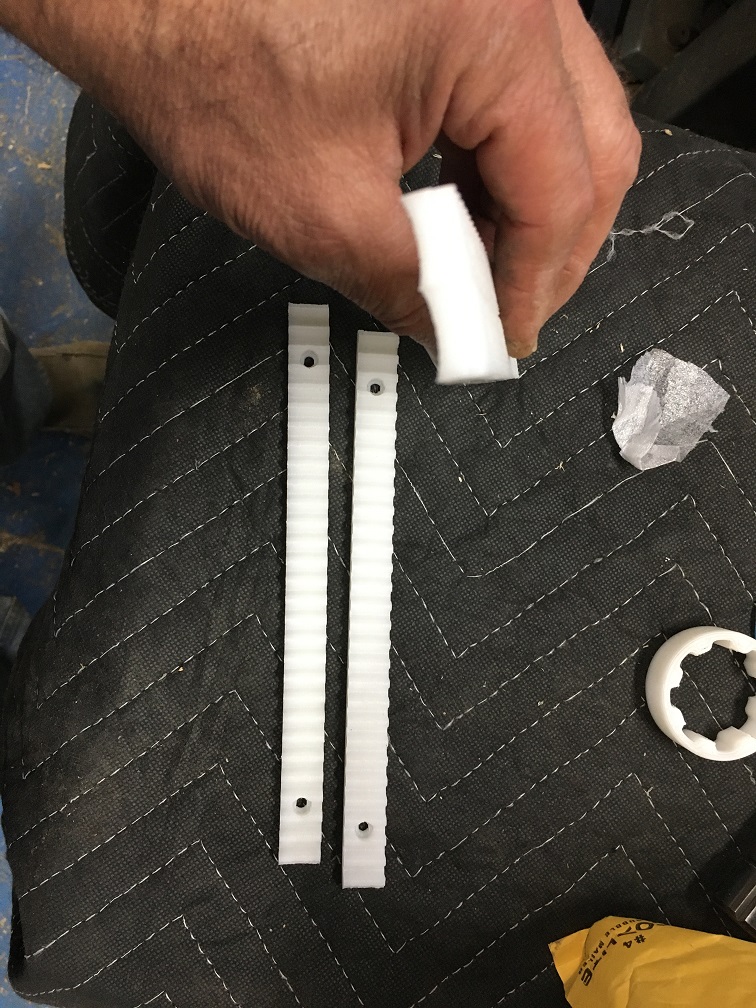

Just curious how the printed track has been holding up for you.

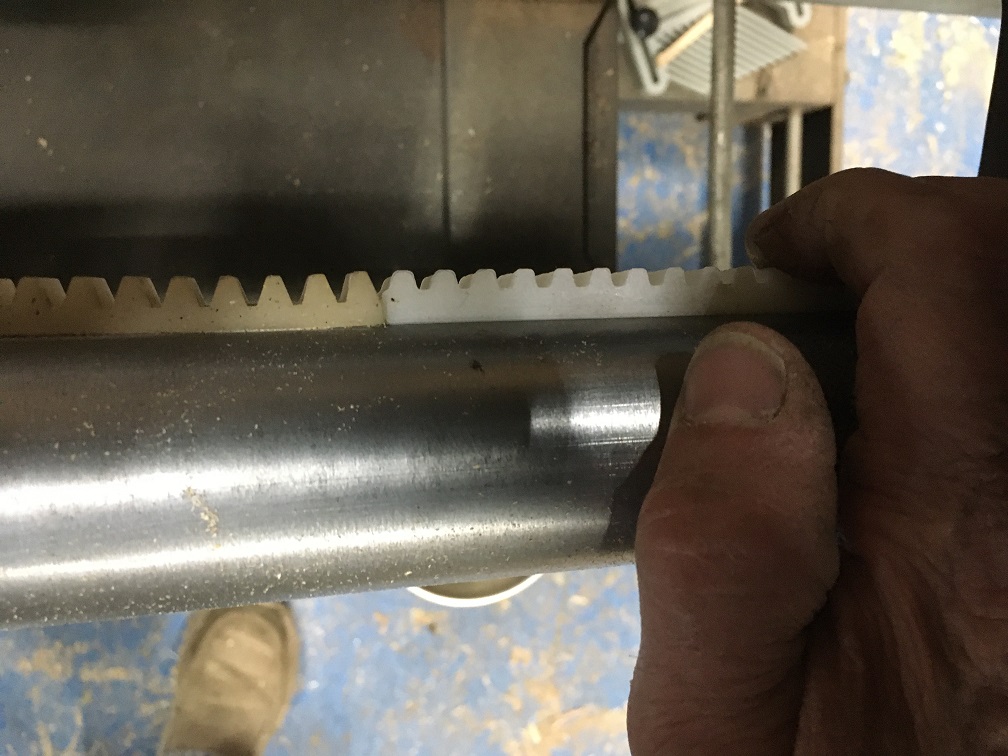

I received a prototype printed set of gear tracks yesterday. Holding next to the original set on my VII they look good but there is a difference in depth of grooves and the originals look more pointed. I plan to sent some feedback to person that printed them for me. I am not sure how to test these without drilling the rivets and installing. It was easier to print the track in 7.5" sections not the original 15" sections so more holes will need to be drilled in the bars to install and more rivets needed. The rear curvature looks good and seemed to fit well.
I did also get drive hubs for both Fox & Smithy SuperShops that fit perfectly- only mention here because I know some that watch this forum also have both types of machines. If you do/want to follow the SuperSop thread, here is link to the Lumberjocks forum-
