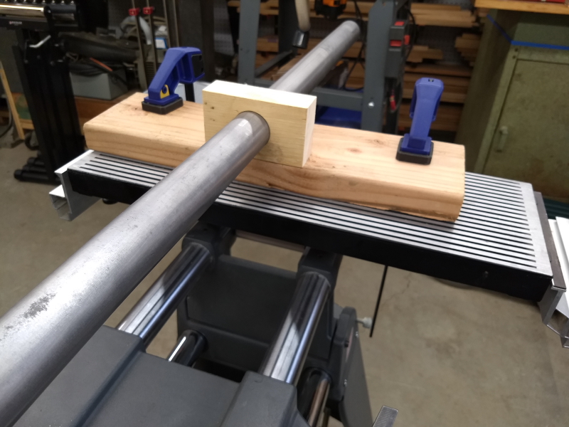

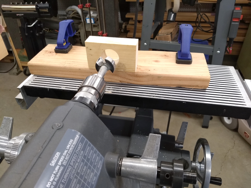

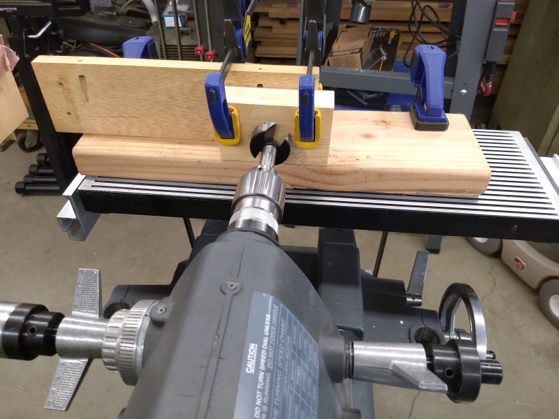

The first pic shows my quick-and-dirty tube support ready for drilling. It's nothing but a couple scraps of construction lumber fastened together with decking screws, and it mounts to the Aux table with a couple of clamps. The hardwood scrap was clamped on just to back up the bearing block for through-drilling.
Ready to drill.JPG (392.72 KiB) Viewed 11864 times
And now we have a nice clean hole. I applied some JPW to the ID as "sleeve bearing" lubrication.

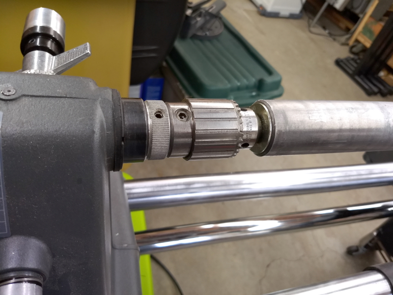

Because I already had one, I used a rubber expansion plug to drive the tube. To get a better grip on it with the drill chuck, I replaced the hex nut with a longer hex standoff.

The "sleeve bearing" worked perfectly. After filing down the set-screw burrs, I cleaning the tube with 320-grit sandpaper, lubricated with mineral spirits. Because the "bearing" fully captures the tube, I was free to work from the front side of the machine, pressing the sandpaper upward against the bottom of the tube. Bearing friction was minimal, and the tube temperature rose only a little bit in the vicinity of the bearing. To access the part of the tube occluded by the bearing, I only had to extend the quill.
However, I realized that I should have relieved the bracket base back behind the bearing block. As pictured, the space between the tube and the bearing base is just the right size to suck in careless fingers. Needless to say, I sanded that little section of the tube from the top side, very very carefully.
