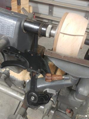

To get through the current project (a walnut trimmed bowl on a faceplate with a walnut vertical inclusion) I have chosen to use a clamp to secure the post from rotation.
It's not easy to see but the graphic shows how the clamp can (crudely) prevent the rotation of the post for this turning. May not work in all cases.
