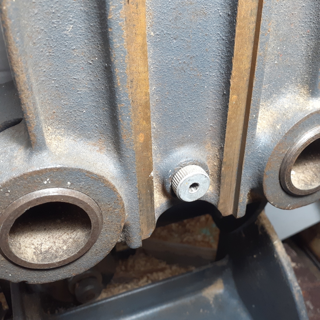

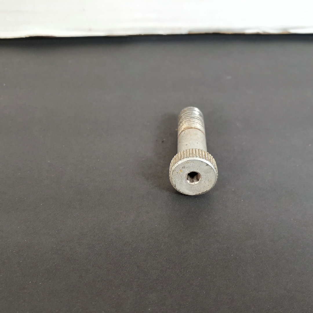

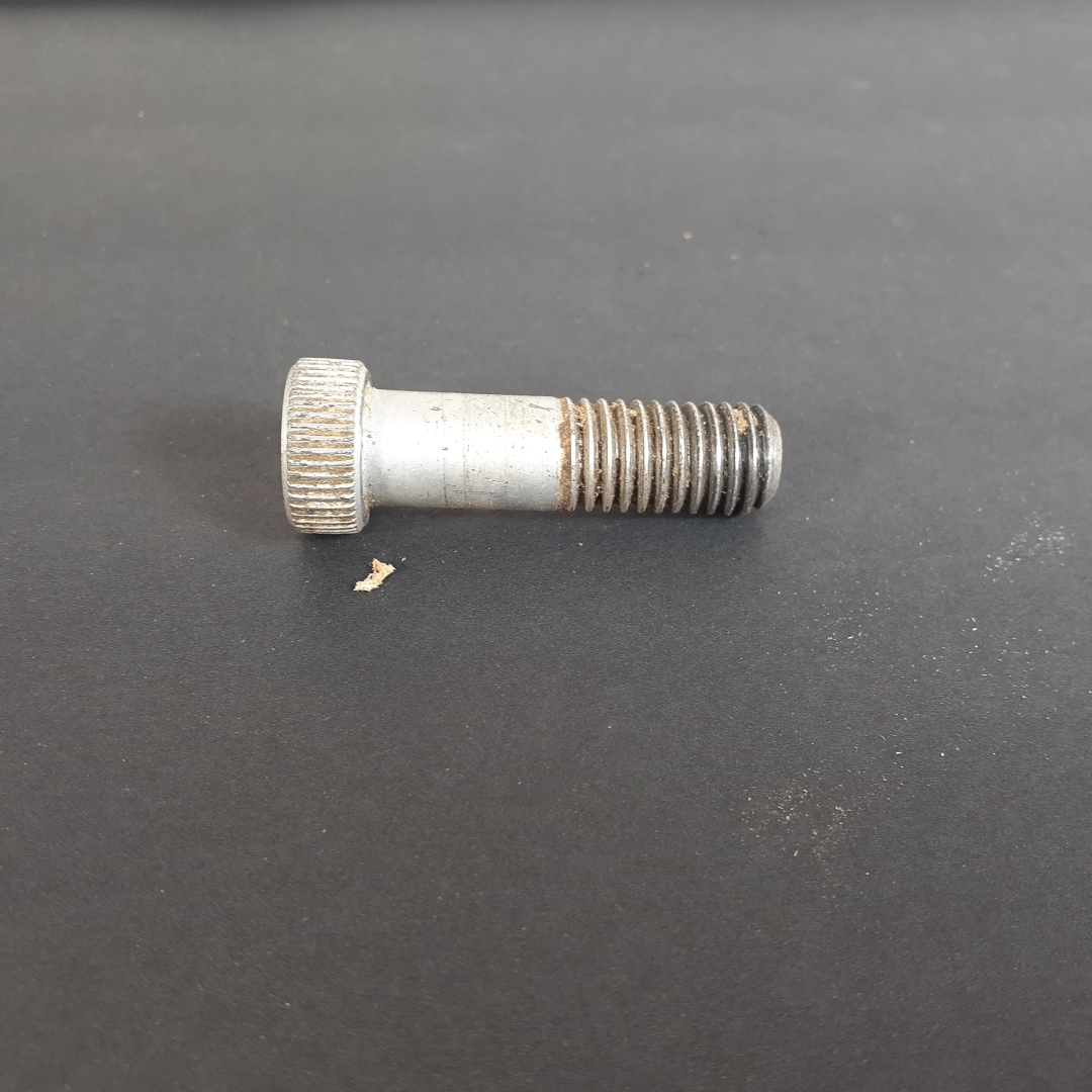

joebob80 wrote:
Parts question with photos - I tried looking for these, but didn't have any luck. SS product page is only useful if you know exactly what your looking for.
There won't be any 10E/ER specific parts on the SS product page, they were made three manufacturers ago.
The bolt that holds the tailstock to the pivot base is 1/2"-13 tpi x 1-3/4 low, socket head cap screw
Tailstock bolt1.jpg (961.89 KiB) Viewed 8206 times
Tailstock bolt2.jpg (593.13 KiB) Viewed 8206 times
Tailstock bolt3.jpg (633.44 KiB) Viewed 8206 times
Similar to the shoulder bolt for mounting the jig saw, but no shoulder.
Looking on line I am having trouble finding an exact match.
I did find this Door Striker bolt, which looks similar but longer.
https://shop.advanceautoparts.com/p/nee ... /5706602-P
or you could use a regular hex head bolt.
Note these were only used on the later tailstocks with the long bracket extension tables, the earlier ones with the shorter bracket used a had a knob similar to the one that holds the extension table to the tailstock, but shorter.

JPG – Yes, I’m missing the spring and detent. The manual has it listed as “Indicator Button”. Also, thanks for recommending the washers. This explains how the deep grooves got on the table where the miter gauge would slide. I took a look and from what I could tell, the pivot shoulder is recessed and doesn’t make contact with the miter bar. I’m thinking of trying a washer under both the clamp and pivot as long as it still stable on the table.
John – Thanks for the photos! This really helps. I originally thought I could use the spring and steel ball I took out of a spare miter gauge, but it’s the wrong diameter and doesn’t lock accurately on the angles. Guess I will use it as is for now. =(
Ron – Thanks for the photos and specs. I was thinking the bolt may have been used in later models is the reason I was looking on the product page. For now I will just get a hex head bolt.

Posts: 4233
Re: Craigslist find = New project 10ER
joebob80,
I am glad to see your restoration coming along. Sorry I have not been on here but today is the first time I have caught up on reading these posts since returning from vacation. Ron, John and JPG seem to have the help you needed well in hand.
For the Miter, the spring can be replaced by finding one that fits. Just not to soft of a spring and could be cut to length if a longer one is found. The pin is the difficult replacement. If anyone wanted to make some I'm sure they would sell. I would buy one for the extra Miter I have that is missing it. As has been suggested Miters come up for sale often but generally complete ones. There were only two Miter versions that came with the Model 10's. Yours is the second and most common one.
The Tailstock Bolt comes up for sale once in awhile. You can use, as suggested, a regular bolt plus a washer, in the mean time. You could try contacting ebay sellers that regularly sell Shopsmith parts to see if they have one. Do get the one shown in Ron's pictures which does not block the Extension Table from being lowered all the way down.
