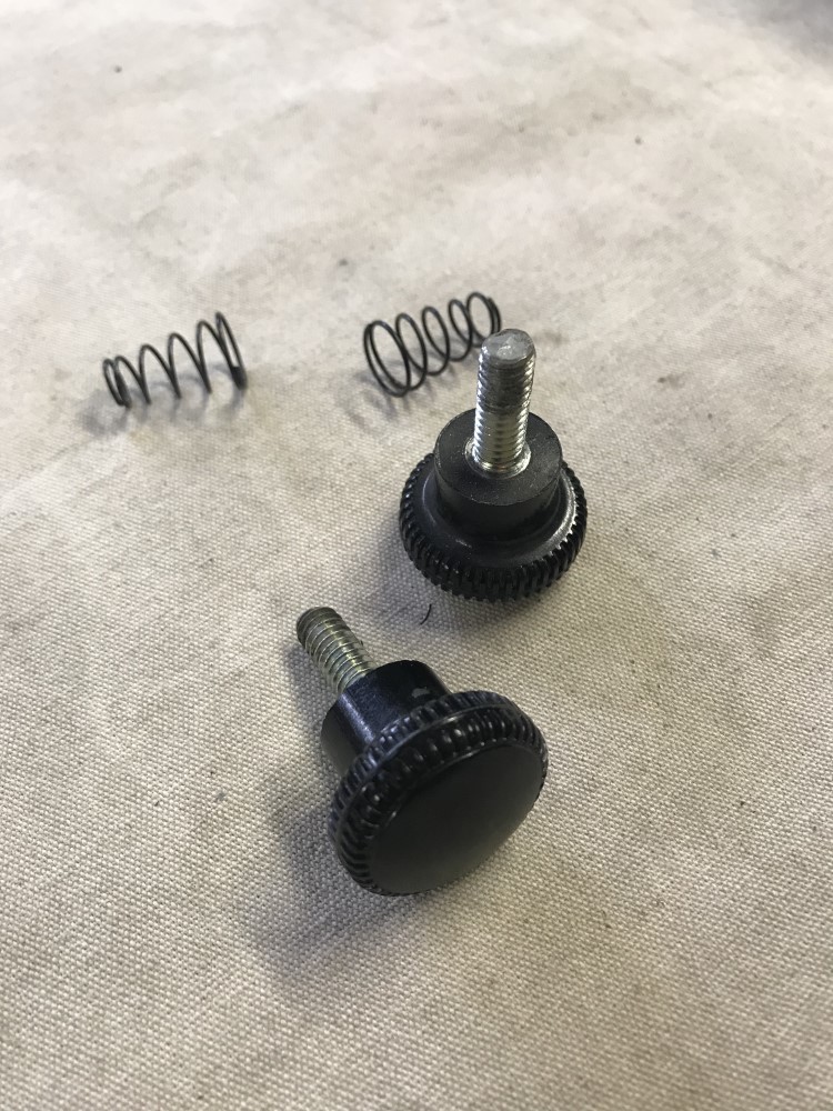

I just upgraded a 505/510 Main Table and Extension Table to 520/M7. Below is the knobs I received from SS. They are the same as most of the Knobs I have on 520/M7 Tables already. I couldn't find the right size locally, darn Covid19.
520-M7 knobs.jpg (197.61 KiB) Viewed 4170 times
Re: Table Tube Locking Knobs
chapmanruss wrote:Dusty,
Thank you, Russ. These are what I had seen. I can probably find these in the SS online catalog BUT would you please provide me with the part number. I don't want to order new ones only to get more of what I have.
Posts: 4534
Dusty,
They are P/N 515859 Knob with Stud and are the minimum SS price of $4.95. The springs are P/N 518462 Spring for Tables M7, 520 and $4.95 if you need them also. I could not find anything close to replace the those springs locally here either.

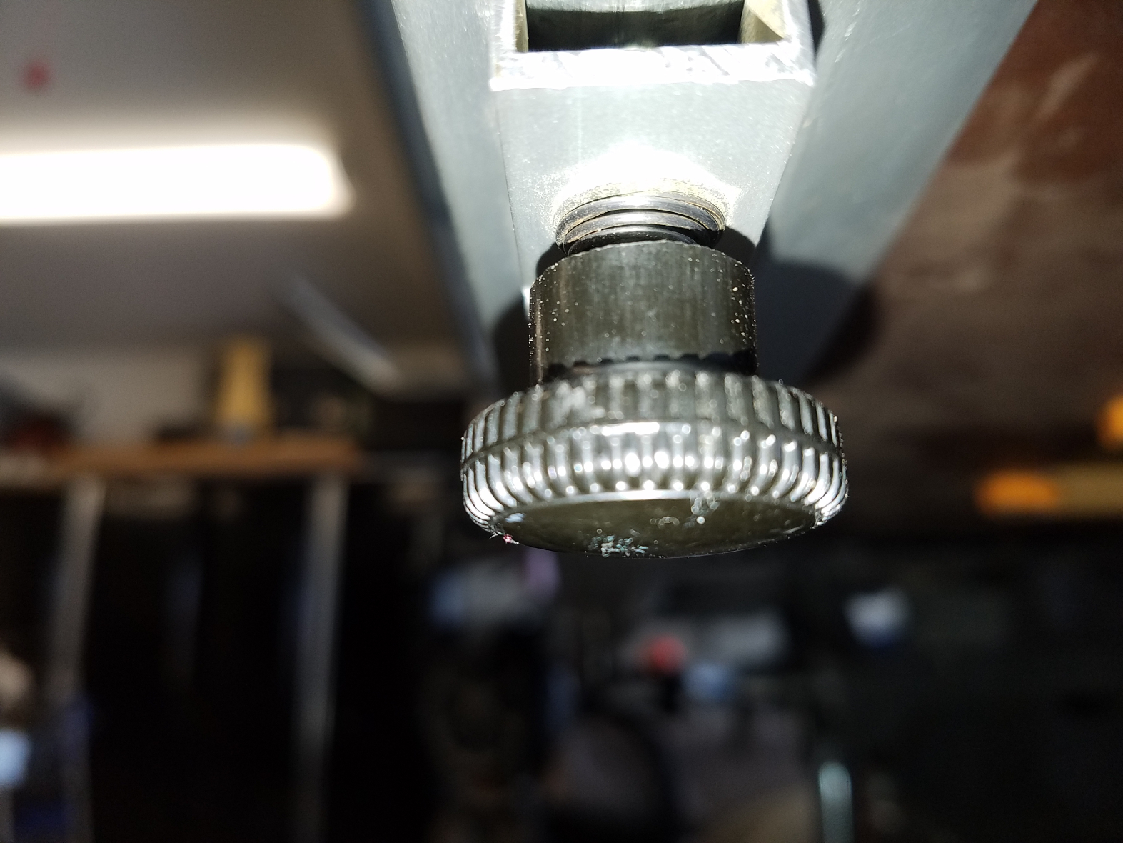

I should have added a picture of the other knobs I have on my 520 tables but I didn't even look at them yesterday when I took the previous picture. Below is a picture of the plastic knobs that came on my November 2001 Mark V 520. It is a full set on the Main, Extension and 2 Floating Tables.
520-M7 Knobs 2.jpg (220.77 KiB) Viewed 4100 times
They look the same as the one in the picture you posted although I cannot tell for sure what that knob material is. The knob part on mine are black plastic, like the current ones.

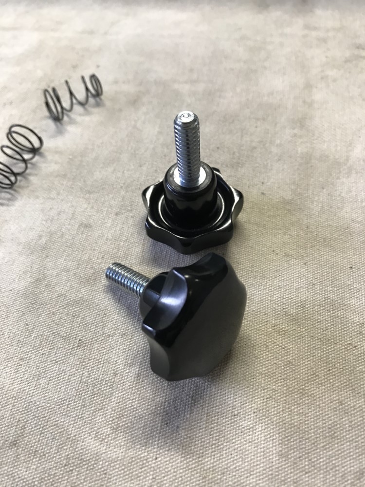

I broke one of my nice rounded knobs and order a replacement and spare from Shopsmith. They sent the newer star knobs.
For me this new knob is a pain to use. Yes a real pain. Arthritis in my thumbs bothers when I use it. I swapped it to a less used extension table so I could have the "nicer" knobs on the main table.
I have not found a replacement but then I haven't spent the time but I wish I had all of the older style. If I ever do find one I get a half dozen so I will have replacements for the rest of my life, the kids, well they will be on their own....
