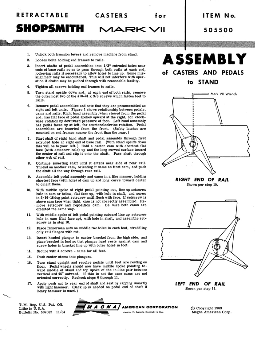

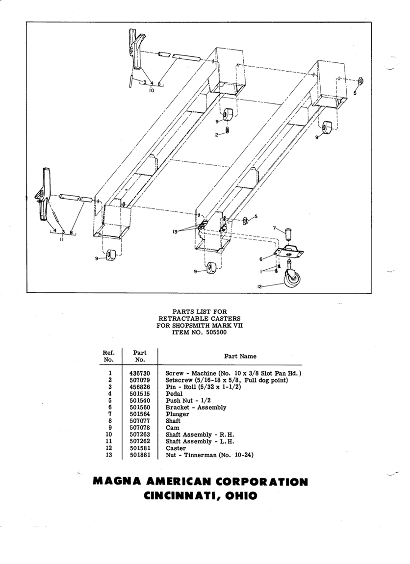

Below are page scans of the Magna Mark VII caster assembly supplement. I suspect someone got something wrong here.
When I first got my Mark VII I wondered about the caster pedals. It seemed like they didn't work anywhere near as well as those on my Mark 5.
This manual supplement came with my machine, and the illustration on the first page matched my setup. Then I noticed that in catalog photos, the pedals faced the opposite way.
I bought a parts VII and found the pedals mounted backward as well.
I suspect this manual is the cause of the confusion, both with the illustration on page 1 and the hard-to-read orthographic on page 2 — unless someone can tell me why they're actually supposed to work this way.

There is no inconsistency between the two pages. The first page shows it upside down.
StevenAyres
Posts: 84
Joined: Sun Apr 21, 2019 11:21 am
Location: Prescott AZ
Re: Mark VII caster assembly manual
Post by StevenAyres »
Good eye! I missed the position of the foot.
