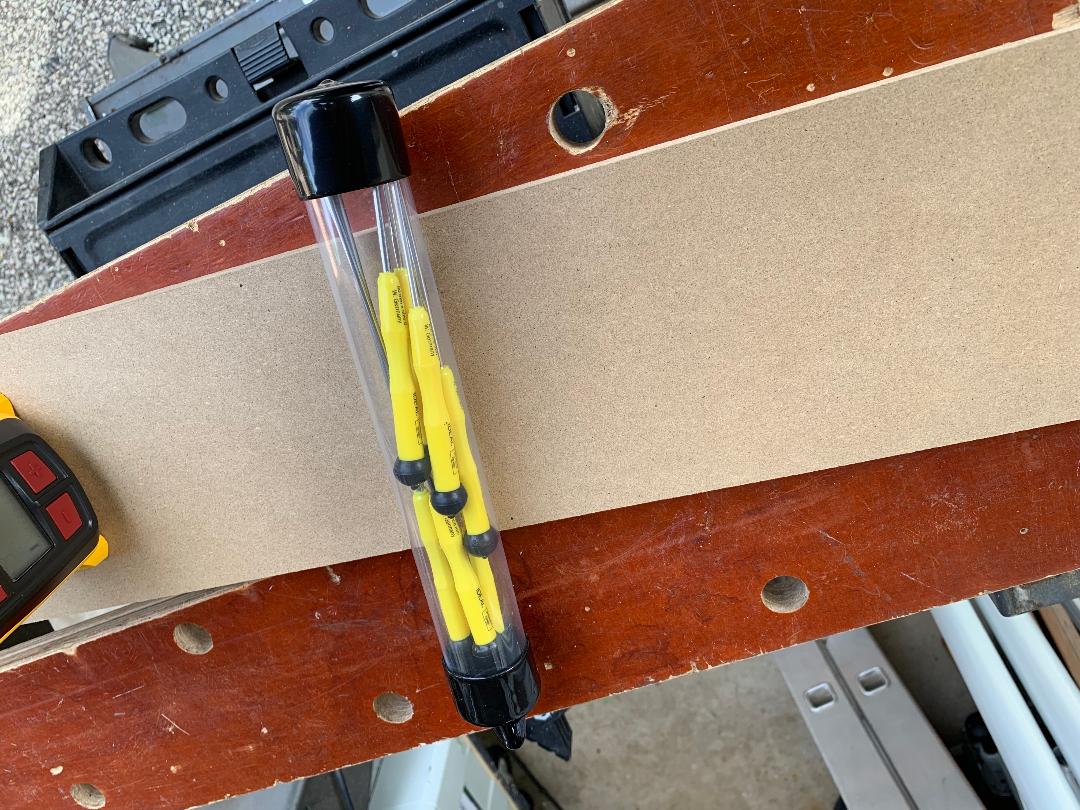

Take two on the project.
I went back to wrapping tape on the cut line and then used the miter saw to make the cut. Saw on high speed and lock so it was not able to slide. This was pretty much what I had done before. I first used the slowest saw speed thinking that would be better but it wasn't. Critical is the letting the saw stop before raising.
Next I got out my heat gun. At first try I thought it was discoloring the plastic but as it cool that went away. I also go some sag on my first try, you have to keep it rotating like when you blow glass.... Had it set at 600 degrees which is more then it needed I think but it worked. The edge is still not polished but much better then before. I'd say it good enough.
So you buy the Rockler track for about $9 and get a free viewtainer abet small diameter but adjustable length for almost free.
And yes I have some pictures to share but that will have to be a bit later.
Re: Looking for advice on cutting thin plastic tubes
Pictures of the tube ends didn't really work out but I did have a few others that I can share.
Yea all this fuss for such a small thing. Well I do have more tubes and more things that can be put in them so this will be an on going adventure.
