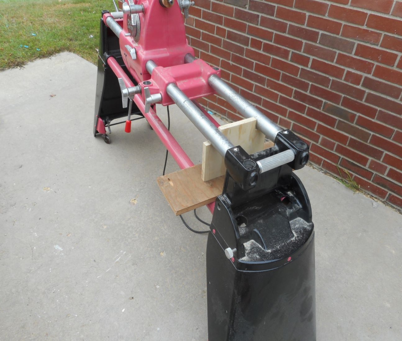

Pull the pivot pin. 2 people to load.
A simple jig to support the way tubes and realign.

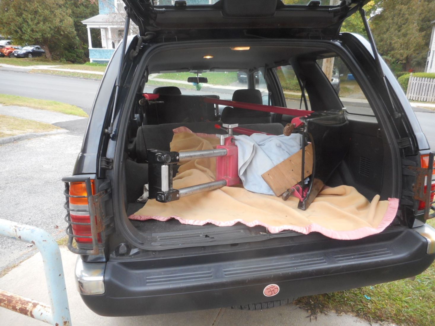

"Maxine" heading home yesterday. There were a LOT more blankets added than pictured
