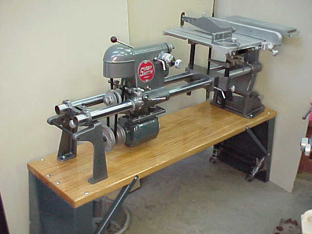

I can't see a major problem with lowering your Shopsmith, Thom. An issue you might run into is if you use the table saw operation. If you need to tilt the table for a angled crosscut or compound miter cut. You will be limited to the length of your work piece from hitting the floor with the opposite end of the board from the end in which want to make to cut on. This is an issue with any Shopsmith, but more so if your Mark V is at less than standard height.
The same would apply when tilting the table on a Shopsmith bandsaw, and possibly if you had an odd operation when using the drill press or horizontal boring with the table tilted. Aside from all of that; If you plan on using your Mark V primarily for lathe turning, then it wouldn't be a problem at all. Turning is my passion (and my day job).
There would not be any problem with physically tilting the Mark V into drill press position with shorter legs on your machine. It would be no different than a Shopsmith 10E or 10ER (if you are familiar with those models) that has a custom base under the machine.
I say go for it!
10ER with factory legs:
10ER with custom base in drill press mode:
