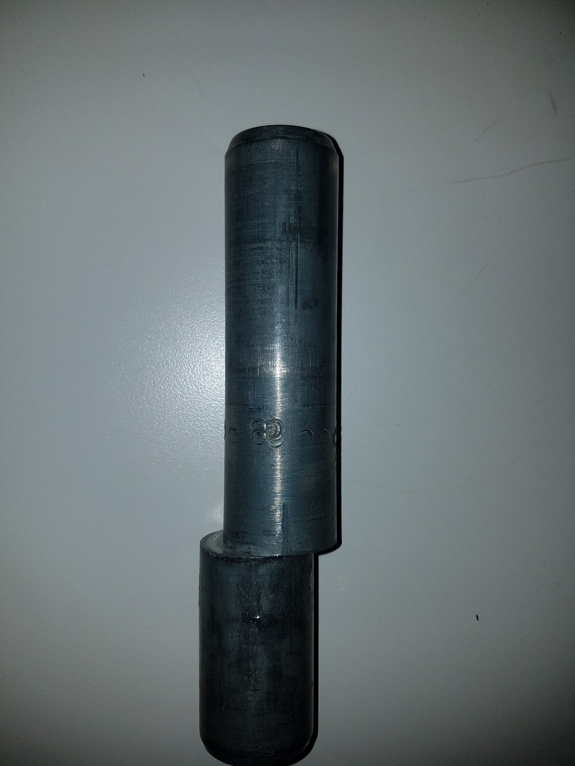

Re: Jointer Slipping down and breaking coupler
This is an eccentric tube from my bandsaw. The one used in my jointer is similar but shorter. I think both sides are the length of the short side in this photo.The jointer is also heavier so I decided to remove the bandsaw eccentric for the photo shut.
No straight tube and no snap ring. The offset measures 1/4". This establishes the limit on how far the drive shaft could be moved (in the lacteral direction).
Shopsmith Bandfsaw Eccentric

Yup, it does get confusing some times. Partially because many of us do not read the entire discussion before throwing in our 2-cents worth. I posted the picture of the eccentric because the discussion on straight spt tubes with snal rings was confusing.

Dusty,
Your eccentric mounting tube drawing is a great example of guiding the OP to solve his problem. I always like the fine job you do with your drawings in cases like this. Although we did turn this into a discussion about eccentric and straight mounting tubes I think overall it is helpful to all in deciding if the correct mounting tube is being used. In some cases either mounting tube will work. In the OP's case the eccentric tubes will help.
