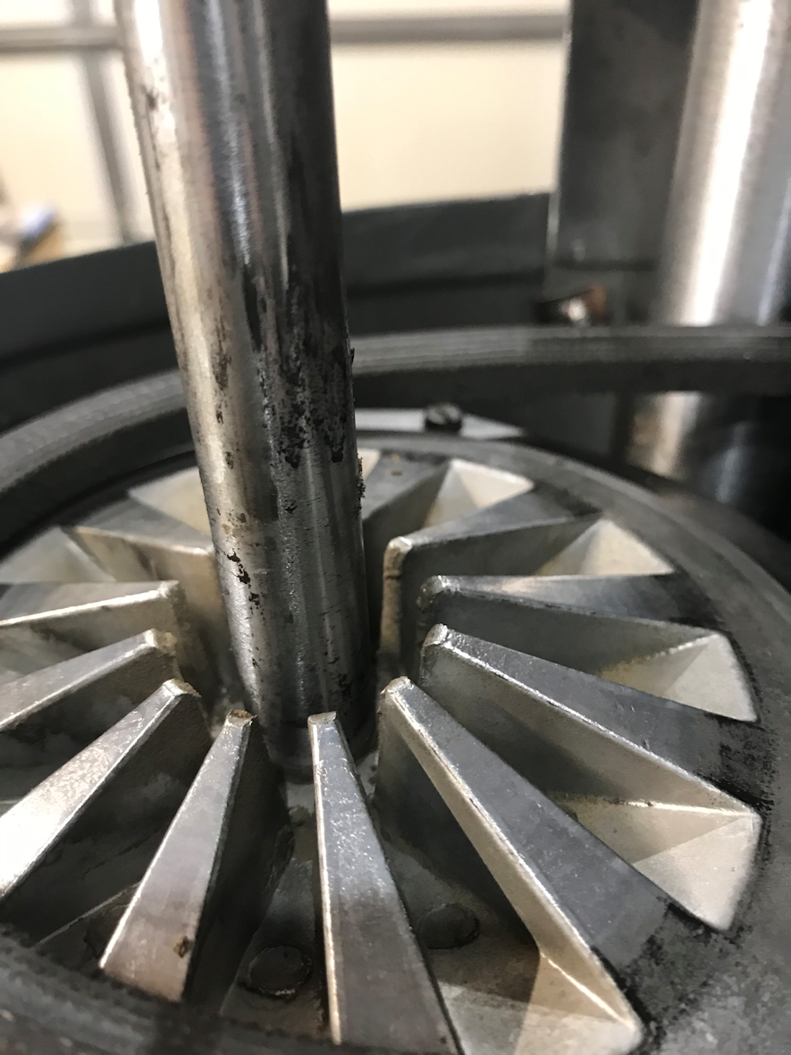

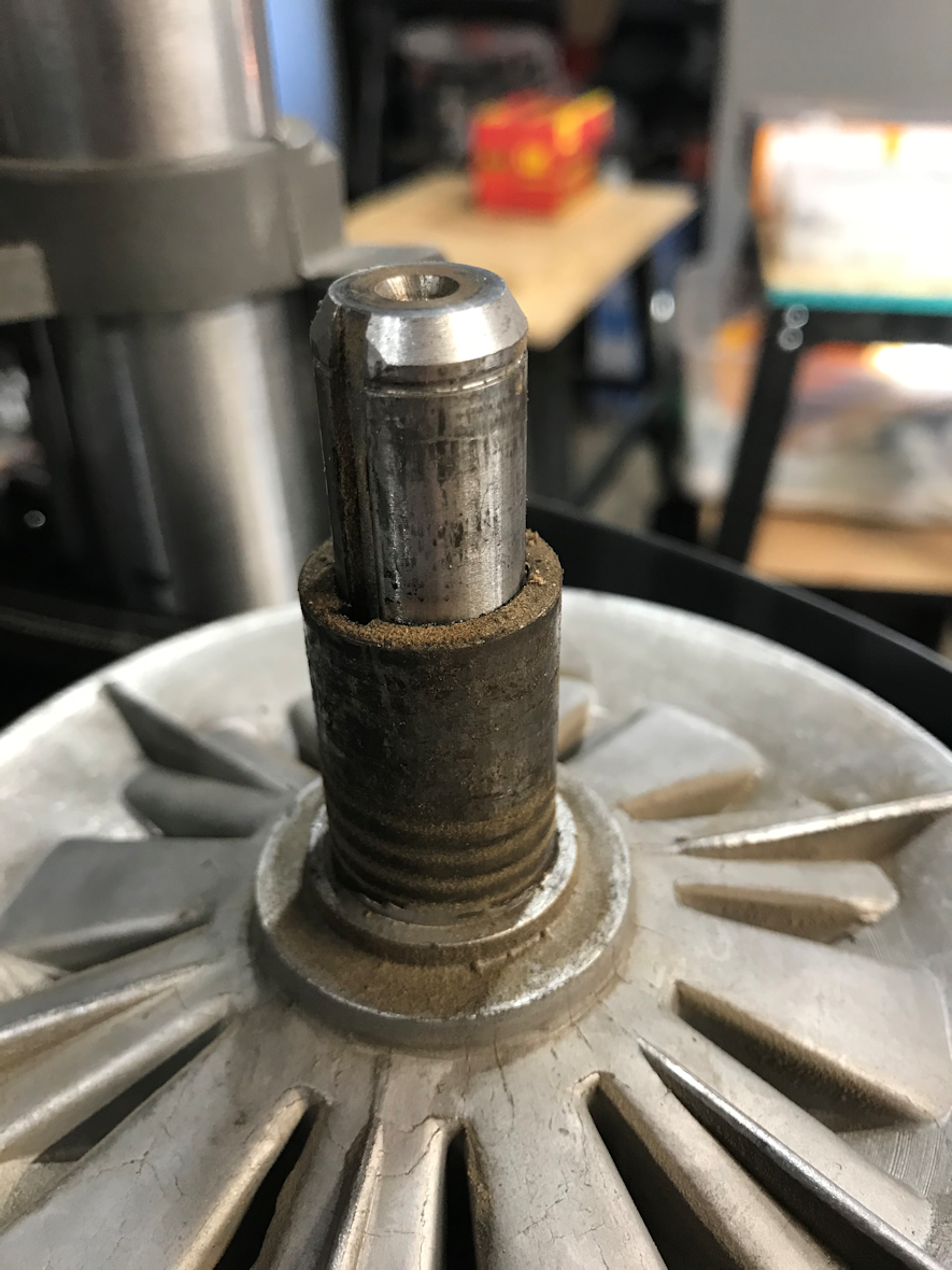

Well here's my theory... It's a 1991. The previous owner used it lightly. So much so I doubt in the 30 years he owned he never ever oiled it. Over time belt residue was able to get between the sheave and the safe but all was dry. Might have even worked as its own lubricant. Anyway I come along and add oil which basically turned it into a black tar like substance that gummed it all up. When I did get them apart thats what I had found. A black tarish sticky substance inside the sheave and on the shaft. Hit it with carb cleaner and it came right off. So that's my theory.

It sounds like you're making good progress. I'd be careful with the cleaner around bearings, especially if it is a spray. SS uses a combination (not necessarily predictable) of sealed and shielded bearings throughout. Keep in mind that the sheaves on the motor shaft serve a similar function to those on the Idler. Whatever you found on the Idler is almost certainly present there as well. The forced air cooling of the headstock also brings in dust, sawdust, etc. from the surrounding air whenever the motor is running.

YOU AIN'T A KIDDING SPRING!!!! Good god. That is a bitch. I'm going to need a second set of hands to get it back on... But... sure enough... that sheave was gumming up too and by the time I started taking it off it was tough.

For reassembly a short board that slips under the headstock 'ribs?" having a hole that will slip over the washer/cup and allow the grooved shaft to protrude so as to facilitate replacing the retaining ring(the hole must be larger than the ring.
P.S. You will be amazed how easily the floating sheave slides when the shaft is oiled.
