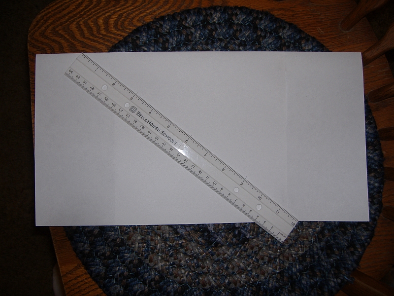

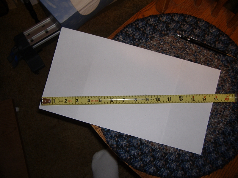

WHERE to drill the holes?
Hi guys,
Remember back to your shop class in HS?
I think these might refresh your memories.
[ATTACH]2987[/ATTACH]
[ATTACH]2988[/ATTACH]
For the three across use the scale at 12" edge to edge, then mark at 3", 6" and 9".
For the 4 the other way use the scale at 15" and mark at 3", 6", 9" and 12".
BINGO!
Sometimes there is a time for math and sometime use one of those tricks from your youth.
BINGO!
- three across.jpg (364.4 KiB) Viewed 5992 times
- by 4 the other way.jpg (358.6 KiB) Viewed 5989 times

That is a pretty cool trick, Ed! My shop teachers never gave me that one. We always had to do the math.reible wrote:Hi guys,
BINGO!
Tim
Shop Trick
Tim Too bad it won't work for gutters!!:rolleyes:a1gutterman wrote:That is a pretty cool trick, Ed! My shop teachers never gave me that one. We always had to do the math.
