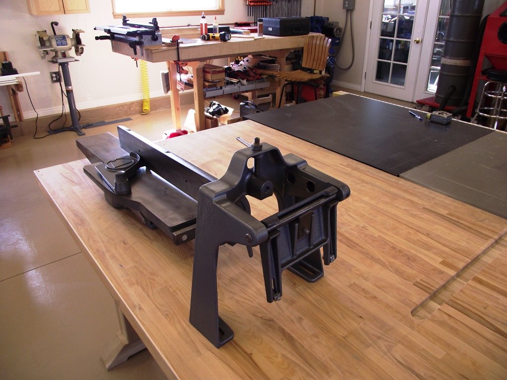

It doesn't look like to me like the B adapter is in the box. It is the A adapter on the machine. That is the correct one for the jointer. The adapter is to be able to use MK 5 SPT's with the Model 10. So the pictured configuration is correct. The jointer shown is a Model 620. That is the jointer with mounting tubes for the MK 5. The original Model 10 jointer was the 4E. It mounted on a special head rest and did not have the MK 5 mounting tubes. It was driven with a belt directly from the motor. This machine has the large motor pulley adapter for the 4E jointer but not the special headrest.
The band saw requires the B adapter. Individual adapters or the complete kit are VERY rare.

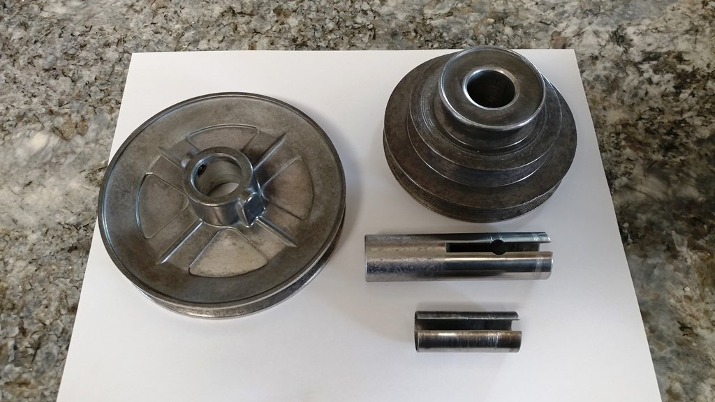

The first picture shows the 4E jointer and the special head rest to mount it. The second picture is the large pulley and shaft adapter to drive the jointer directly from the motor. The Craig's list has that pulley for some reason. That pulley adapter kit is also VERY rare.

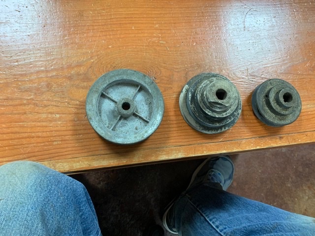

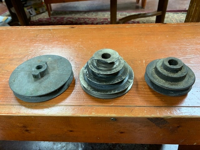

Another question. Here are some miscellaneous pulleys that came with my 10ER. I’ve never been sure whether they are shop smith or unrelated. See anything that would be useful or that looks familiar or important?
