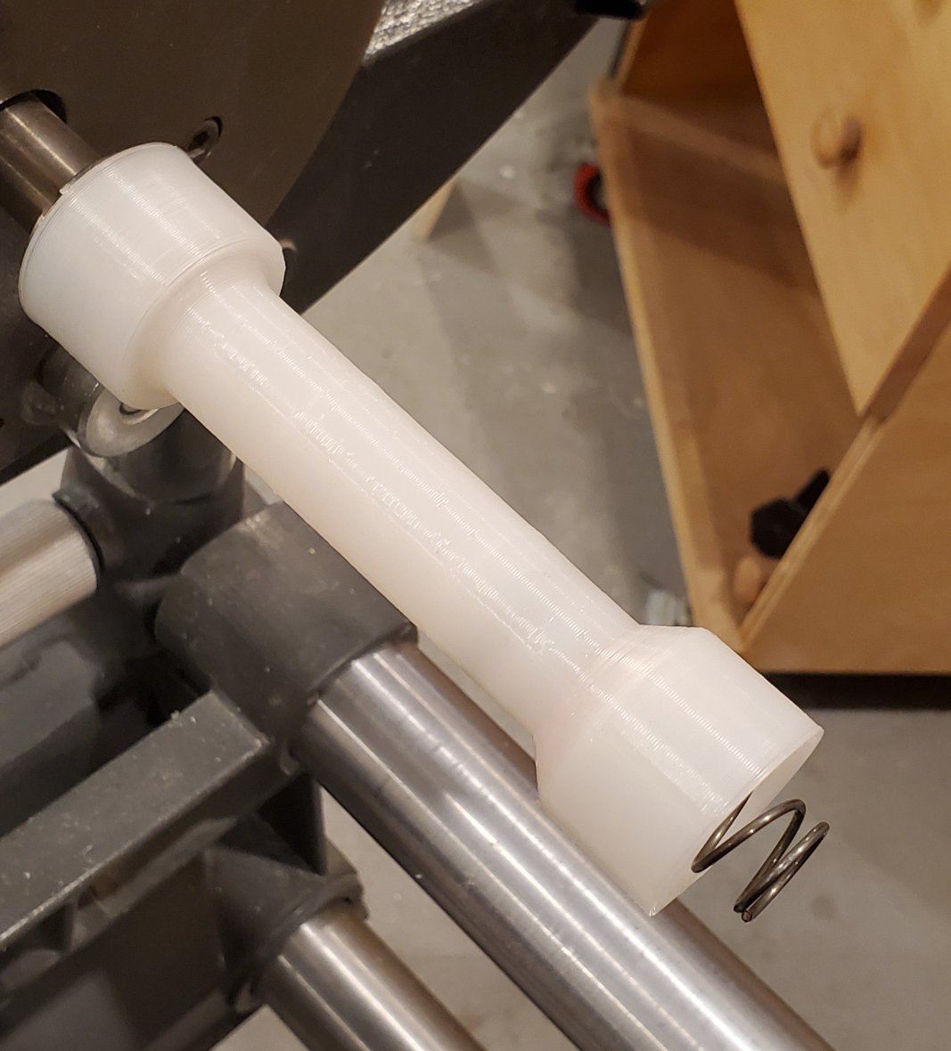

So, let me lead with a disclaimer:
Like several other people here, I have had issues with the current white coupler. I had one get hot and distort while using my bandsaw, and a second is going bad because the engagement keys have premature wear. So I decided to save a few bucks and make a coupler. And hurray, it works! If it breaks, I can have another printed within two hours.
I posted it here.
Then a few of you voiced similar concerns regarding the "new" white coupler and inquired of mine. But making a coupler that works, and making one that I would feel justified selling are two completely different ballparks. Mind you, I enjoy this kind of endeavor, and playing with various 3D printing techniques and materials is my kind of fun. If this ends up being something of worth for the rest of you, that is icing on the cake.
So that leads me to a thought experiment about what constitutes a good coupler:
1) It needs to join two tools with a firm fit
2) It needs to be able to withstand the radial torque needed to drive the tool
3) It needs to be able to accomodate slight lateral mismatches in alignment
4) It needs to withstand additional lateral forces such as when being "wiggled off"
5) It should withstand the wear and tear of regular use and still firmly mate tools
6) It should be able to withstand the expected temperature extremes of the work environment
7) Per many, it should be strong, but not too strong, and act like a mechanical fuse in case of malfunction
And based completely on personal preference: I want my coupler to be visually "similar" to the 1950's original. Printing a 1.25" tube would be easier than the classic shape. But again: The challenges are my kinda fun.
I *think* I'm heading down a path that can satisfy the above list. No promises other than that I'll keep you posted.

To those who are getting the first batch of couplers:
You should have gotten a PM from me.
Using a Shopsmith spring on the headstock end will make removal of the coupler much easier. The coupler is intentionally a bit snug when new. After a couple uses the slight "ribbed" texture to the 3d printed part that should smooth out on the mating surfaces.
BTW: I prefer my couplers to have a snugger fit than the white couplers I've purchased over the last few years. The fit is closer to my old-school nylon coupler.
