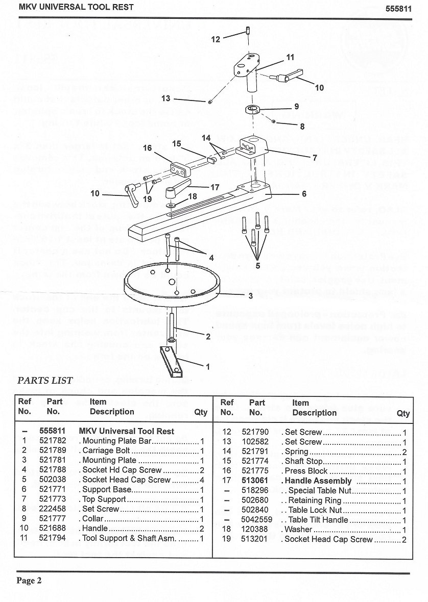

Yeah, I don't fully understand what you intend to do with it. I get that you want to have a 2nd carriage with the UTR on top sitting next to a primary carriage with table installed in it. Do you intend to use the UTR for lathe turning, but want the option of leaving the UTR "Mounting Plate" in place to sit under a plunge router kind of setup when not woodturning? Perhaps the exploded parts diagram below will help. As you can see there are just two bolts (item #4) to secure the UTR "mounting plate" to the carriage and the UTR "Support Base" easily removes with a Handle Assembly (Item #17). However, there will still be a carriage bolt (item #2) left in place that could be in the way of the router. IF you change the mounting setup away from that carriage bolt you may be able to figure out a different way to hold the Support Base that when removed leaves a flat surface on the Mounting Plate.

JimiDuke wrote: Tue Apr 06, 2021 3:25 pm I was hoping all I'd have to remove was the UTR support arm when using the router table and have the circular base plate press up agains the router but as was pointed out it doesn't look like it will work because the bolt that fastens the arm to the base will remain in the way.
That carriage bolt is easily removable, but you do have to take the Mounting Plate off the carriage to do so. I am sure you can come up with an alternative though, e.g. figure out a way to make a captive nut to put under the Mounting Plate (where the carriage bolt goes through). If you do this you could easily thread in/out a bolt from up top to attach the Support Base, so that when removed you have a flat surface for the router. Another option is to drill through the carriage, if you don't mind doing so. Then a longer carriage bolt could be inserted through carriage and Mounting Plate, which would be easy to remove to achieve the same effect.
