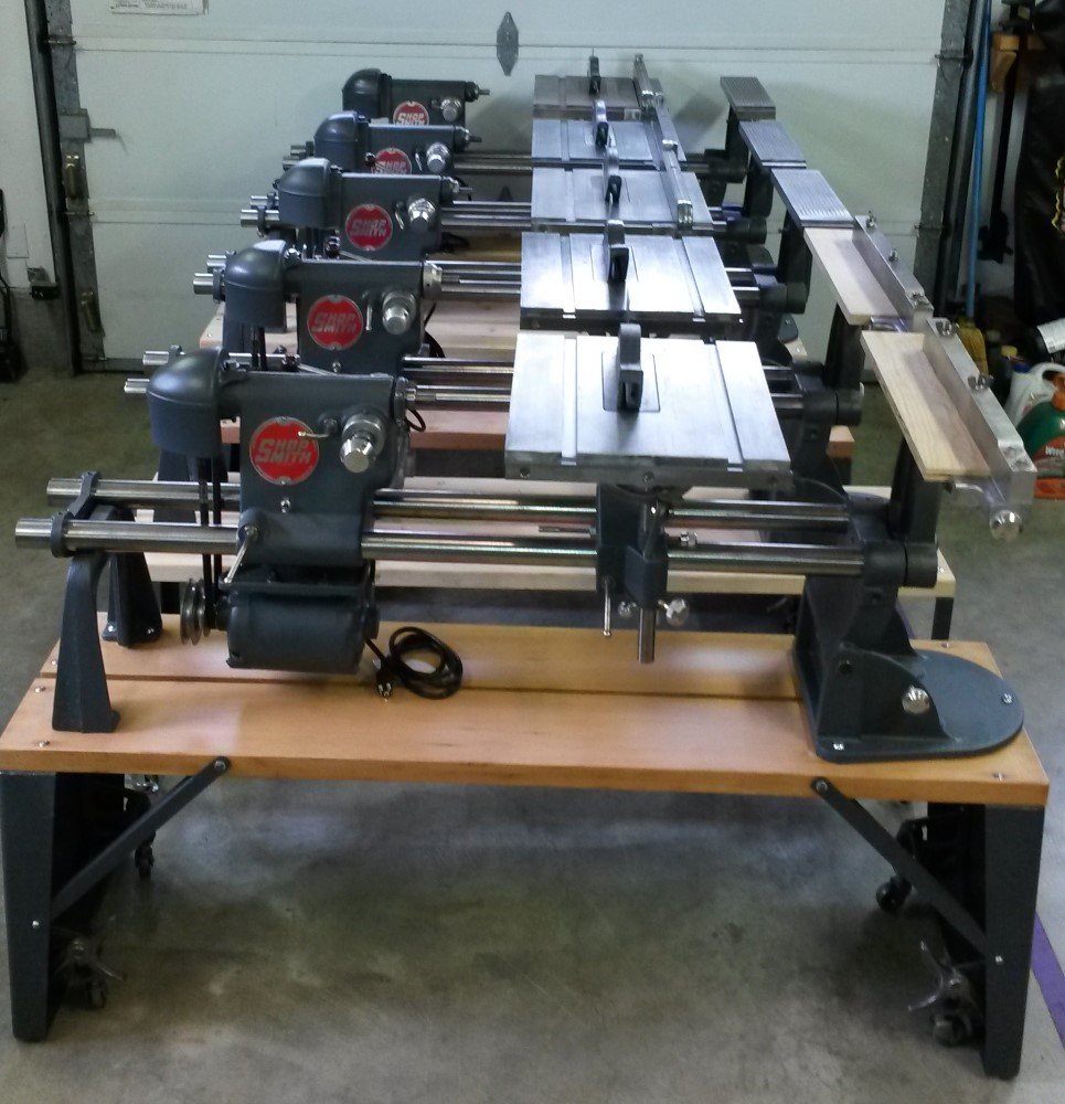

As for the paint I have seen store shelves get bare at times in the spray paint section over the last year. Covid reducing production may be one reason and graffiti may have been another. We have seen a bigger problem with that in this area over last year too. If you have gotten the bug on restoring Shopsmith Model 10's you might consider ordering a case of 6 and have them on hand. That way you can get your current project done. Remember restoring Shopsmiths can be habit forming.
4708-8865-55582-R57376-R64000 full.jpg (154.69 KiB) Viewed 1000 times
_
These are five I had restored but not sold yet I had at the same time. The one in the back is my original restoration and I have kept it.
All SPT's & 2 Power Stations
My goodness, those are beautiful!!
