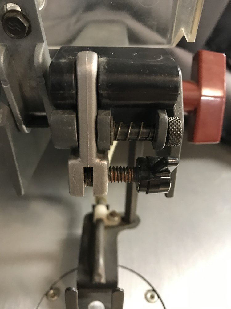

In the picture below the upper quick release Blade Block upgrade is shown on my Model 555220 Scroll Saw. The spring pin goes through an elongated hole on the upper block which allows for the cam action. The lower block (not shown) does not have an elongated hole or the cam as shown in the picture of my previous post. Neither block has a set screw or any hole on the left side where the blade mounts, only the threaded hole on the right for the thumb lever lock screw. The lock screw presses the blade against the opposite side of the opening for the blade to hold it in place.
Scroll Saw Blade Block on 555220.jpg (79.57 KiB) Viewed 842 times
