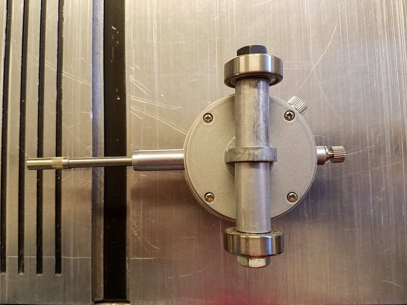

I have been doing this in this manner for a long time but I want to go on record saying that the SuperBar(s) make it an awful lot easier and more accurate. I don't have to hold the dial indicator tight in the miter track re: Nick in the video.
Re: Table Line Up
My dial indicators prior to the SuperBar but no more. They worked but not without frustration. Much like the Shopsmith version. The same could also .be done using a caliper and the MAG-DRO.

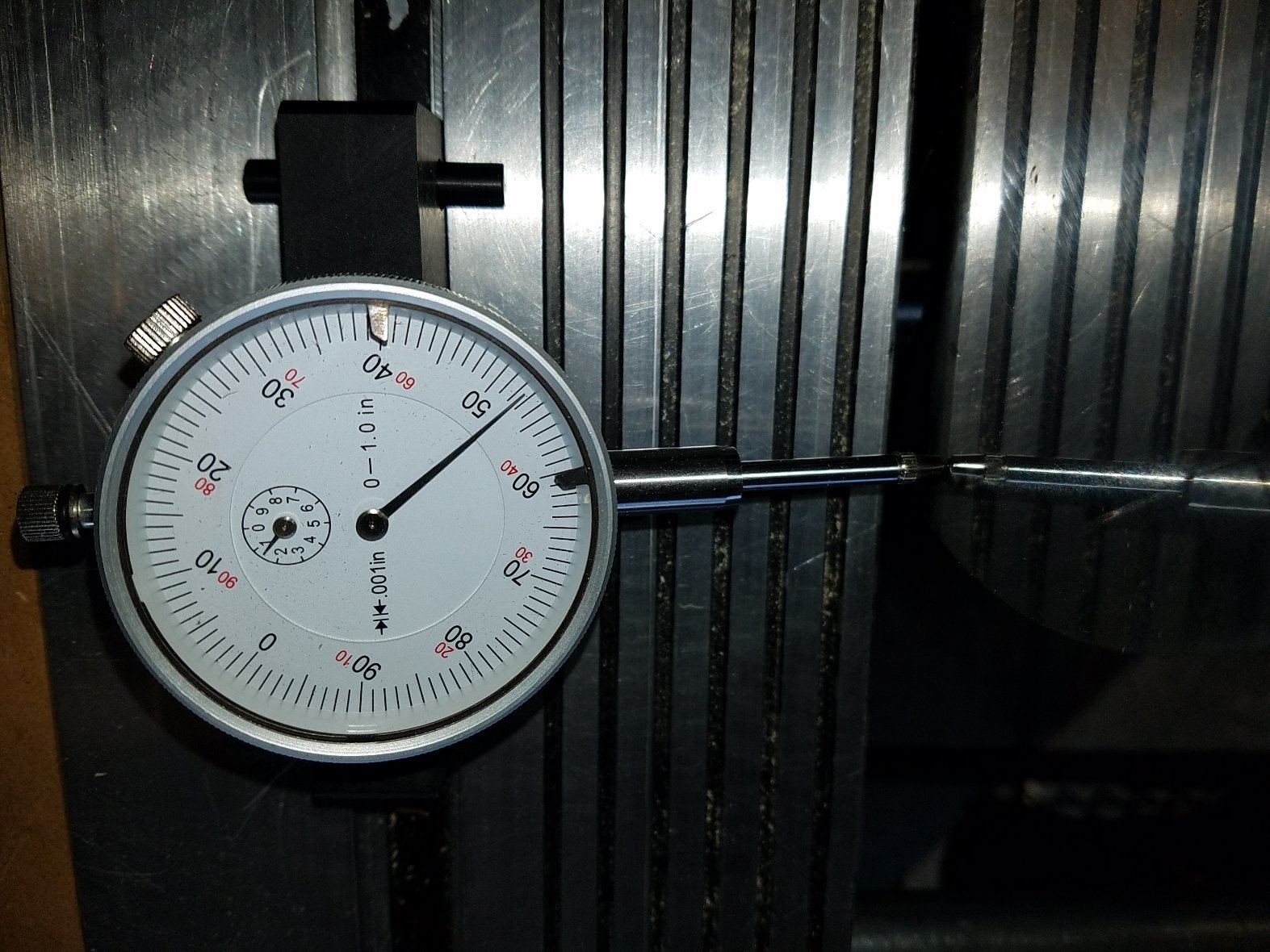

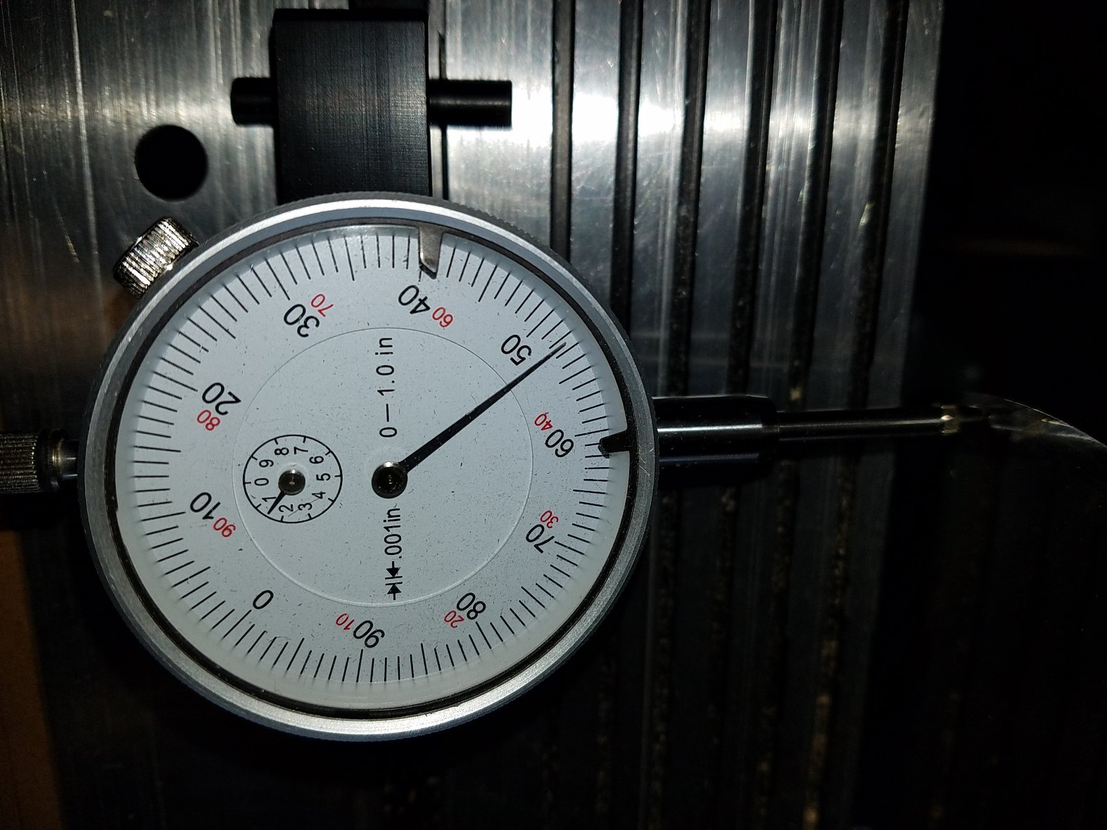

I set out this morning to go through my alignment procedure, using two dial indicators, and document each significant step. I got stopped in my tracks.
I first loosened all four trunnion bolts (finger tight). I then slid the tubes into the rails for rough front to back alignment. I have to remove the tubes before I mount the adjustable stop collar - physical interferece. I then slid the main table to the left against the trunnion bolts. After setting the stop collars in place and mounting the SuperBars with dial indicators, I took a couple readings.
Surprised by the readings, I did it all again.
What now? Secure the trunnion bolts and call it quits????
SuperBars positioned for table alignment
Infeed side of alignment pate
Outfeed side of alignment plate
I have not buttoned it up but I can not improve on this.
I would be very interested in feedback from a couple of users who have repeated this process - taking the readings after doing nothing more than pushing the main table hard right against the trunnion bolts.

I have no basis for argument! The only weakness that I see in your approach is the users ability to "adjust the table so that it sits straight". How straight is straight enough???
I have a piece of MDF that is outfitted with a "perfectly sized" piece of hardwood to function as a miter bar. I passed that across a saw table that I felt was properly aligned and often use that as a check for alignment. It can be used in exactly the same manner as you say you use the table insert.
Same for aligning the rip fence.
Still...the only question is how parallel is parallel enough? .001", .005" or .0156"?
After completing a setup as you describe, have you made any measurements? Just curious.
Your methods are much less expensive, too. I have $200+ invested in the toys I have pictured in this thread.

I am far from being an alignment expert or even a Shopsmith expert for that matter, but I think I see a potential problem with the method you showed using two dial indicators. IF I am understanding correctly you are taking two absolute measurements, one at the front of the disc and one at the rear of the disc using two Superbars. So, what happens if there is a small difference between these Superbars, e.g. the stem on one dial indicator is slightly longer or mounted off center in the Superbar, etc., etc.? I thought it was more important to take the relative (difference) measurement, i.e. using only one Superbar to measure in both places. I do think you might be introducing an additional source of error into the alignment by using two Superbars in this manner. It might be possible that you show identical numbers on both dial indicators indicating you have alignment when in reality one could be off by a few thou to the other one resulting in the potential for kickback.
In your previous pic you showed two Superbars both showing the same reading on the dial indicator, but does this mean the miter slot is parallel to the sawblade IF there is any discrepancy between the two Superbars?
📶RF Guy
Re: Table Line Up
A simple way to verify. Reverse locations of the supebar/indicator. Then remove and again reverse(allows seeing effects of 'resetting').
Re: Table Line Up
RFGuy wrote: Mon May 03, 2021 11:54 am Dusty,
Yes, I do believe that two identical readings can be considered as two equal distance readings - meaning parallelism. As a requisite to this procedure the two dial indicators were zeroed independently at the same point. I choose the end of the drive shaft that you see in some of the photos.
I have also satisfied myself that the dial indicator readings are reliable by swap them back and forth as JPG suggested.
Because this is something of "a game" for me, I have also done these checks using my other dial indicators (the home brew) and the MAG-DRO with a digital caliper. Believe me, the readings are accurate.
What the SuperBar brings to this procedure is a dial indicator that is reliably seated in the miter track with no deviation caused by slop in the miter track.
I am not striving for greater accuracy. I am looking for ease of alignment and repeatability. Miter track slop makes both of those doubtful.
I appreciate the feedback.

dusty wrote: Mon May 03, 2021 1:09 pm Yes, I do believe that two identical readings can be considered as two equal distance readings - meaning parallelism. As a requisite to this procedure the two dial indicators were zeroed independently at the same point. I choose the end of the drive shaft that you see in some of the photos.
Thanks Dusty. Yeah, as long as you are swapping them to compare then I expect it should be okay. I just didn't know if there is any ariation between Superbar 1 and Superbar 2 that had to be accounted for with your procedure.
