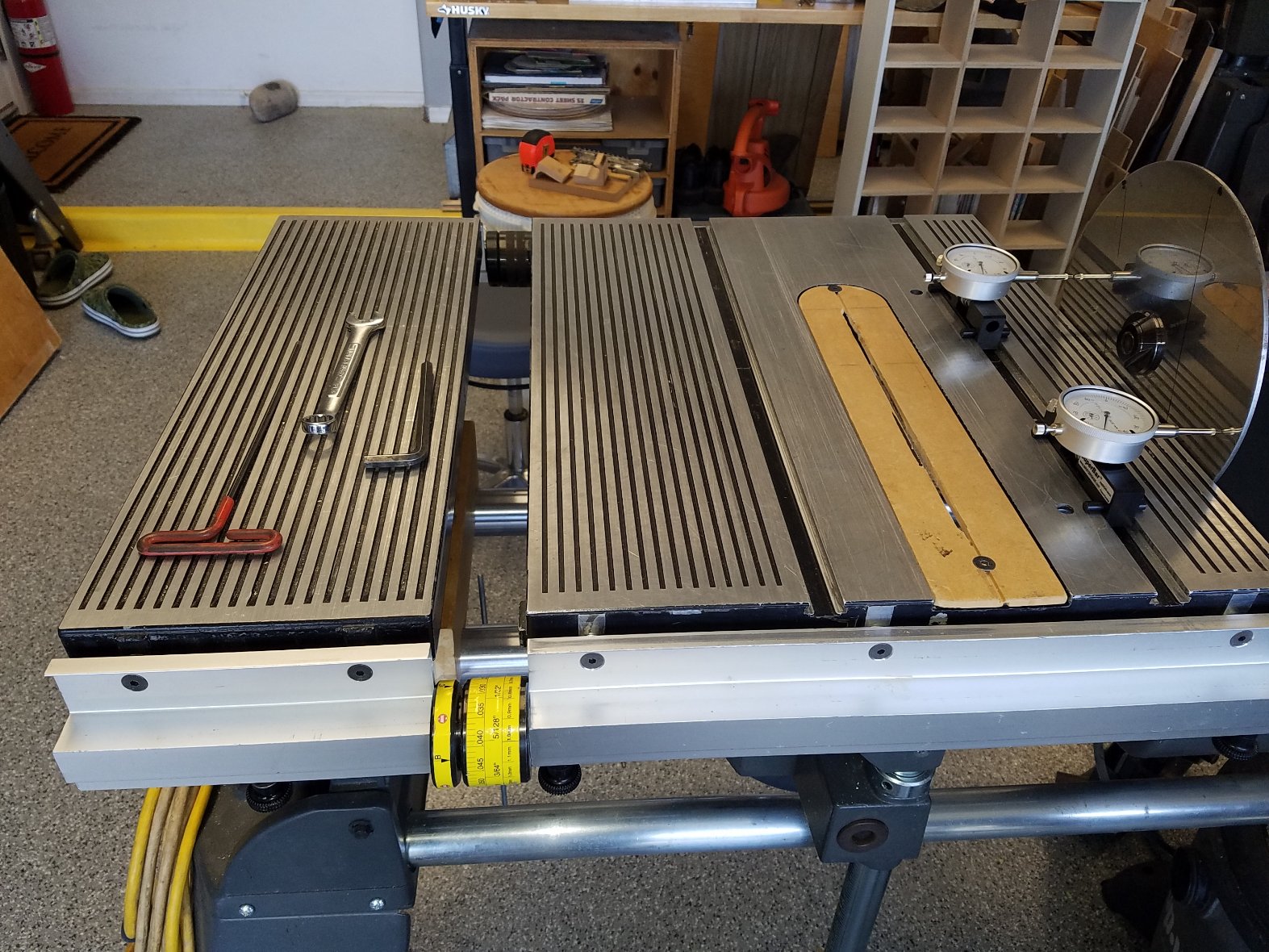

[attachment=0]20210508_073806.jpg[/attachment
Some times I just don't think. Why was I using main table legs for this setup. No clamping necessary. Just install the adjustable stop collars as shown and go for the alignment. It works great and especially so with two SuperBars. Tweak the stop collars as required to push the table toward the reference plate and tighten the trunnion bolts. After I got the table positioned, I used the quill to push the main table toward the stop collars. This reduces the tendency for the main to shift while securing the trunion bolts.
There has been discussion about some sort of real time pressure to move the main table tight against the stop collars throughout the procedure. This might be advisable if one had to search for the proper setting. I find that no search is required. Just adjust the stop collars slowly pushing first on that side of the table that is too far from the reference plate. Maybe tweak and maybe not.
I know some will say a waste of time and effort. I am pleased and will continue using this method "for table alignment".
Periodic verification of parallelism can be achieved in many other ways.

I tried your stop collar adjustment approach today. I only have one indicator, so I just marked a spot, flipped the disk 180-ish, and moved the indicator over to get measurements from both sides.
It worked brilliantly.
Thank you so much!
