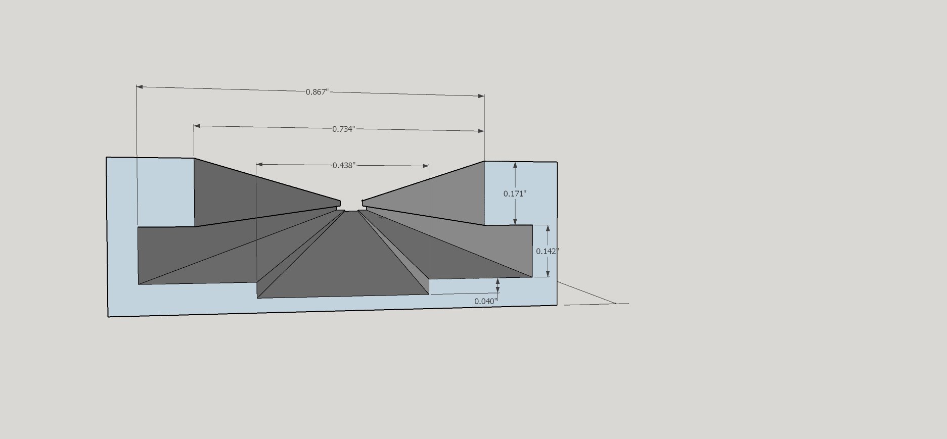

This came up in the YouTube comments, and I didn't have an answer...
What are the width and depth dimensions of the Shopsmith miter gauge slot? (In thousandths, if anyone can).

JEFFinCLE wrote: Tue Jun 15, 2021 6:48 pm This came up in the YouTube comments, and I didn't have an answer...
Jeff,
I believe the consensus is that Shopsmith miter slots are 23/32" wide and 21/64" deep. Keep in mind there are multiple product versions over 70+ years so there is some variability in these miter slots from one customer to the next. I don't believe there is a published spec for it, so just going off of what I have read in the past on this forum. If I am wrong on these measurements then hopefully someone will correct me. Competitors in the marketplace are nominally 3/4" wide by 3/8" deep for comparison.

This sketch depicts what I believe to be typical of the Shopsmith Main Table miter tracks. It is not a specification. It is a recording of my measurements and nothing more.
Miter Track, The Anatomy of a (decimal).jpg (56.83 KiB) Viewed 3898 times

JEFFinCLE
Silver Member
Posts: 16
Joined: Sun Jun 13, 2021 9:23 pm
Re: Woodpeckers Exact-90 Miter Gauge
Post by JEFFinCLE »
I'll share this with the product engineer tomorrow and report back. Other than possibly being just a little too thick, I think it is going to work.
