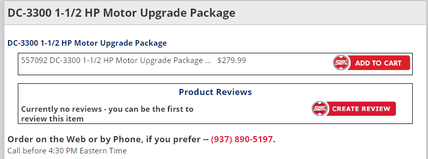

I hope that the answer Paul go is the correct answer and the answer I got was incorrect. The problem, perhaps, is that Paul asked: "I am looking at purchasing the dc6000 upgrade. Will it make my old dc3300 the same as the new dc6000?" The upgrade is not called a DC-6000 upgrade, it is 557092 DC-3300 1-1/2 HP Motor Upgrade Package. So did they (specifically Denise) understand what he was asking? The answer specifically states it was to the CFM question, but just as Dusty asked, is that the DC-3300 upgrade, DC-6000, or both?
All of this due to there being neither picture nor product description to be found...
If I had received the answer Paul received I would have bought it and then looked at the content when it arrived. I don't believe that SS would do what it sounds like they are doing. I still think we have bad info, stemming from the absence of a description. Would they really provide a 300% increase in power with no way to consume that power? That would indeed by slimey. That's inconsistent with my experience, incorrect info from CS is not.

I would not disagree BUT if you check the price for a DC3300 motor only the Shopsmith price is $321.64 (515590). Historically, Shopsmith has priced their motors on the high side and they can because most of them are unique to Shopsmith. I might buy the upgrade kit just to get a replacement motor.
DC-3300 Upgrade Package.PNG (42.13 KiB) Viewed 3999 times

Unfortunately a contradiction. Wonder if the engineer tech was referring the to dc6000 redesign rather than the dc3300 to dc6000 "upgrade".
I would like to believe the marketing and CS info are incomplete/inaccurate.
