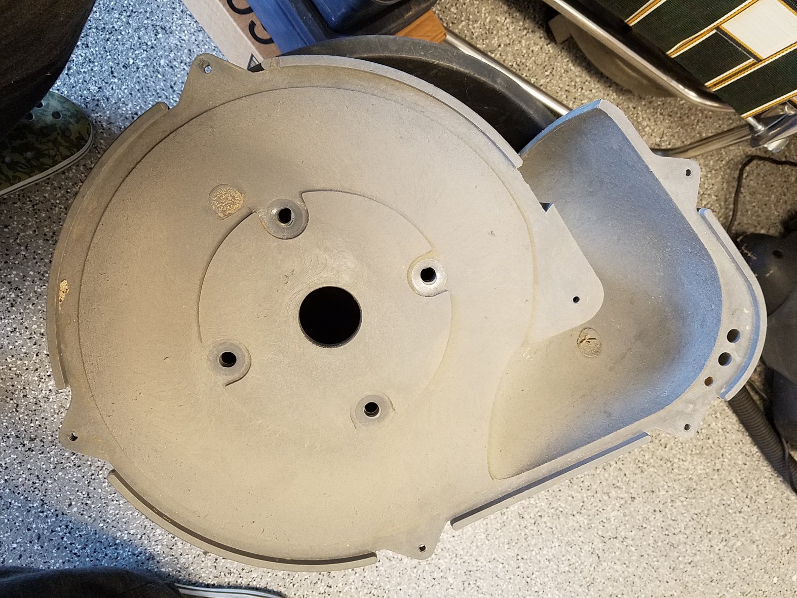

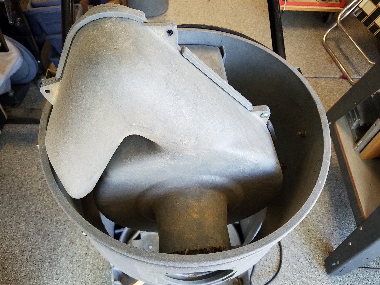

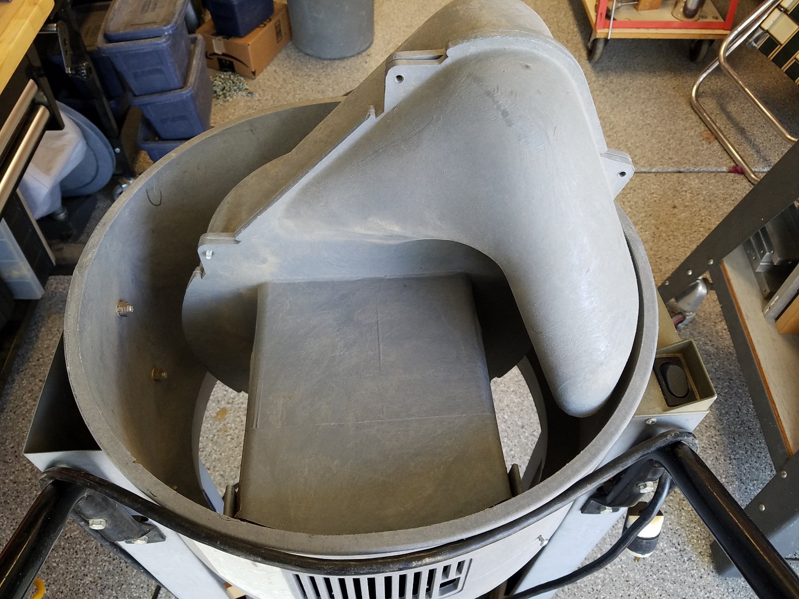

I don't think that the cooling fan is intended to "draw air" at all. I believe it just moves the air same as did the DC3300. In the DC3300 the motor is mounted to the back wall pf the fan housing. Whatever air flow there might have been it had to be drawn through some tiny cracks around the motor.
The fan draws air from the manifold and dumps it directly into the dust bag. There is no seal between to two pieces that make of the housing. If that joint does leak how does it adversely effect the dust collector. It is enclosed within the dust chamber. It don't see how it effects the draw.
The DC3300 Motor Housing and part of the Fan Housing
The Motor Housing
The Motor Housing

Quantifying a couple of Dusty's earlier findings using a main housing with the protruding screw cleaned up and no 'seals,' with each system pulled so that the top gap was minimized:
DC-3300 measure 1/8" top gap
DC-6000 measured 15/64" top gap (almost double)
I used drill bits as feeler gauges, these are not meant to be precise. Root cause seems to be that the that the two motor/fan systems sit at different angles. I measured the DC-6000 tilting downward 1.4 degrees compared to the DC-3300. These measurements are with an almost new foam donut seal on the DC-6000 inlet. If that seal compresses or deteriorates over time, both the gap and angle will increase.

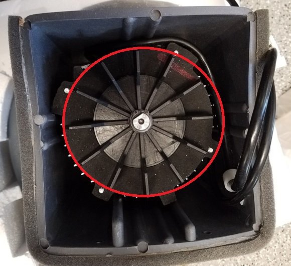

Is it being suggested that cooling air is being drawn from the fan side of the fan housing into the motor housing. I have been under the impression that the area between the fan housing and the motor was sealed. Am I wrong? Is there a free flow of air into the motor housing from the fan housing?
Is there a cooling fan on/in the back side of the DC-6000 motor?

dusty wrote: Sat Aug 28, 2021 5:13 am Is it being suggested that cooling air is being drawn from the fan side of the fan housing into the motor housing. I have been under the impression that the area between the fan housing and the motor was sealed. Am I wrong? Is there a free flow of air into the motor housing from the fan housing?
No. Sorry for any confusion. It is being suggested that the air (with dust) leaking past the perimeter of the motor housing may be providing some of the motor cooling. And conversely, that sealing up the five-sided box that forms the motor housing makes cooling air flow inside that box problematic. Resulting in elevated motor temperatures for extended run time.
Please clarify. Are you asking if there is a second fan, besides the one that's exposed? Or did you mean DC-3300?

DLB wrote: Sat Aug 28, 2021 8:13 am
-David
Isn't Dusty talking about this fan?
