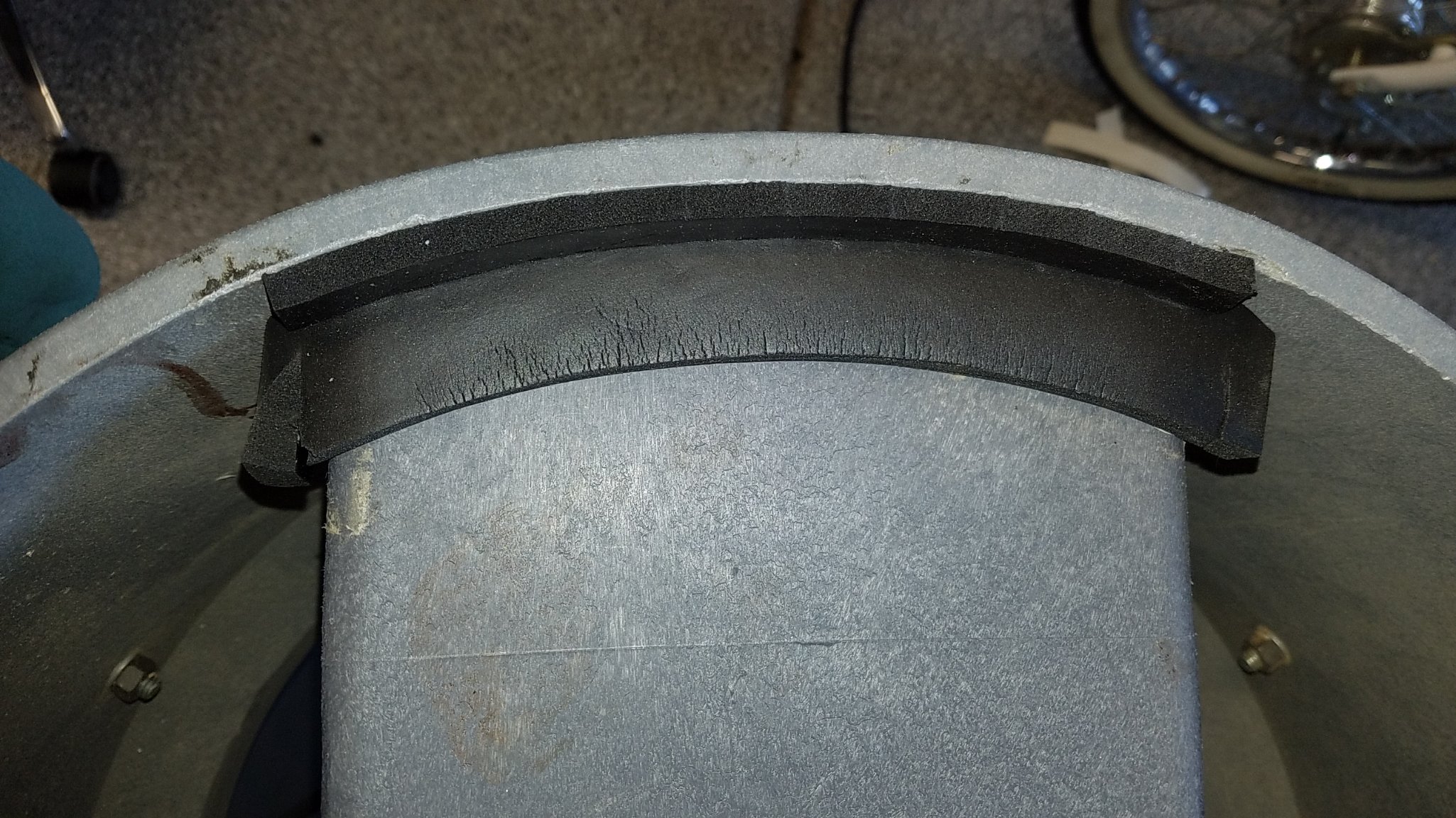

Re: New Shopsmith DC-6000 Dust Collector
You have resolved, at least for the moment, the same issue that Dave and I had with the DC-6000. The primary difference is that the gap with your DC-3300 is.was a lot smaller than what occurs after the upgrade kit is installed. This is the gap that I had with my DC-6000:Majones1 wrote: Sat Nov 06, 2021 6:40 pm Last month I took my DC-3300 apart to check it out and clean it when someone on this forum suggested that the suction appeared to be weak (due to the amount of chips left after an operation). I found the gap that you all talked about, and the foam had disintegrated into a nasty tar that was difficult to clean off. I had some felt sheets that I cut up to make filler gaskets, and in some areas I had to put double layers. When I put the DC back together my suction was much better. I don’t think the felt will disintegrate like that crappy foam did.
I purchased some gasket material at Ace that worked well. It is thicker and wider than what Shopsmith provided. Even then, I doubled up on the layers to further improve the seal. What it looks like now.
I have yet to do a lot of heavy work with the new DC but what I have done has indicated to me that I have the problem licked.
The dust that collects in the motor housing is through this gap and with it now closed - I have none in the motor housing.
It has been reported that Shopsmith (Jim) sealed the gap with silicone. Not my idea of a proper solution. The gasket that I have used is better but I believe is still a POOR solution. That huge gap IMO should not be there at all and would not be had the redesign had been completed.
If there is a leak between the motor housing and fan housing I do not consider it an issue. Whatever dust that does move through that leak remains within the DC with all the rest.
