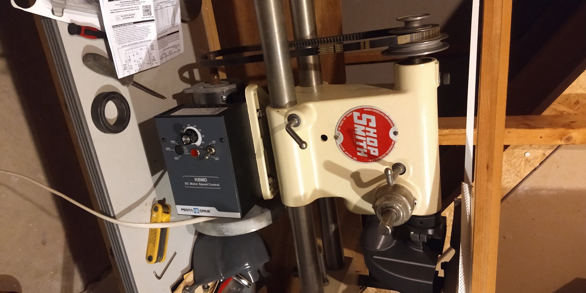

2021 update on the status of this ER. Being derusted and restored with new paint, this one has never made it out to my shed or garage. I have used it in the basement as a lathe, sander, drill press, and a few other functions. However we've since finished over 90% of our basement, and creating dust indoors is hopefully a thing of the past. I have it in a utility room that I hope to seal up some day and use dust collection in, where we can go to make crafts and gifts and do simple cuts. But my other 10ERs that followed this first one definitely see a ton more usage out in the shed. But with cold weather upon us, and the shed being drafty and allowing snow in, I want to be able to make some ornaments indoors before Christmas. So I've just about completed my DC conversion on this one. Should be pumping out a few snowmen next week.
