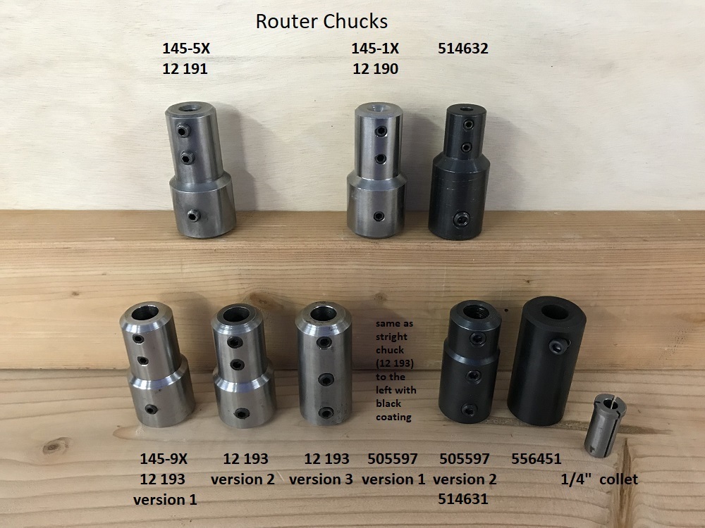

Shopsmith has had different Router Chuck options. There are the 1/2" and 1/4" ones you mention with the two set screws to hold the bit. This type has been used for years going back to the Shopsmith Model 10's. There was also a 5/16" Router Chuck that was discontinued long ago. The other was the 1/2 Eliminator Chuck P/N 556451 introduced in 2017 but has now been discontinued from the SS catalog. A 1/4" Collett P/N 523146 was also available to use 1/4" shank Router Bits with the Eliminator Chuck. Below is a picture of the different Router Chucks. The top row is a 5/16" and two 1/4" Router Chucks. The bottom row is 1/2" Router Chucks.
Router Chucks - labeled.jpg (226.53 KiB) Viewed 10638 times
Depending on the router operation you can use the Shaper/Drum Sanding fence with Router bits also. Just make sure you get the version for the Mark V 510, 505, 520 and Mark 7.

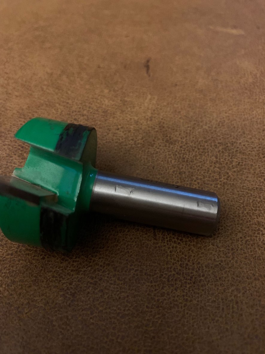

This might be to your point in this 2020 post. I am trying to use the overhead shaper on a 510. Running a 1/2" leveling (grizzly bit) in the 1/2" shaping chuck. I am trying to level uneven slats in butcher block. However, each pass is at a slightly different level then the last so it is not leveling at all. After about a pass and a half the level is quite far off. I tried retracting the quill all the way and moving the powerhead directly to the work surface just to trouble shoot whether or not there was variance in the quill depth. I got the same result. It appears that either the bit is moving within the chuck or the chuck is moving on the drive shaft (the bottom of the work piece hasn't been planed but it doesn't have that much variation). I noticed two marks on the bit shaft that seems like maybe the bit is sliding within the chuck (pics below).
Just wondering if anybody knows of something I am doing wrong or has a fix for it, or maybe it is as Mark7 Routing said and the chuck just is not nearly stable enough compared to a pressure collet?? Perhaps I need to try to obtain and OPR or a sled for this operation?
