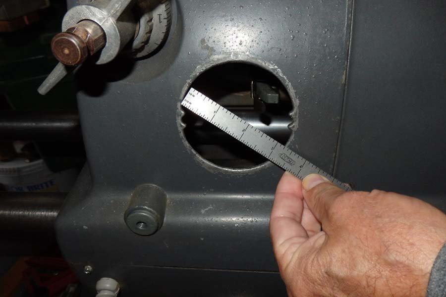

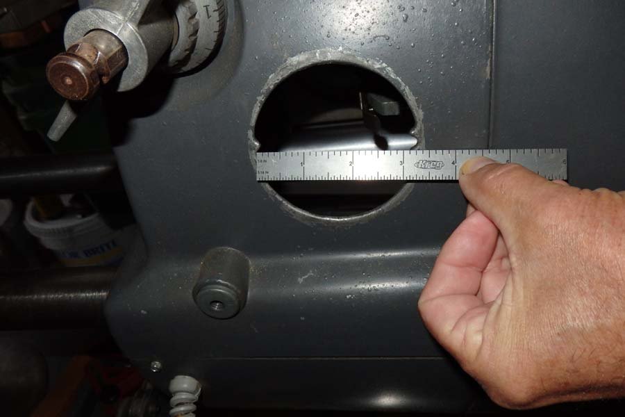

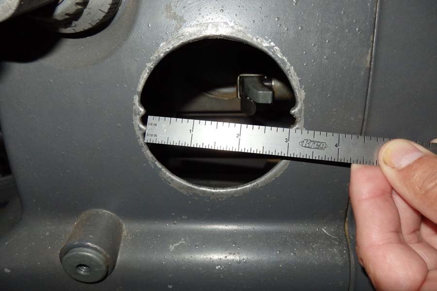

My "B" headstock hole is just barely big enough for my not-so-large hand, and I sure wouldn't want it any smaller.

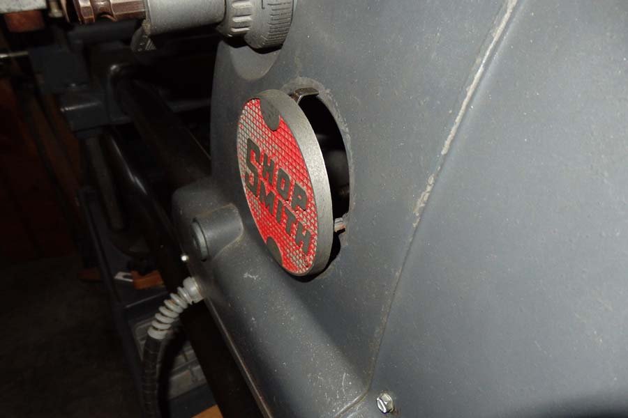

Rather than try to reuse your existing logo plate mounting holes, I would make a larger carrier plate and attach the old logo plate to it, if you're striving for keeping the appearance as authentic as possible.

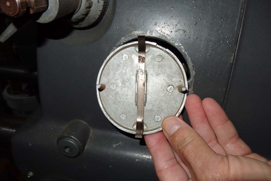

FYI, here are some pictures of my access hole and its cover.

Thanks for the info gents. In the pictures above, is that clip behind the nameplate a modification or is that a stock plate?
'54 greenie
br549
Posts: 657
Re: drilling access port - size question
Post by br549 »
Stock.
