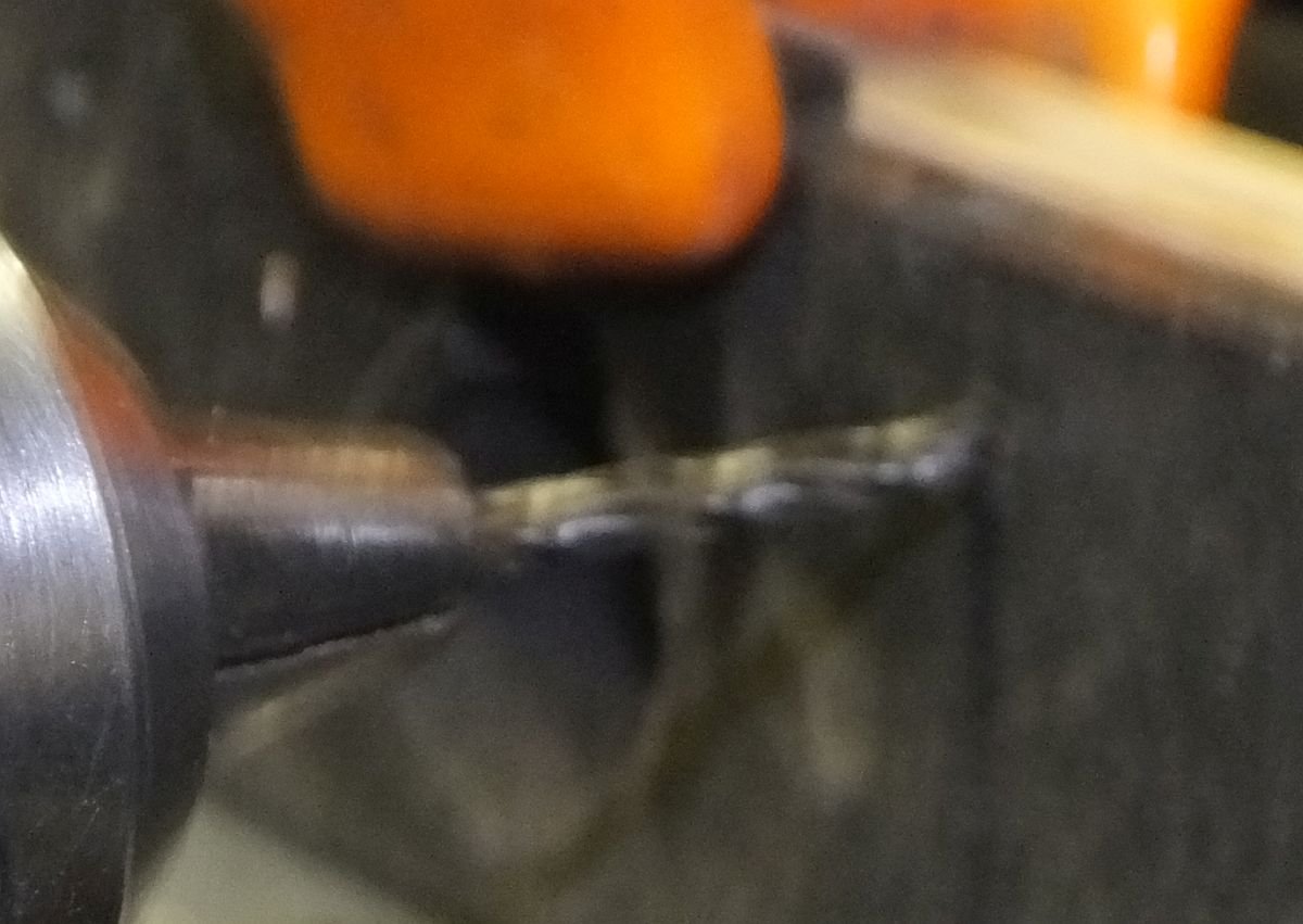

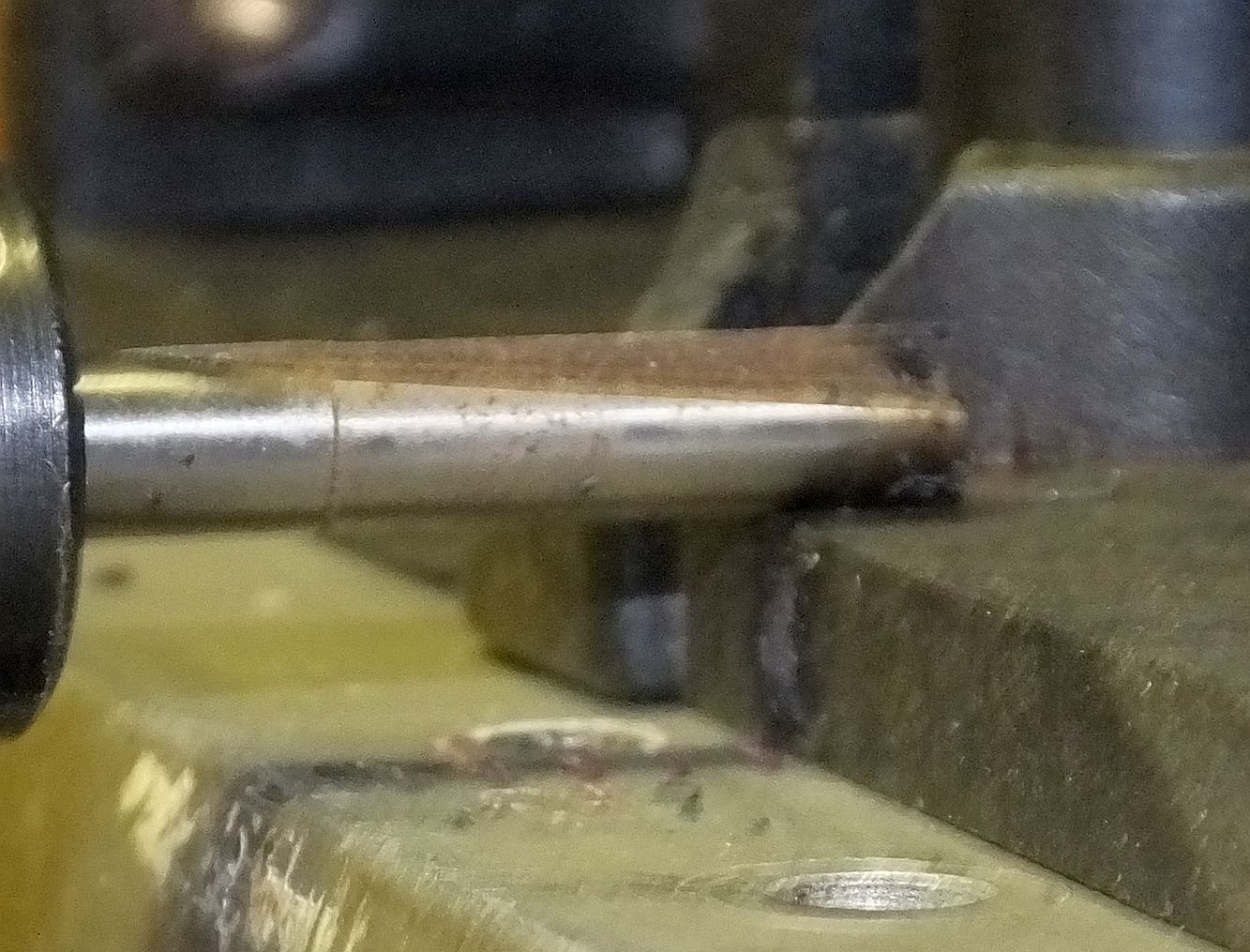

A tentative first cut to remove the damaged area using an old 1/4" carbide router bit and the M5.
Setting final depth using a SS part intended for another purpose. The od is the same as parts that normally reside there.
Early cutting pass.
After final pass.

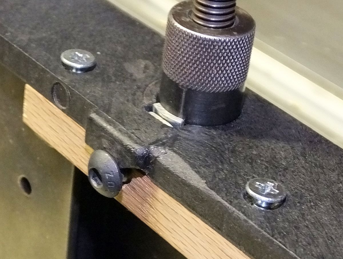

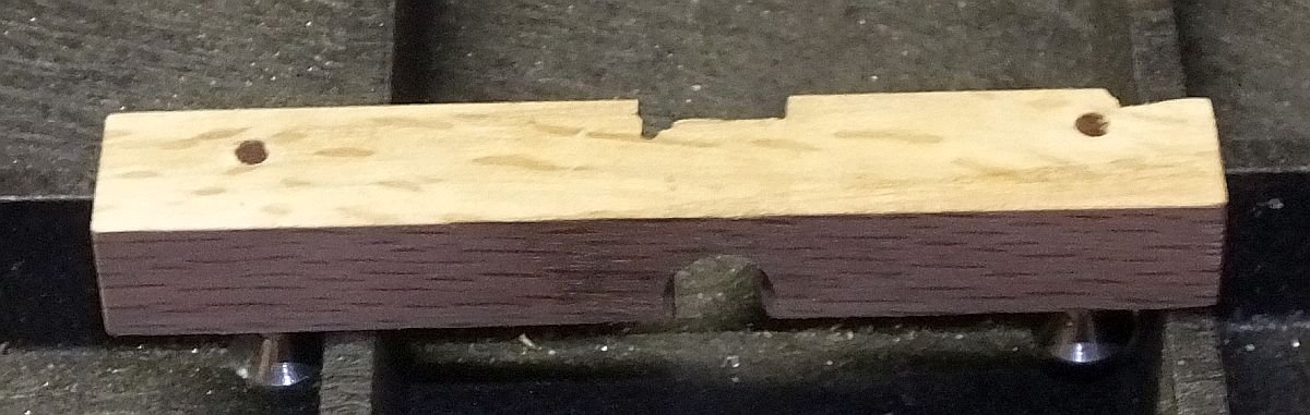

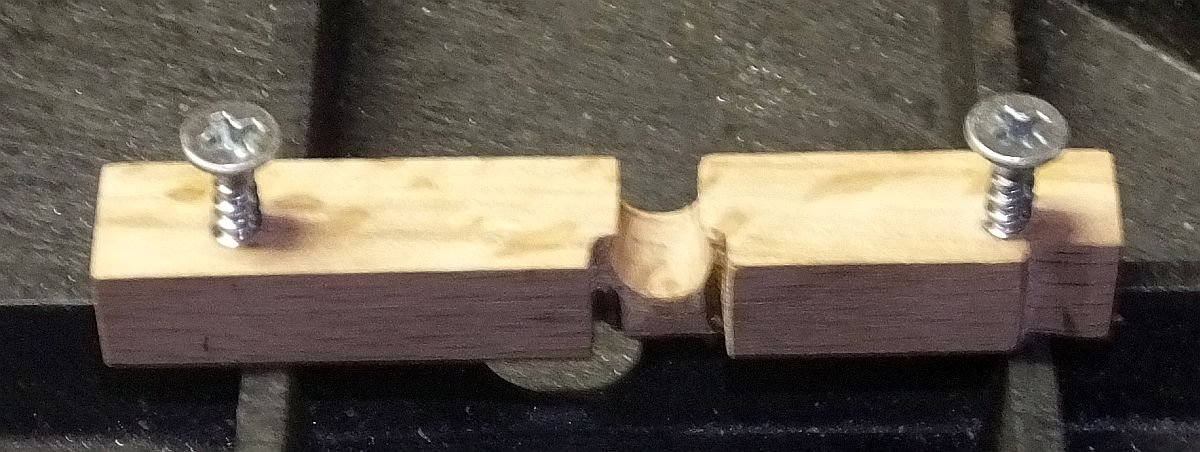

Oak to the rescue. 1/2"x 7/16" x 3+" sanded to size using a MVII conical disk and the M5 table/rip fence with saw blade slot. BTW the MVII conical disk bevel is about 1.5°.

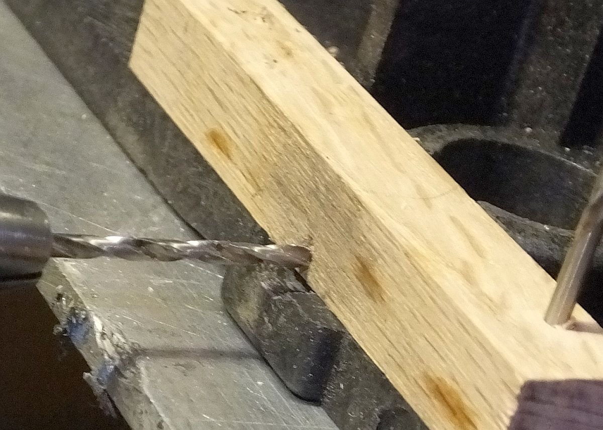

First need to drill holes for the screws that attach the oak to the slide. It will be used as a reference/locator for subsequent operations.The hole is through the oak.Sorry about the 'focus'.
Now to locate for a partial hole that the clamping screw threads engage. Originally this was a molded in brass insert. using a transfer punch locating on the original insert hole(part or which remains on the slide).
Using drill bit to center the quill center axis on the dimple just created with the transfer punch.
Early cutting pass.
After final pass.

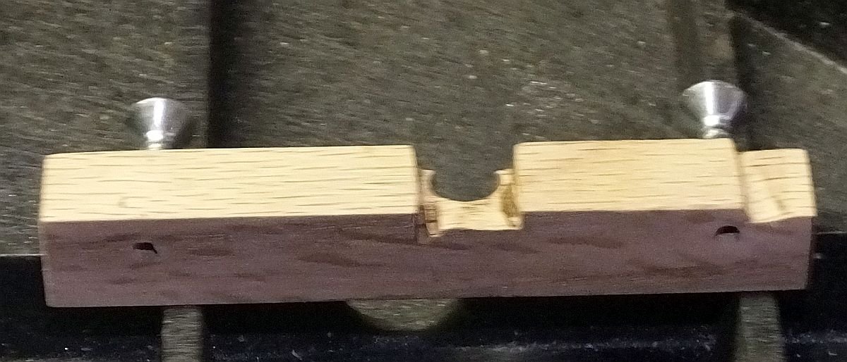

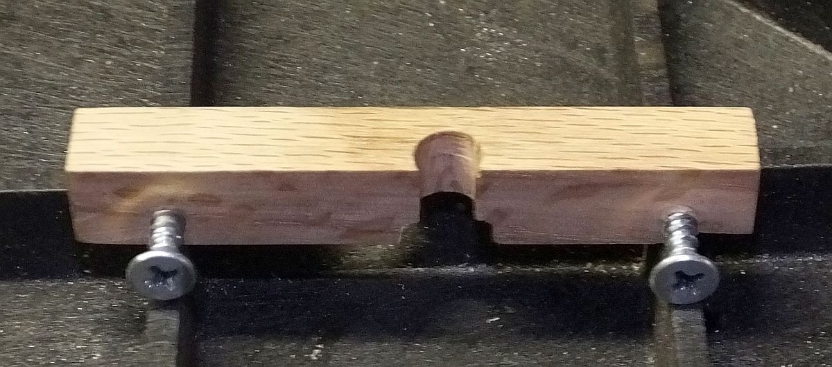

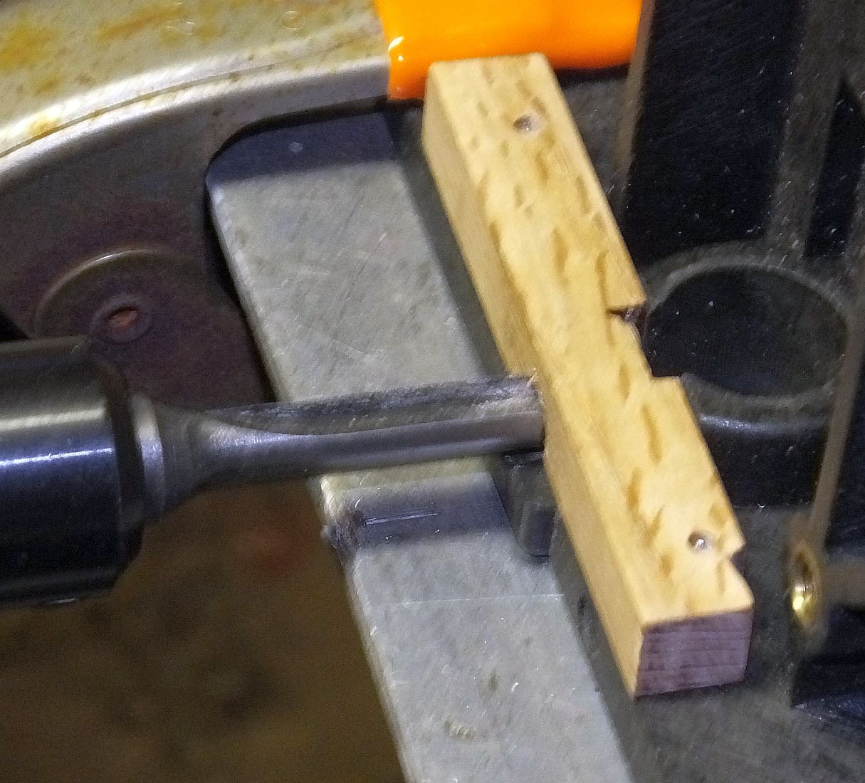

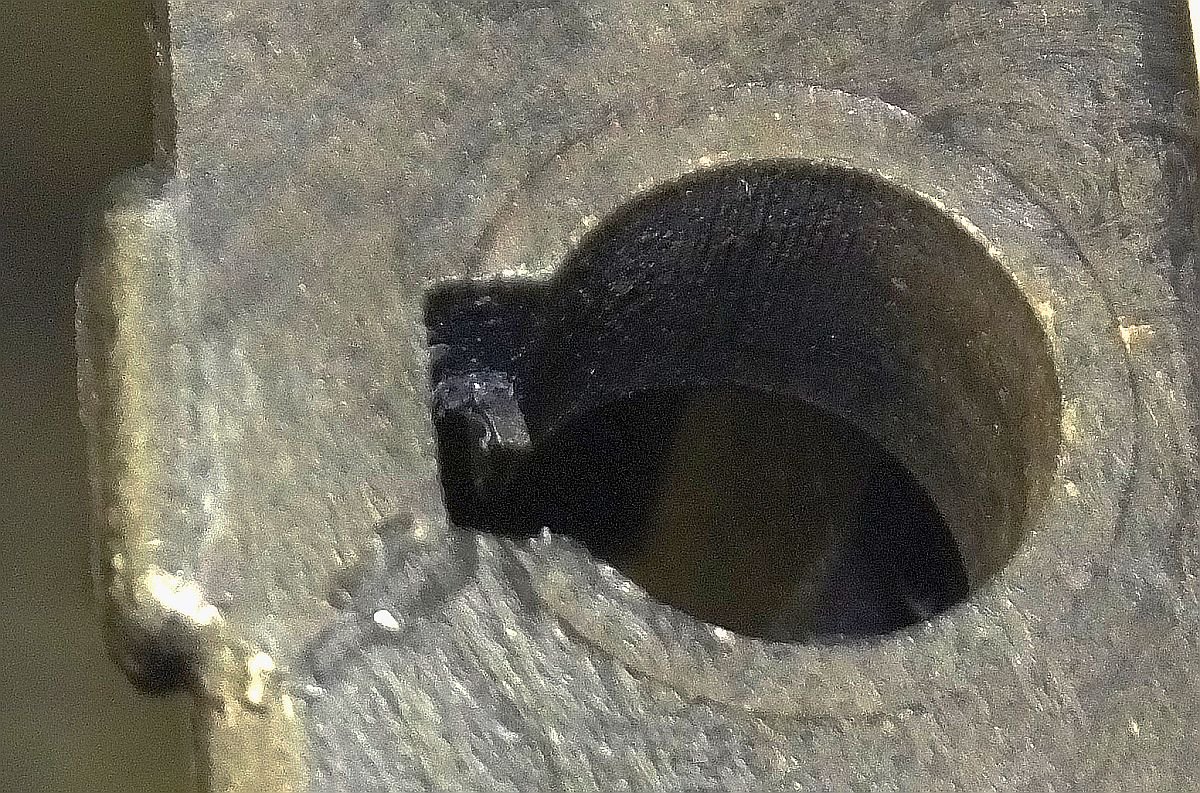

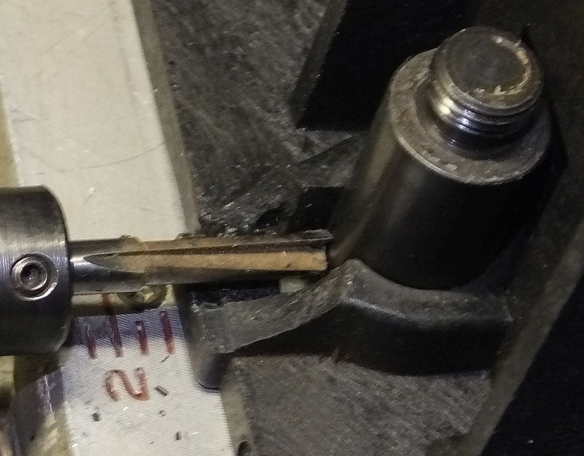

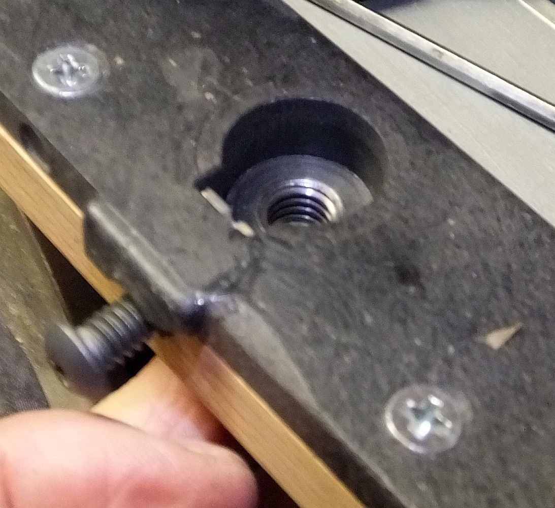

Milling a partial hole in the oak using that old 1/4" carbide router bit.

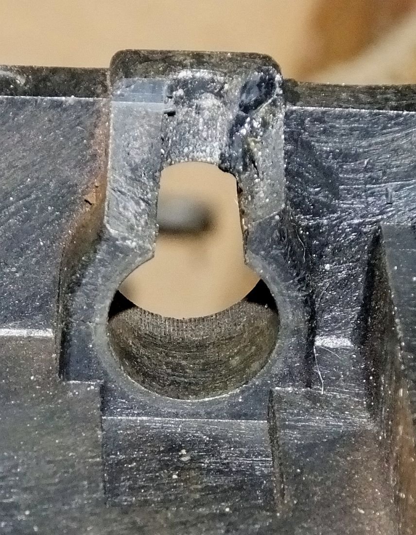

The notch in the slide hole requires a similar notch in the oak.
Less said about the method to create the notch the better, but here it is. Those observant will have observed the pix sequence does not exactly match the text.

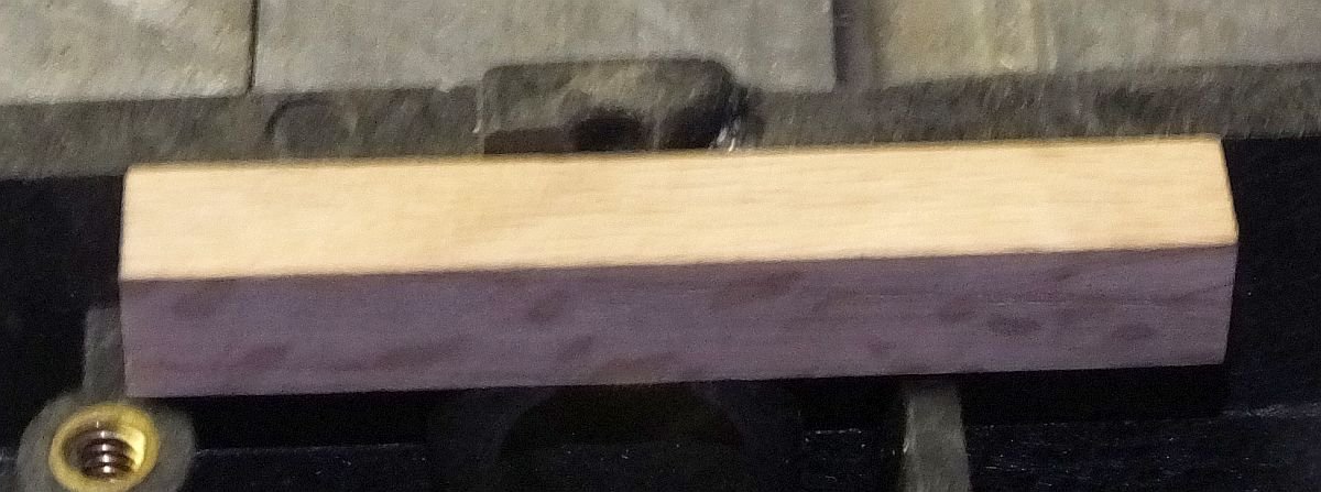

Another view of the oak.
And another.
Last one.

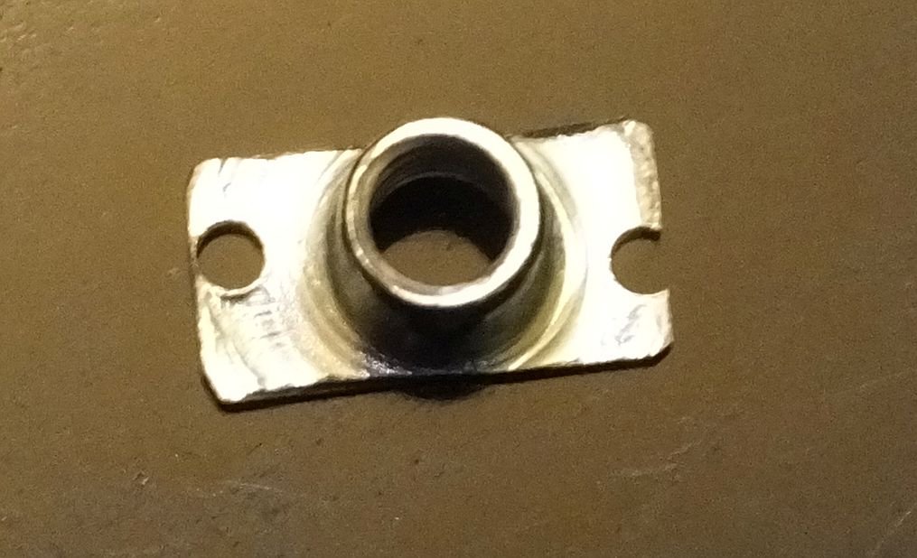

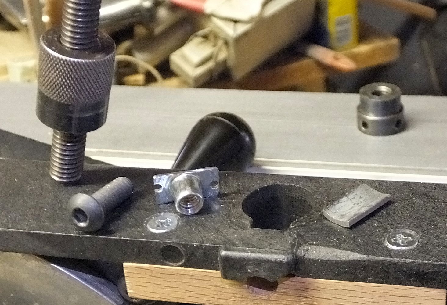

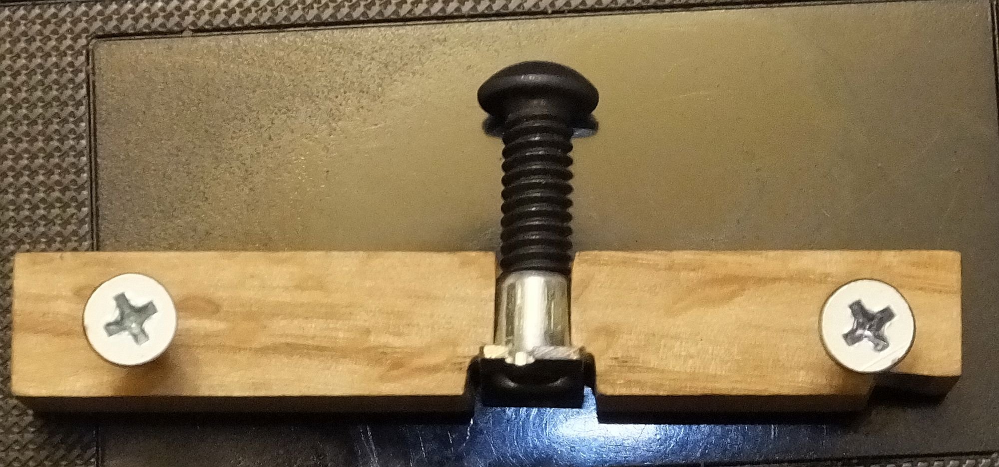

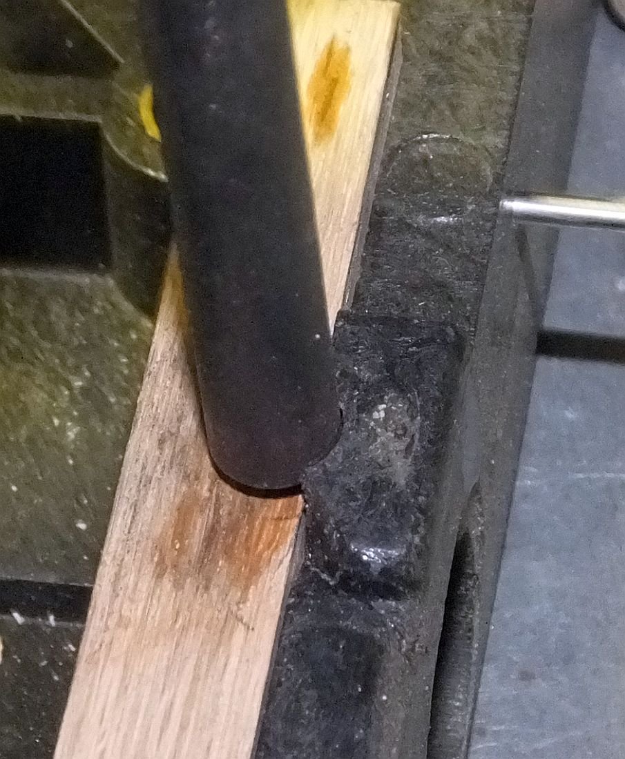

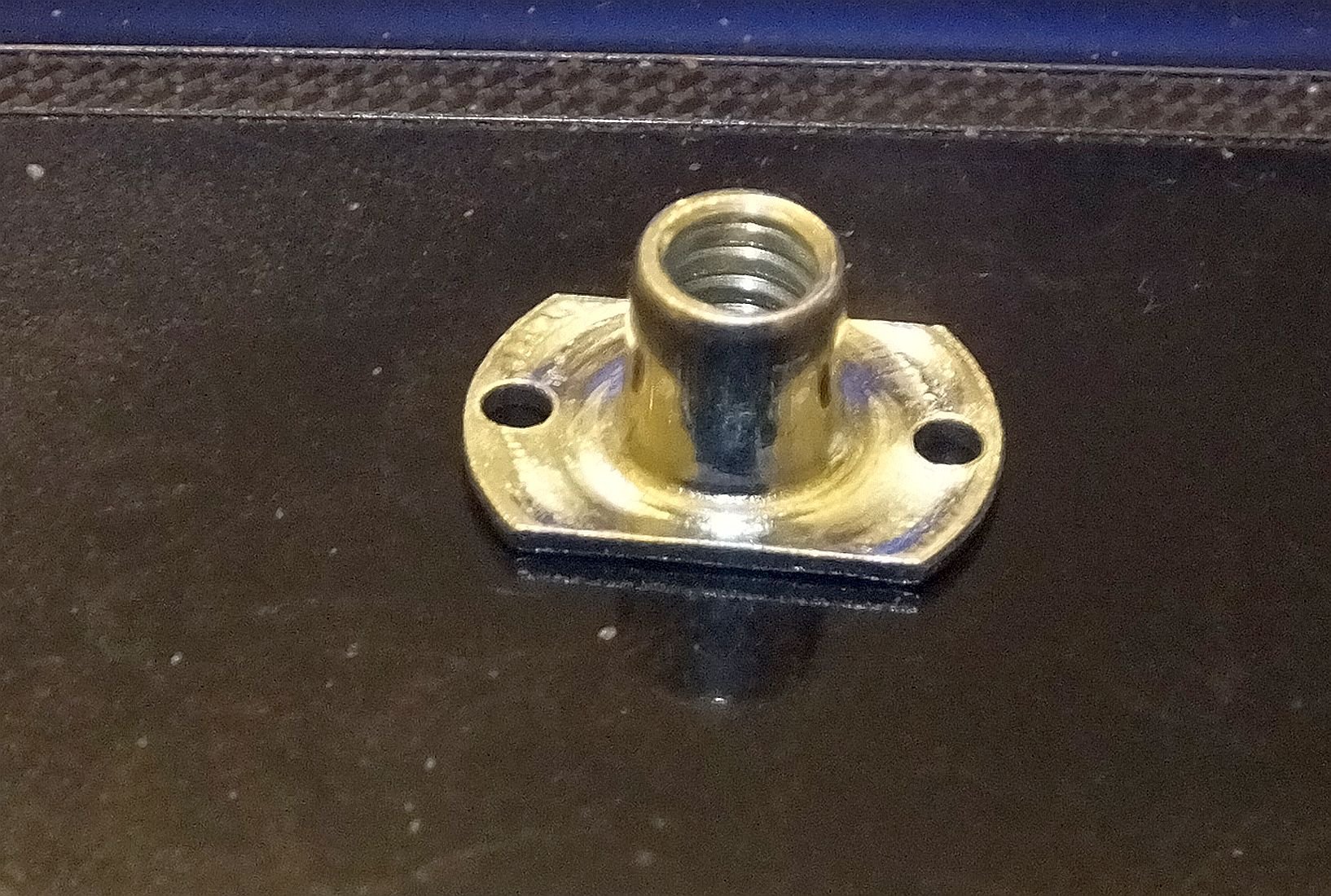

OK now what is going to replace the threaded insert? Raw material for that.
After some alterations. Narrow to fit in the slot and shortened to clear the top.
Then fit into the slot in the oak.
And another.
Last one.

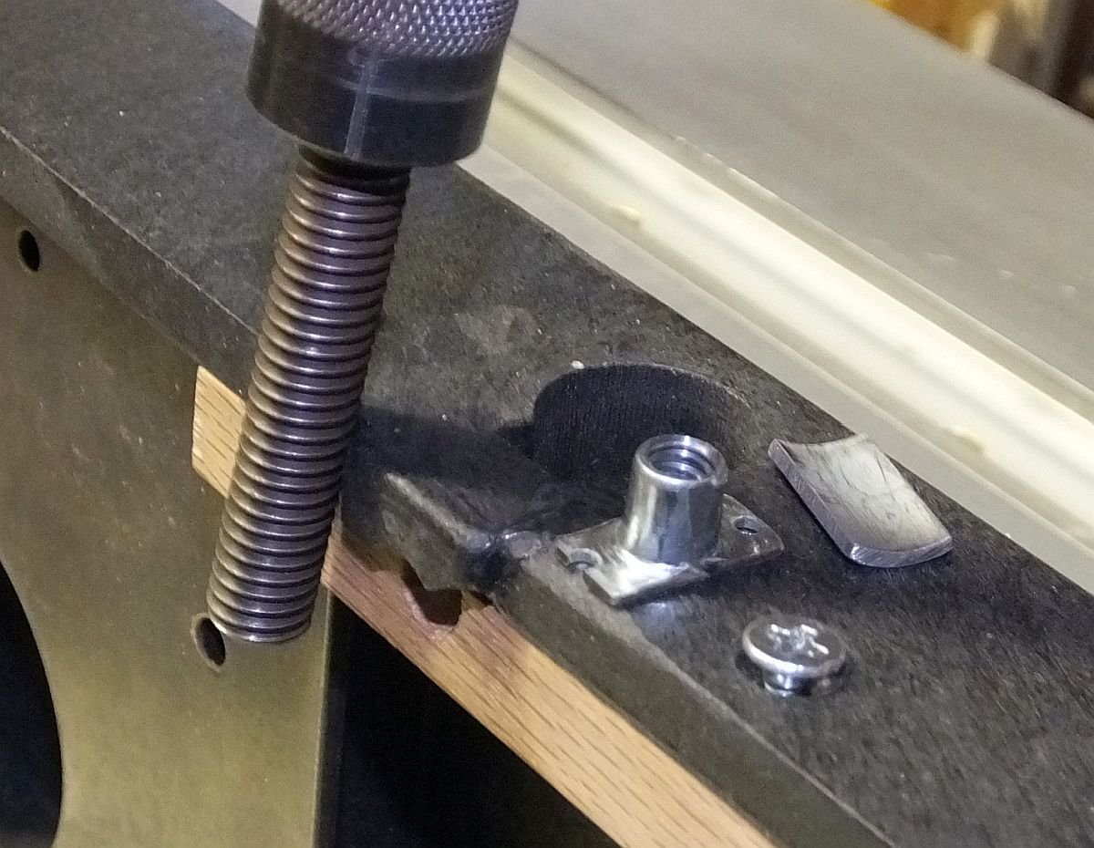

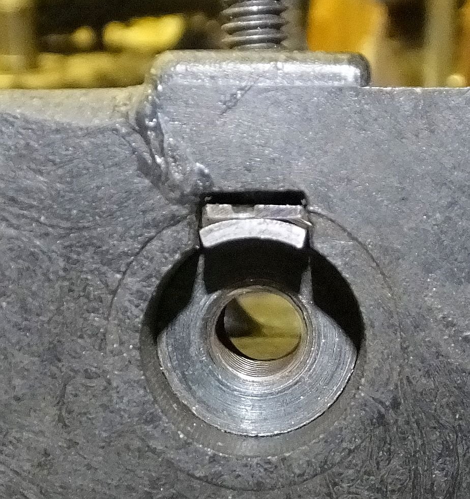

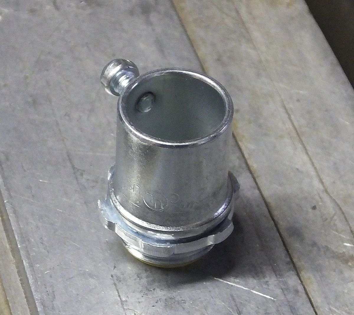

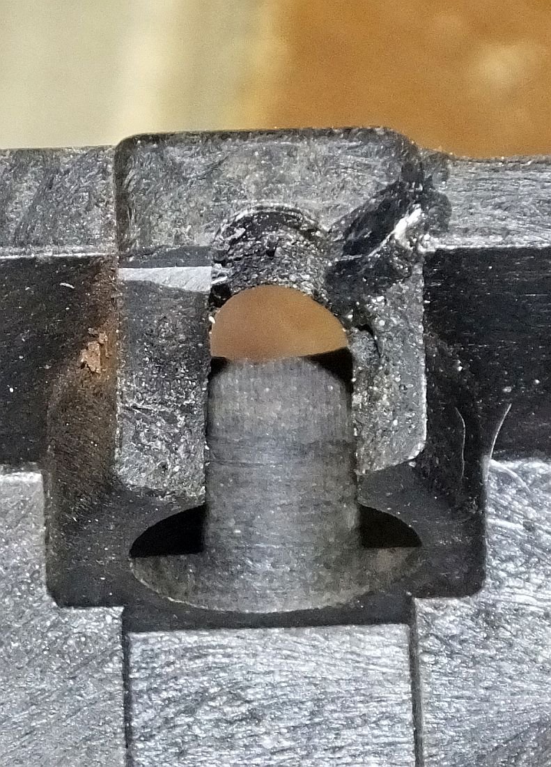

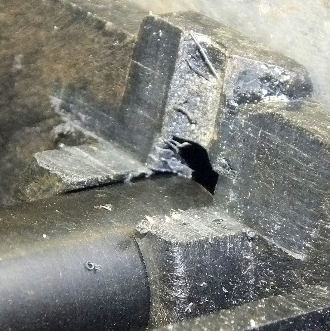

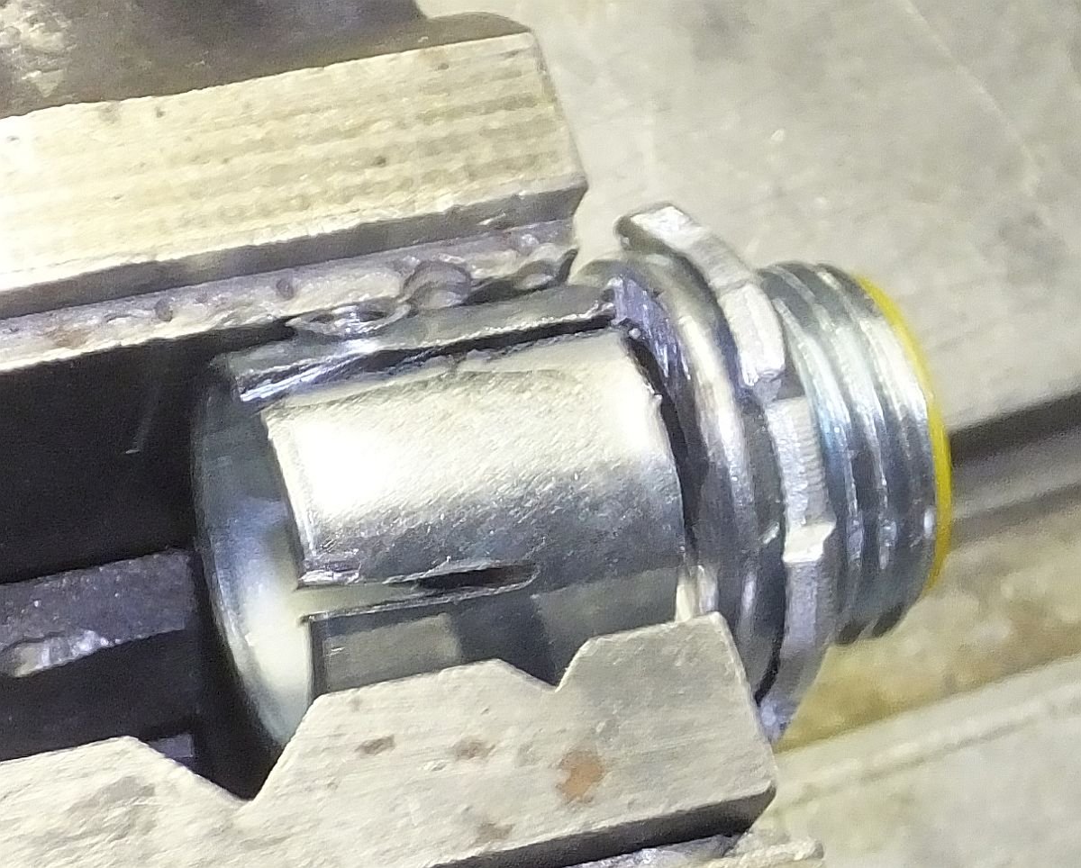

Now about that missing gibb. Raw material = 1/2" EMT coup[ling.
Performing a crude harvesting.
After refinement a test fit. That threaded part in the hole is one that belongs there. The fit is acceptable.
Another pix somewhat out of sequence, but it shows the fit of the gibb. The radius of the gibb is slightly smaller that the part(s)itclamps against - that is good - distributes the force over a greater area.

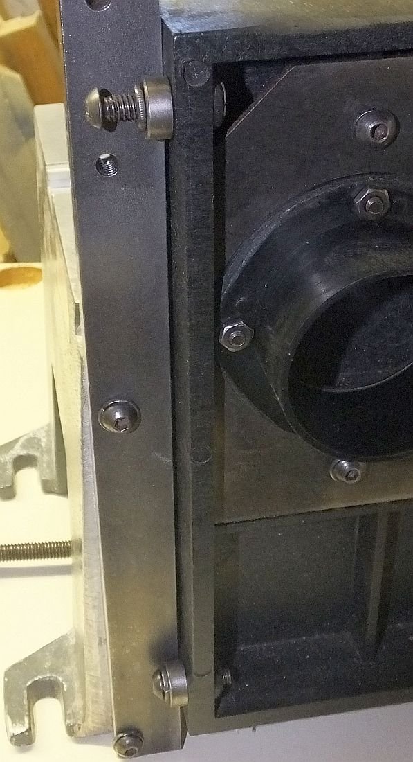

REASSEMBLY BEGINS

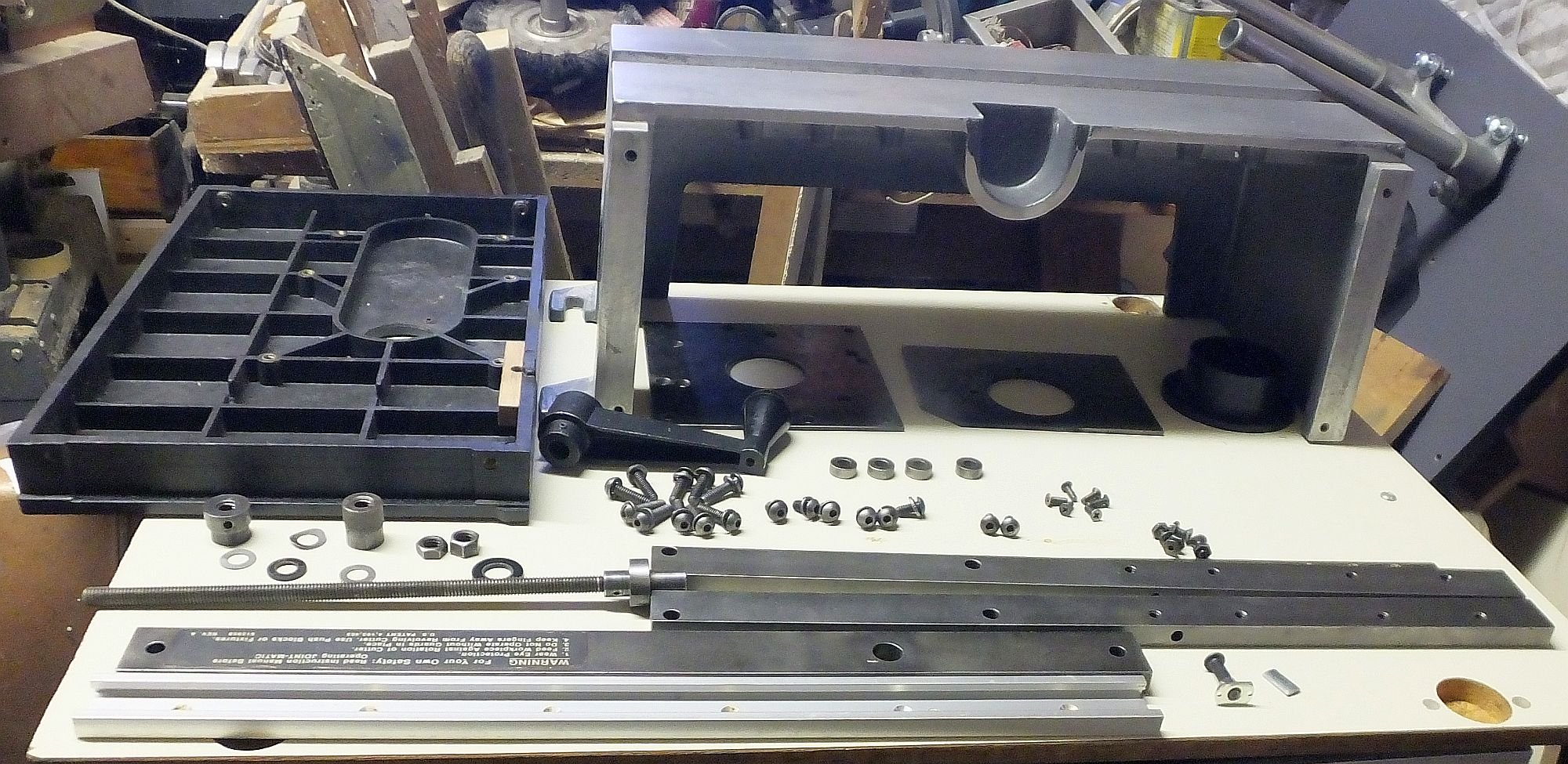

So what does all the parts look like. Some 'new' screws are included. Other embellishments will be revealed later.

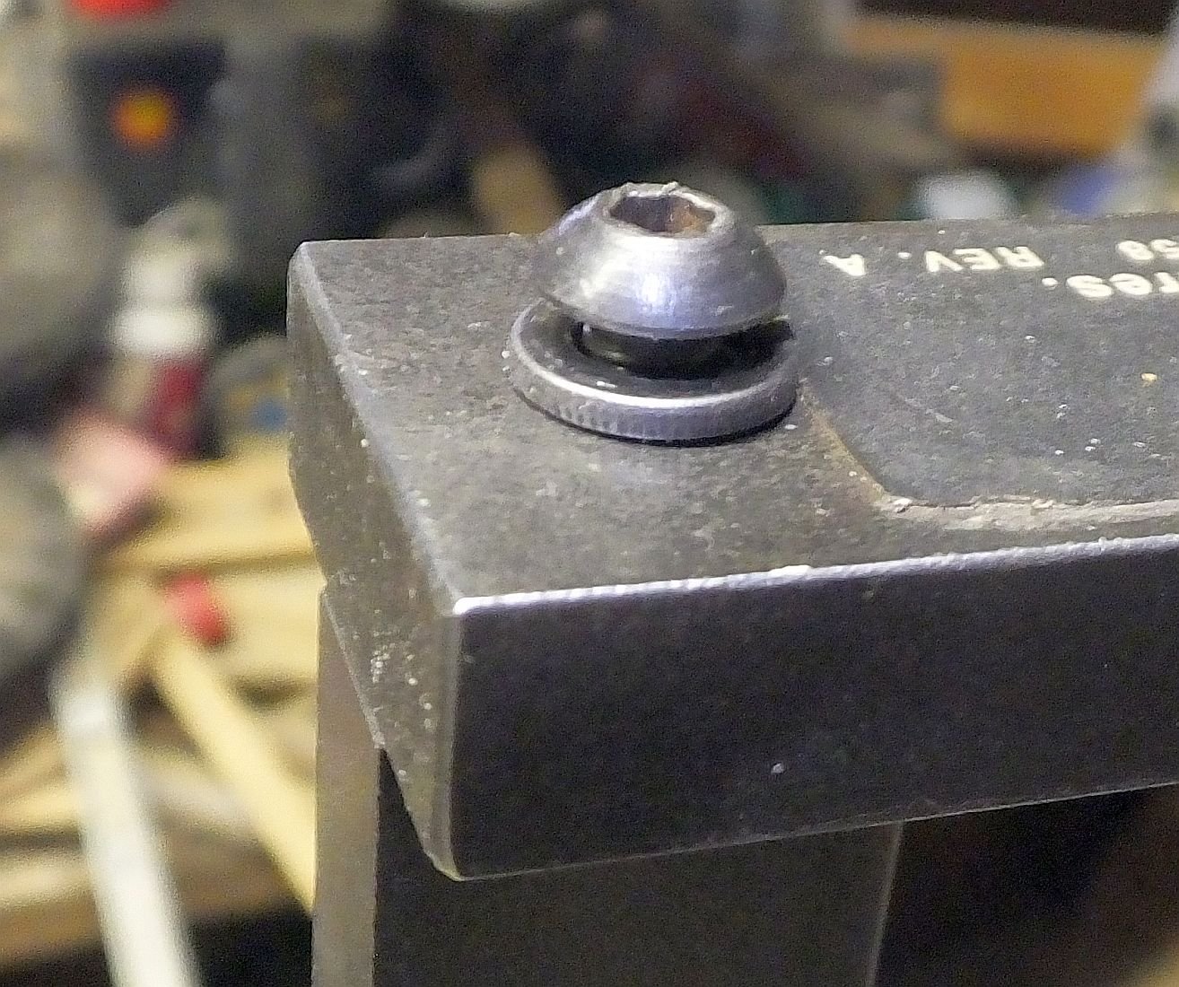

First reattach the miter gauge slot extrusion. Simply snug results in a good fit. To much gorilla and the miter gauge bar will jam.

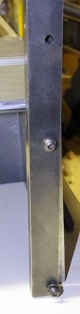

The two vertical slide guide bars are attached first. Note the bar holes are offset. Correct orientation is required. Merely snug at this time.
Next the top horizontal bar is attached. After the top bar is tightened, the vertical bar screws can be tightened. I do not think it is necessary to use a square here. The slide fit is sloppy.
The slide has a projection on the front. Screws and spacers retain it from the rear. Another pix out of sequence.

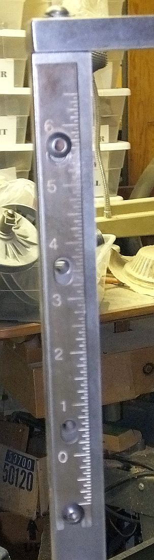

Height scale is added on the left side. Two screws original, I will use screws in all 4 slots.

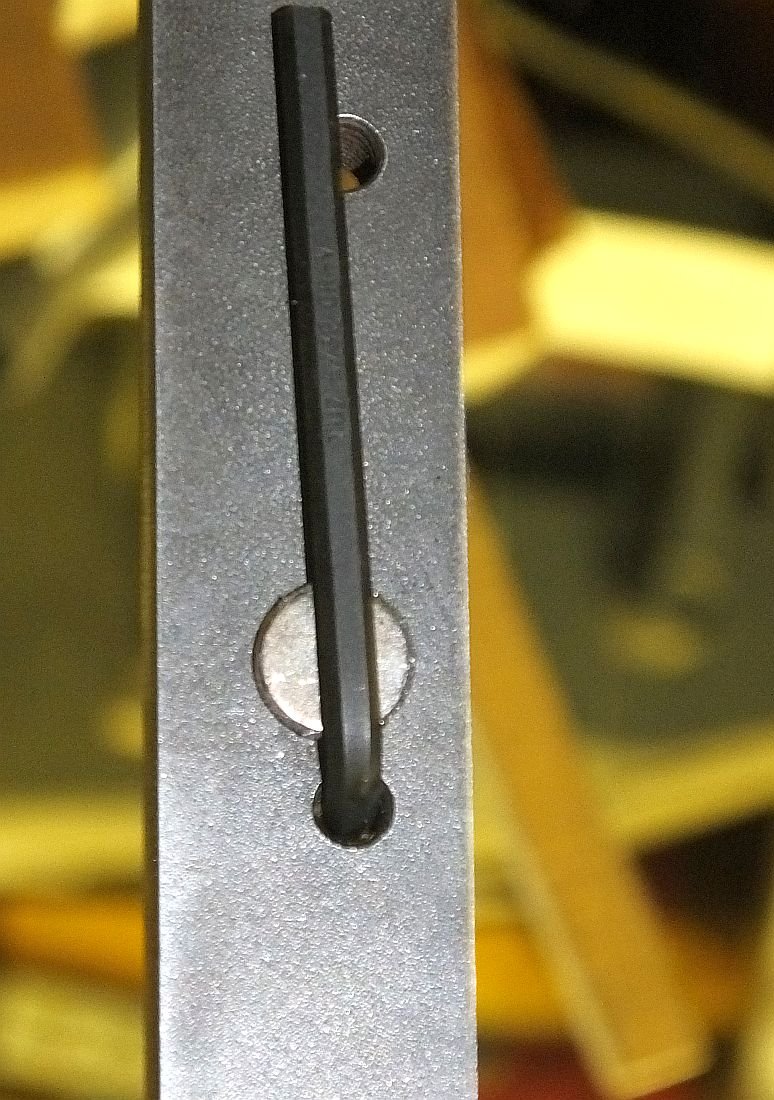

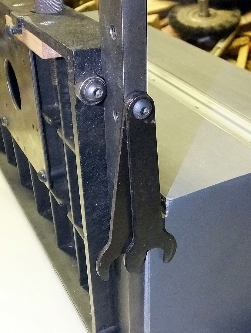

An embellishment - Use unused threaded hole to store router chuck wrenches.
And another unused hole on the right =side to store a small 5/32 hex wrench. A magnet simply attaches to both the bar and the wrench. Pushing the wrench back from the front moves it away from the magnet so it can be removed. Hmmmmm. Somebody posted the pix upside down!
REASSEMBLY BEGINS

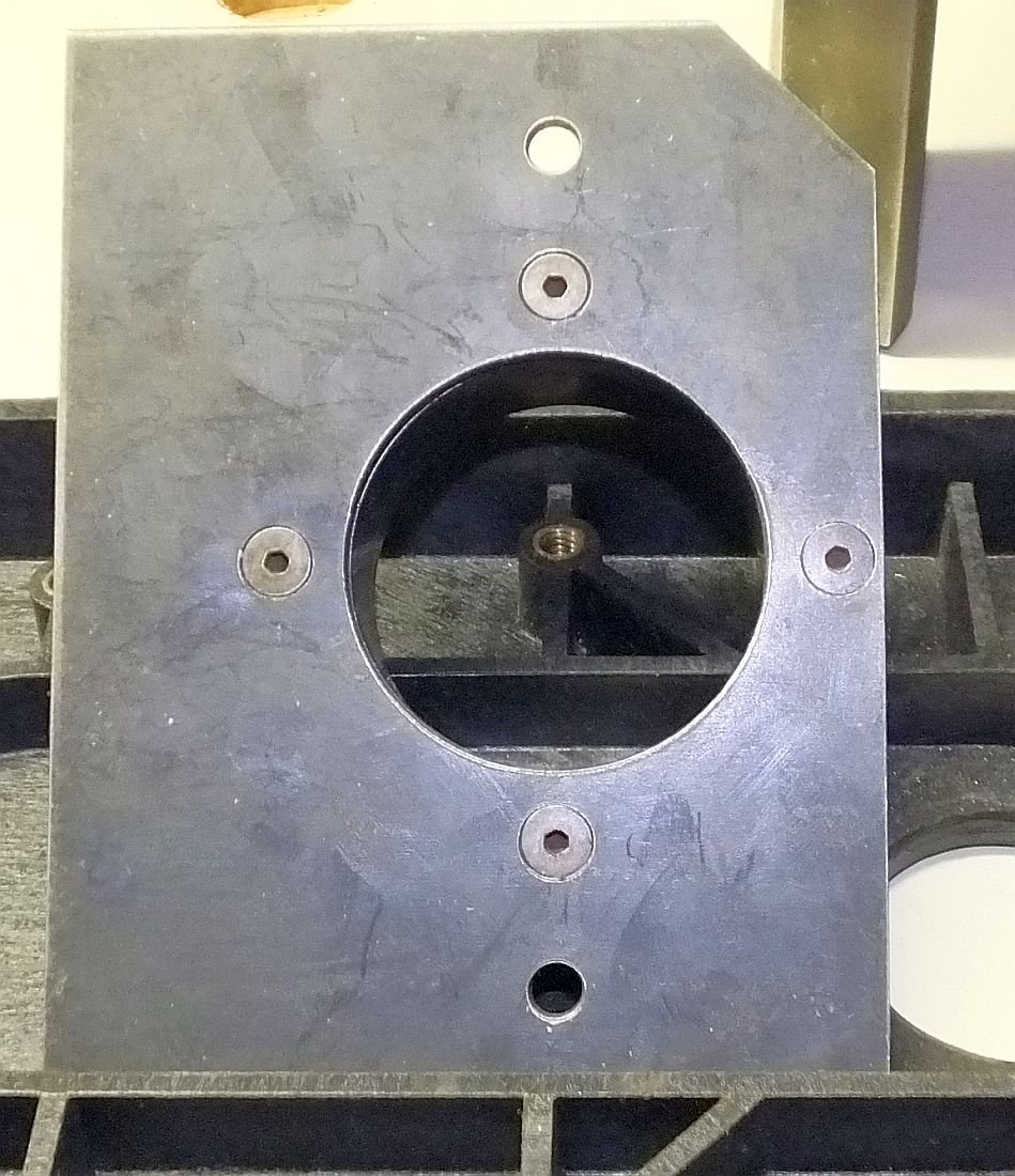

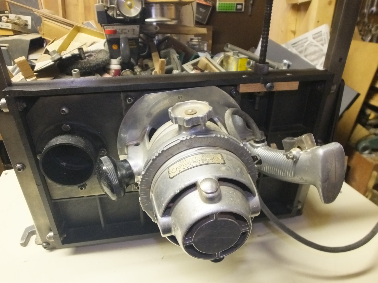

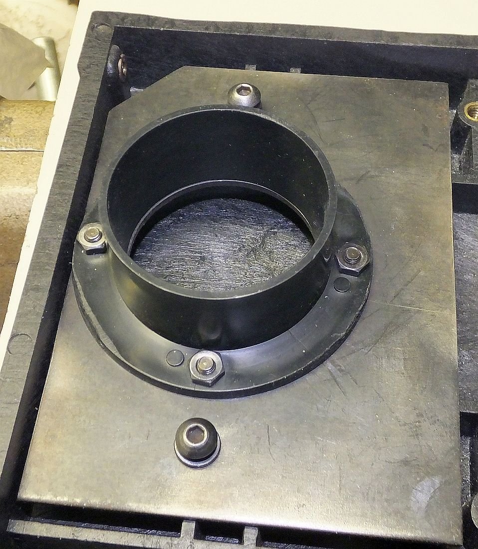

The dust port mounting plate has counter sunk holes for the hose coupling mounting screws. The router mounting plate has similar countersunk holes in varying hole patterns for different routers.
The dust port attaches to the plate and the plate attaches to the slide.

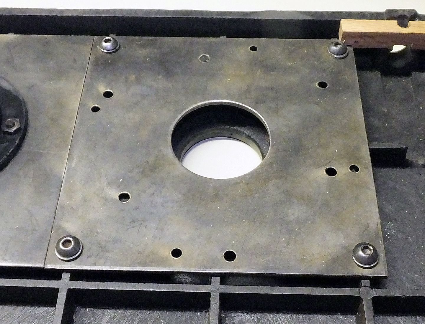

The router mount plate attaches to the slide - router added last.

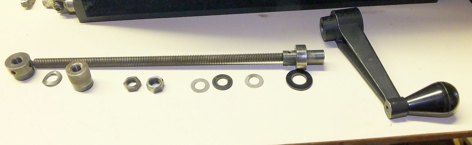

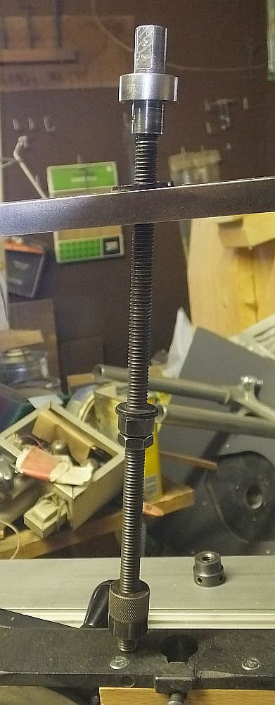

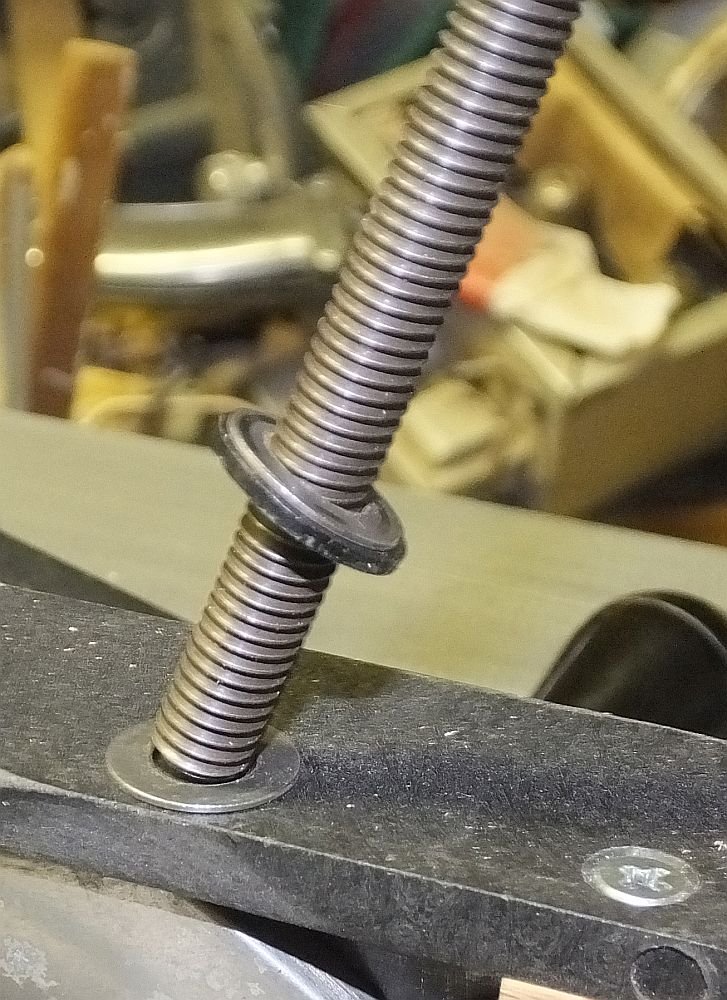

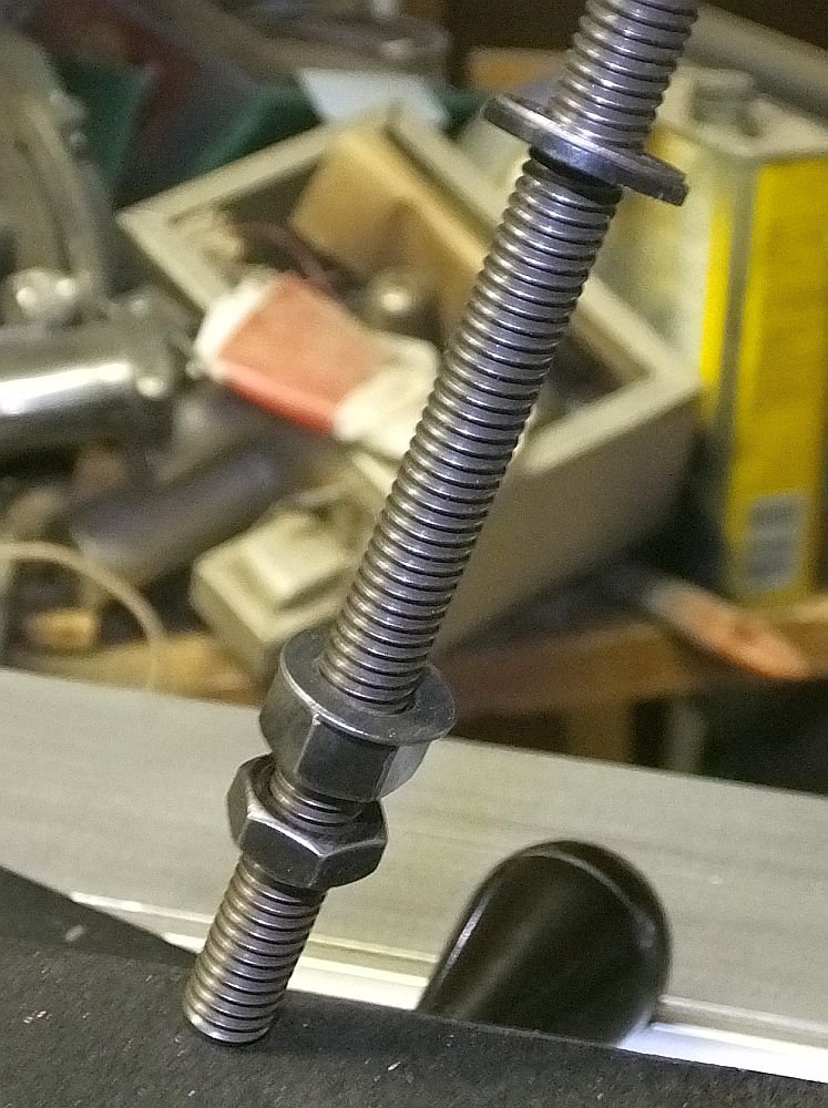

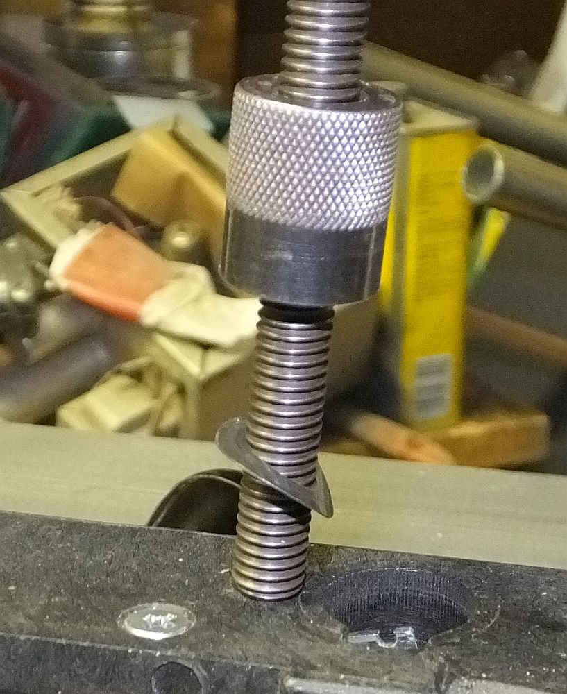

Now for the tricky part. The slide height screw ASSEMBLY.

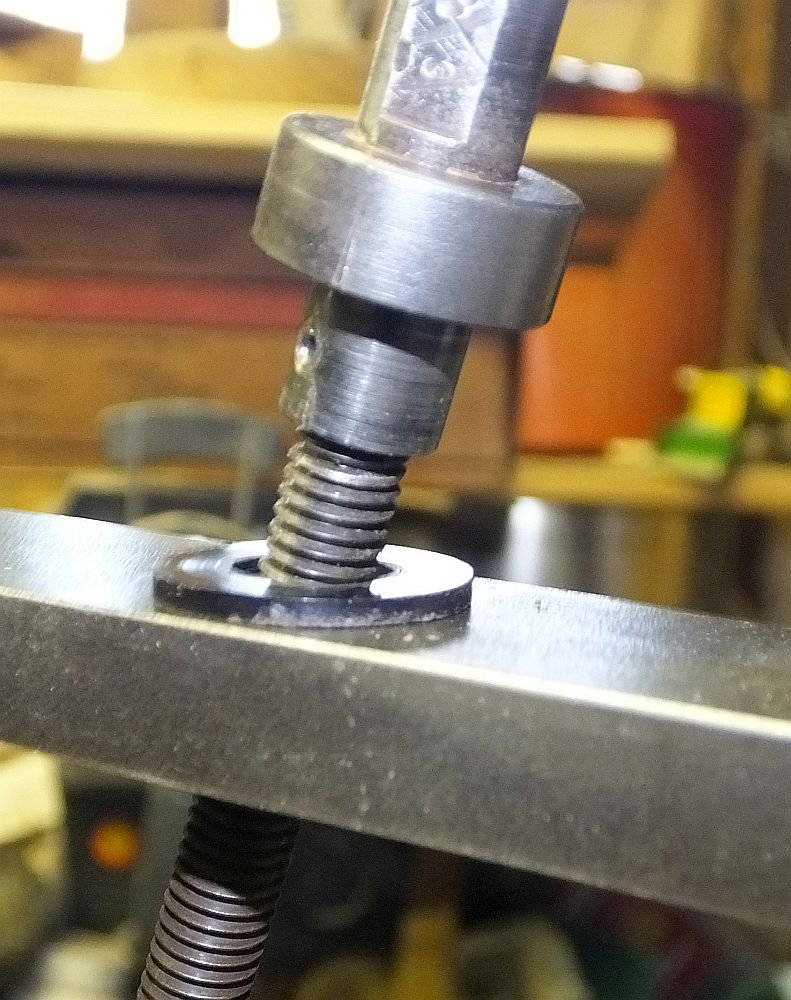

The sequence of parts attachment to the lead screw. The large nylon washer goes on the threaded shaft first. It provides a low friction bearing for the bottom of the top of the lead screw.
Then the screw with washer attached is put through the hole in the top rail. Under the top rail the small nylon washer is sandwiched between two thin metal washers and slipped unto the rod. The nut and lock nut are threaded up to a few inches. The knurled threaded bushing and spring washer must be run up on to the rod a few inches.
The free end of the rod needs to be inserted into the hole in the top of the slide.

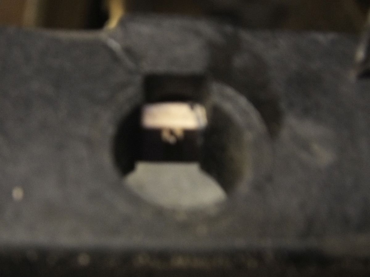

BUT first the new parts need to be put in their slot. The last part needs to be placed in the recess for it under the slide hole.

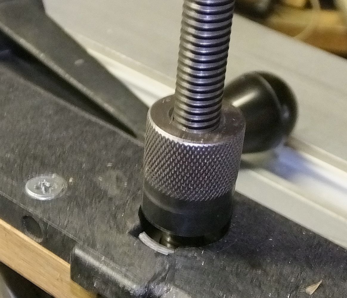

Then the rod assembly is slipped into the hole and the bottom part threaded onto it. The nut and lock nut are run up to the washer trio and snugged up and jam nutted.
The crank is mounted on the top of the threaded rod with the set screw on the flat.
Final positioning of the parts in the slide hole is attained when final alignment is done.

Finally a router mounted. I got lucky - the router hole pattern was time relevant for the mounting plate.

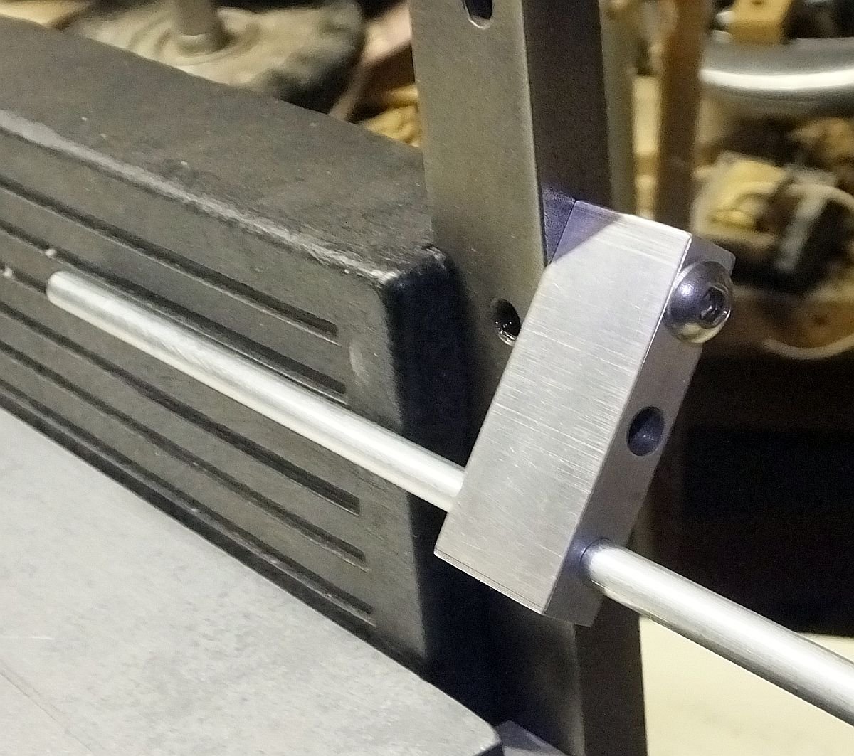

Left this out above.
This is a home made mitre gauge stop rod. By removing the short rod it mounts to the right vertical rail using an otherwise unused tapped hole. Uses set screws with 5/32 hex socket.
Height adjustment screw assembly pix coming.

JPG wrote: Tue Feb 22, 2022 3:49 pm Back to 'normal' assembly.
ADD DC PORT & PLATE.jpg The router mount plate attaches to the slide - router added last. Now for the tricky part. The slide height screw ASSEMBLY.
feed screw 1.jpg Under the top rail the small nylon washer is sandwiched between two thin metal washers and slipped unto the rod.
feed screw 2.jpg The nut and lock nut are threaded up to a few inches.
feed screw 3.jpg The knurled threaded bushing and spring washer must be run up on to the rod a few inches.
feed screw 6.jpg The free end of the rod needs to be inserted into the hole in the top of the slide.
feed screw 5.jpg The last part needs to be placed in the recess for it under the slide hole.
feed screw 7.jpg Then the rod assembly is slipped into the hole and the bottom part threaded onto it.
feed screw 8.jpg The nut and lock nut are run up to the washer trio and snugged up and jam nutted.
A screw takes the place of the original knob for clamping the slide to the stuff on the bottom of the screw. It is not something that will be adjusted often. I think only once will suffice if done correctly and nothing else changes.
I will be fixing that verbage.
