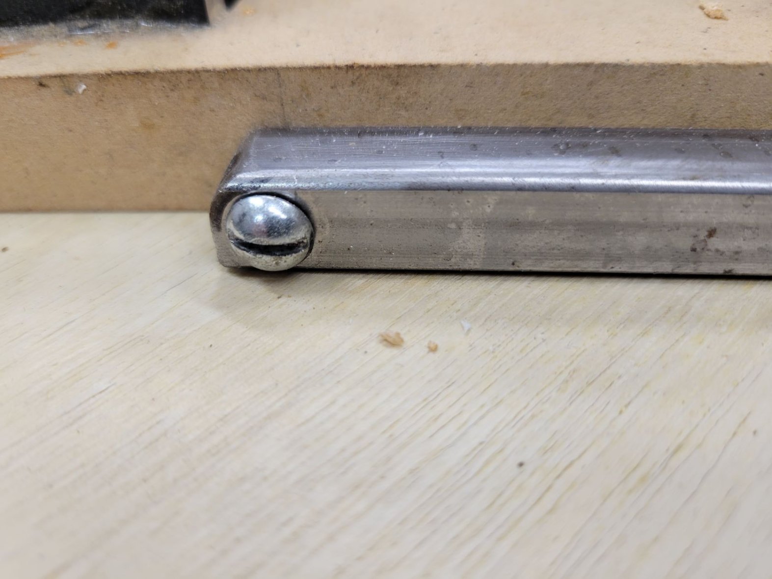

Can't believe it's been 12 years since I built Nick's jig and only now trying to use. It just seems like a terrific "foolproof" jig. Well dang me. I set my knives and wow they were big time off. I found my steel tubes weren't absolutely flat on the outfeed table allowing them to tilt slightly down at the knife point. Using a feeler gauge I found mine are above the table by .009 at the pivot point. Any thoughts about how I might go about fixing this?

bottom of steel tube at pivot is .009 above the bottom

(Full disclosure: First time I've seen this, and I did not watch the video.) Looks like your round-over on the metal tube or bar is on the top but should be on the bottom. Is it possible you created the 0.009" error by inverting and/or interchanging the bars? If not, and IIWM, I think I would just re-drill the hinge holes a little farther back from the knives location. Because IMO it would be best if the dial indicators were directly above the knives anyway, so that whatever they are indicating is the actual knife offset above the outfeed table. I don't see any advantage of having the metal arms extending as far past the indicators as shown.
What a great observation. I';ll check that out right away.
Also love your idea of just moving the arms back some and drilling a new hole. I was way overthinking how to reattach them.

Update: FIXED.
Turned out that when I snugged the tubes to the body they got pulled up a smidgeon. When I loosened them they sat flat and the whole device worked tremendously. Easily got all the blades to .001. Sweet.
