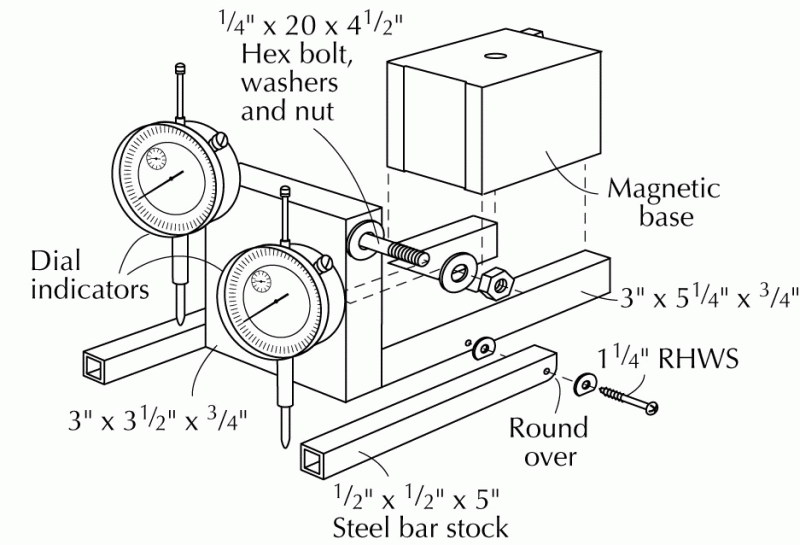

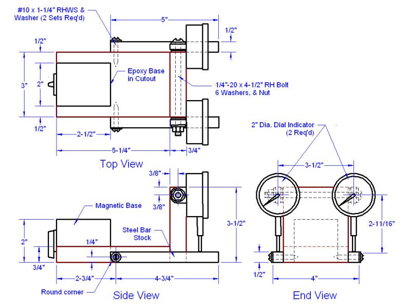

Has anybody built and used Nicks jointer knife setting jig? Or maybe Spikes, that he was going to post?

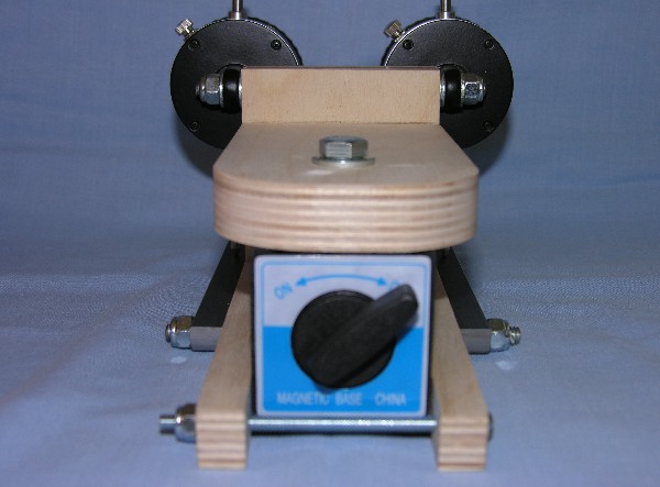

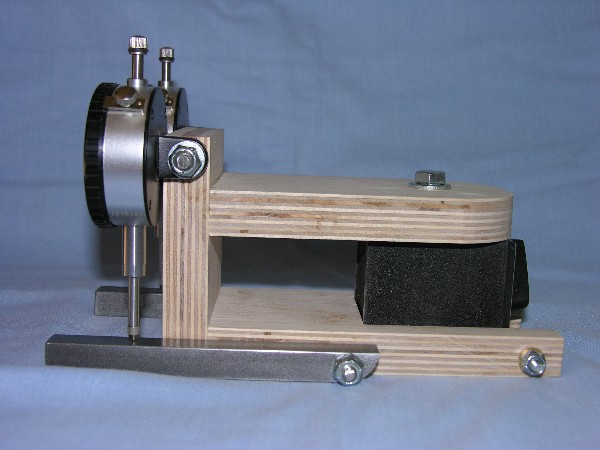

Yes - and it works great. Search the forums because someone (I forgot who) made a modification where a piece is added to screw into the top of the magnet and attach to the vertical gauge support. This makes the set up much more stable.
Michael

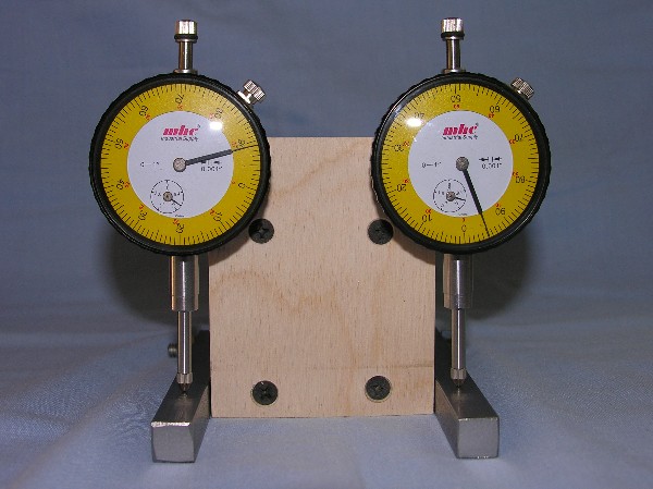

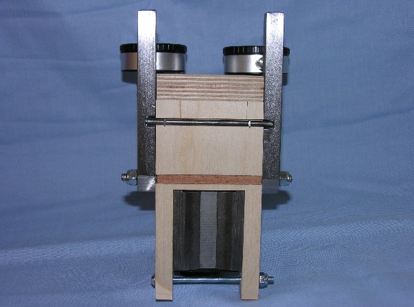

The pics of the one I built. It works well for me.

I've been eyeing this jig for several weeks now. With the sawdust session no longer available, I can't figure out how it works. From the drawings it looks like the dial indicator measures to the top of the metal "outriggers" and not at the top of the blades. So obviously I'm missing something. How do you use this thing?
And the mod that adds a wooden shelf and bolt on top of the magnetic base - that seems like a very good idea. But surely the bolt doesn't go into the magnetic base, does it? What exactly does that bolt do and how is it built into the jig?
