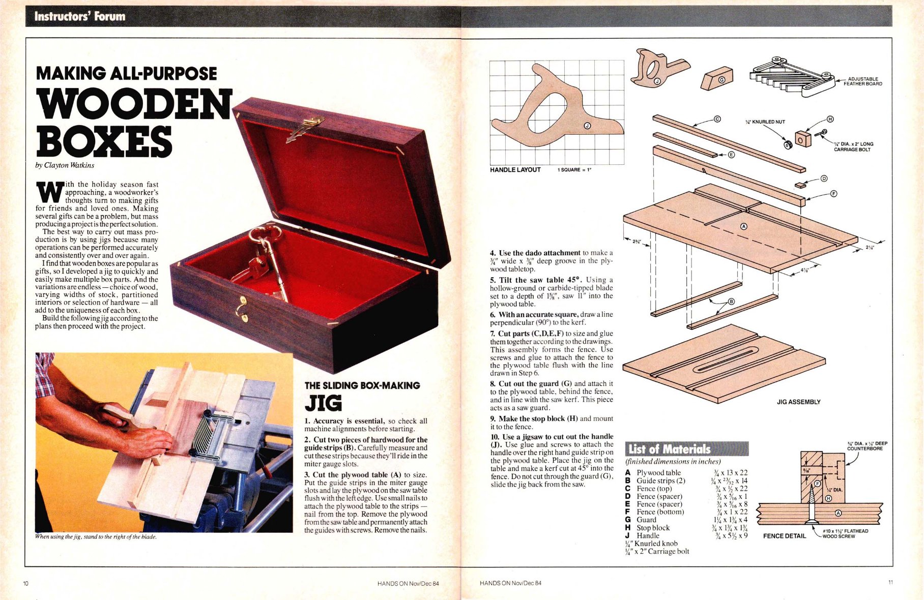

My curiosity was piqued, so I dug out my old copy of the Hands On issue to see what it looked like. I may have to try and make one now.
sliding box making jig 2700 x 1754.jpg (420.28 KiB) Viewed 4278 times
P.S. Try as I might, I can't seem to find a good resolution for viewability and be within the size limitations. If anyone would like a higher resolution version (pdf or jpg), just send me a PM with your email address.

I always have one of my miter gauges set up as a small crosscut sled using 1/4” paneling or Masonite for the bottom. Seems like this would be easier keep square than getting the fence square to the runners on the jig shown above.

That particular sled is not for me, but I could see leveraging the basic idea (which is a cross cut sled) into something I'd like. As a generalization, I prefer taking cuts all the way through past the outfeed end of the blade. This one seems to be intended for either backing out of the cut or stopping the sled and the saw.(?)

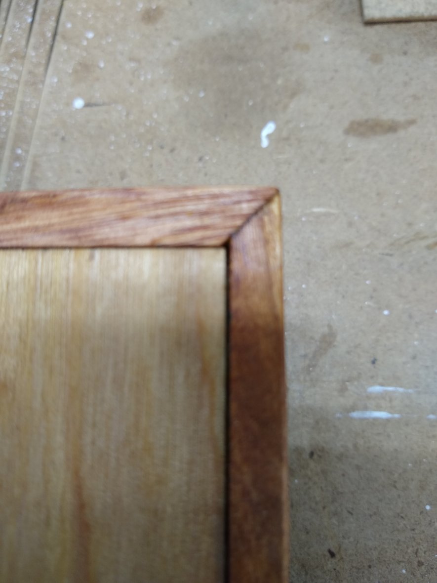

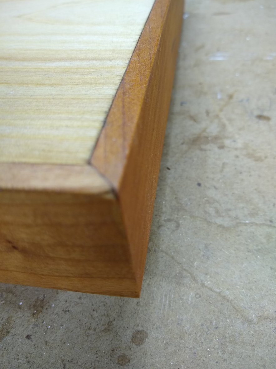

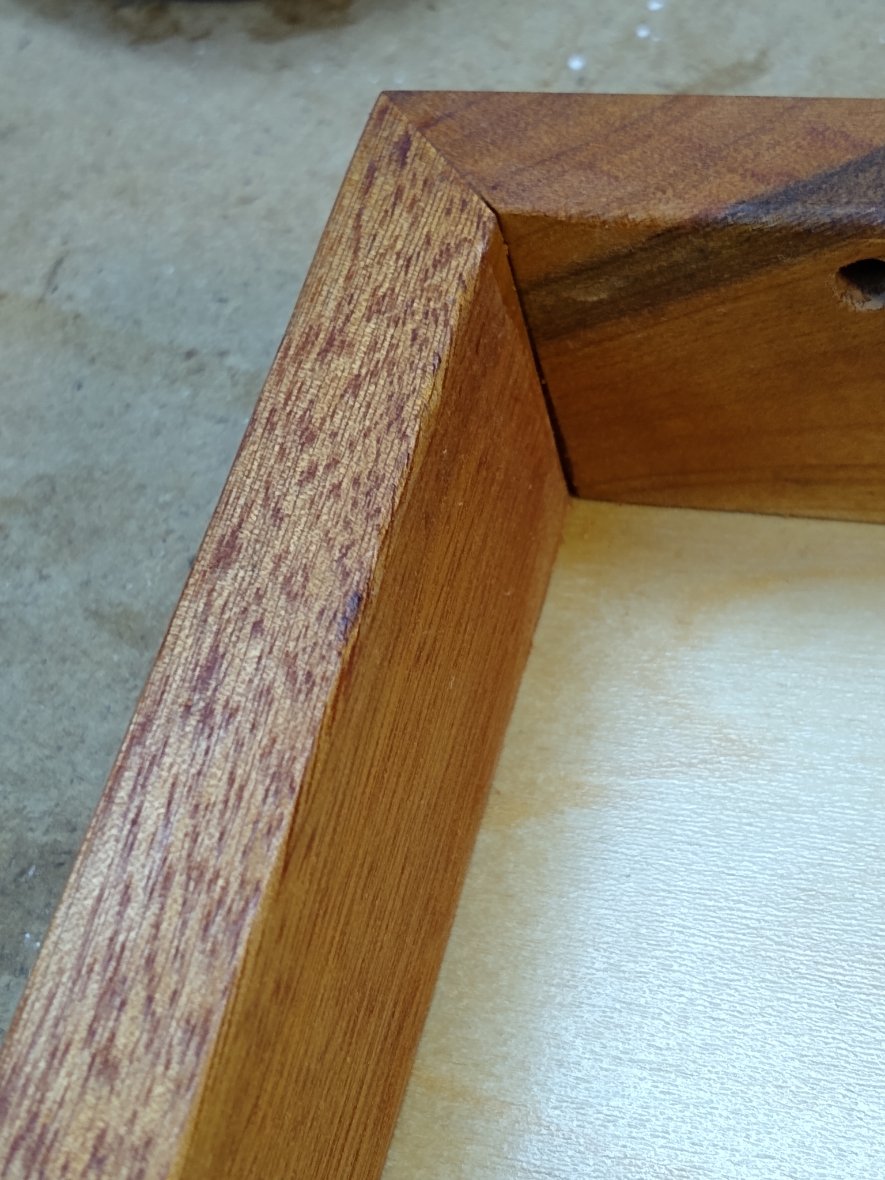

Someone commented that I didn't specify my problems relative to cutting the miters. So I'm hoping I can post a couple of pics, but the focus is eh. On the first pic the corner chipped out. (I used a general purpose blade...maybe I should have used a cross cut blade? Pic 2 looks terrible and Pic 3 the inside has a huge gap.
SSP 1.jpg (116.8 KiB) Viewed 4218 times
SSP 2.jpg (89.21 KiB) Viewed 4218 times
SSP 3.jpg (173.54 KiB) Viewed 4218 times

Random thoughts on achieving perfect miters:
Miters are hard to get right and don't let anyone tell you differently.
The first rule of miters is to start with perfectly milled stock all of the exact same dimensions. That means you joint a face, then joint an adjoining edge to a perfect 90 degrees, then run the opposite face through the planer/thicknesser to get it perfectly parallel/co-planar to the first face and then plane or rip the last edge to be perfectly parallel/co-planar to the first edge. If all the stock is not prepared this way to the exact same dimensions of if there is the slightest twist, warp, lack of parallelism, the mitered corners won't come together perfectly even if the machinery used to cut the miters is set to a perfect 45 degree angle.
I mention this because in the second picture it looks like the two pieces were of slightly different thicknesses. If that's the case I don't think you'll get a good miter even if the angle is set to exactly 45 degrees.
If the work pieces are less than the maximum depth of cut, I'd be standing them up on their edge and using a miter gauge to make the 45 degree cuts rather than trying to tilt the table and cut a bevel because I find it easier to set a miter gauge than the table bevel with the degree of accuracy needed. Angle cubes, etc., are great but their resolution (one of the engineers will tell me I've used the wrong term) just isn't good enough to set and forget. Thus, whatever method you use to set the table tile or miter gauge angle, make test cuts in scrap first. If the miter is open to the inside, the angle was in excess of 45 degrees. Maybe 45.1 degrees. It doesn't take much especially since there are two pieces. If the miter is open to the outside you are under 45 degrees, perhaps 44.9.
Chip out can be prevented by having a sacrificial fence on the miter gauge (if using one) or putting a sacrificial piece of wood behind the work piece.
Getting opposite sides to the exact same length is imperative to get all 4 corners to come together even if the individual cuts are all at a perfect 45 degrees. Re-read the section in Power Tool Woodworking for Everyone on disc sanding to length. Its the best system I've found for achieving this.
Make more stock than you think you need because you will probably botch a piece and need to make another.
