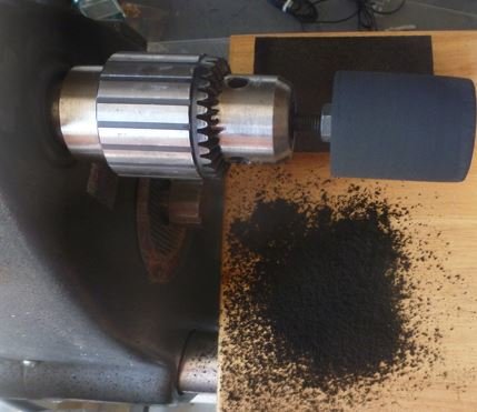

Update: I decided to take a caliper and check the ID for each of the sanding sleeves and the drums. The variance from .54mm to .81mm for each of the drums. They had been compressed for so long that they needed a lot removed. Chucked them on the SS and used a sand pad to take them down until the sleeves would just fit. The talcum powder helped. Almost three times as much as pictured was removed from the three smaller ones. A gust of wind blew it away.
Spindle 2.JPG (27.47 KiB) Viewed 348 times
