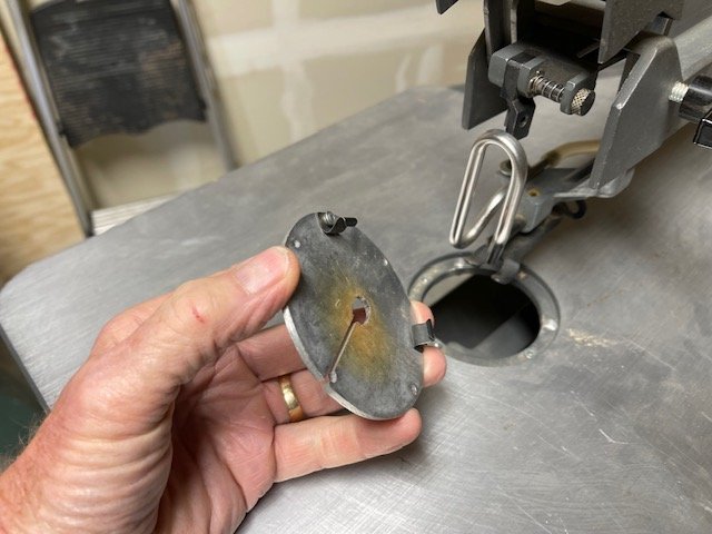

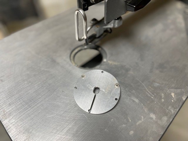

The insert on mine just pops out. There are a couple of spring clips that holds it in place. The four screws under the lip are for adjusting the insert level with the table. Here are a couple of pictures of the insert.

Now I see what's going on with the insert. The two little heads I see are just the rivets for the spring clips. Interesting way to do it.

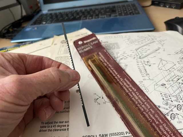

I do have a question for Russ. Do you know if the original style saw blades will work with the quick change adapter upgrade? I have several packages of them: for example part numbers: 555264, 555263, 555262, 555265, etc.

The quick-change blade blocks the Teal Scroll Saw and the upgrade has use the same 5" plain end blades.
