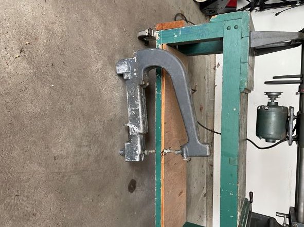

Just took posession of the Shopsmith 10 ER and it came with the Jigsaw. It has not been used for 30-40 years, looking for suggestions on getting it operational. I think I have most of the parts but everything has a bit of rust and won't move. The electric motor does run. It did not come with any saw blades or jigsaw blades and was looking for what size blades I need for the table saw and how long of blades I need for the jigsaw? Also if there are any videos that will help demonstrate the unit?

Table saw blades - maximum size is 8", the more common 7-1/4" blades will work fine.
Jigsaw blades - use 5" pinless scroll saw blades.

Again, welcome to the Shopsmith Forum and congratulations on your new-to-you find. The links Ron gave are a great reference for restoring your Shopsmith Model 10ER and the A-34 Jig Saw. As Ron said the size of the saw blade is 8" and they can be found. Using a smaller diameter blade will reduce the cutting depth but will work if that is not an issue. The Model 10's cannot use larger diameter blades since they are not designed to do so by the size of the table insert opening. The Jig Saw does use 5" Scroll Saw/Jig Saw Blades with the plain end. Do not use Scroll Saw Blades that cut both directions in the up and down stroke.

Thanks for your quick replys. I will try to get pictures tomorrow. I am still not understanding the jigsaw unit, if you use a jigsaw blade are you only securing it to the bottom chuck or is a 5 inch blade long enough to lock it in to the upeer chuck as well? Are you cutting on the downstroke?

Yes, the 5" blade is held in the upper and lower blade chucks. The lower end is powered, the upper is pulled down by tension on the blade and pulled up by the spring. I have used reversed tooth blades on mine, but it does tend to lift the work piece off the table if you don't go slowly.tketzer1 wrote: Sat May 21, 2022 4:19 pm Thanks for your quick replys. I will try to get pictures tomorrow. I am still not understanding the jigsaw unit, if you use a jigsaw blade are you only securing it to the bottom chuck or is a 5 inch blade long enough to lock it in to the upeer chuck as well? Are you cutting on the downstroke?
