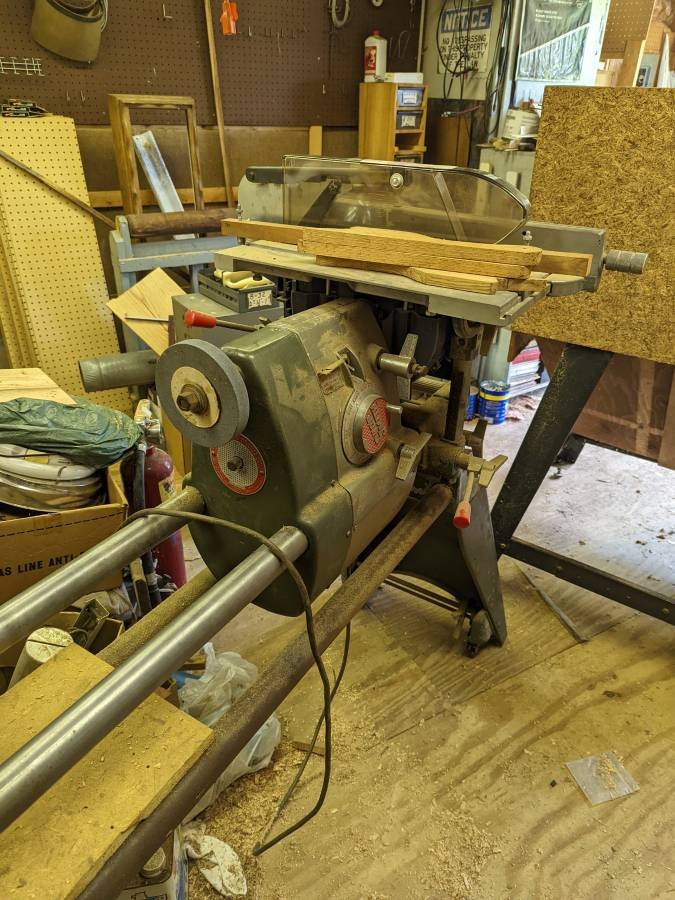

Speaking of Greene, if I attached the picture correctly, the end cover with the Serial and chassis is green, the head seems to have 2 forms of tan, may have been replaced at some point? Not sure if there is any way outside of the serial to understand more.

Yep there is.
You have a "Type "A" headstock. It is the earlier sand cast version(heavier, thicker walls)
The belt cover screws tell the tale. And the wide headstock mold sprue [aka joint].
The two tone casting/motor pan colors is the result of the passage of time.
The saw blade cover(s) is not period accurate, but is an example of the upgradability.
You done good!
