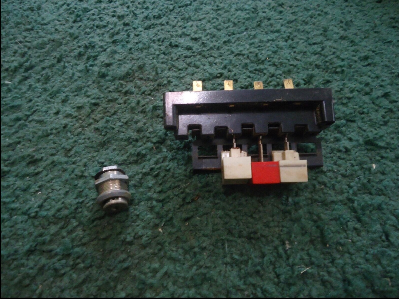

Was able to get a switch and keyed cylinder, that will be my next probable headache,…pic following
Still cleaning parts and polishing, wondering if this phase will ever end….
- 73DF7E98-D217-4B2A-912F-36C5C343708D.jpeg (526.36 KiB) Viewed 2318 times

You're Welcome! Congrats on finding that switch, pretty rare.

Wasn’t cheap and I’m hoping it works. I found a guy that was having a hard time getting rid of one back east and told him if he decided to part it out to let me know. Hopefully it works and I can figure out the wiring from all the info on here. Thanks again my friend.

Did the lock come from the same source and did it include the MVII stuff attached?
Re: Mark VII a start and a long ways to go..
Hi JPG- Everything in and everything from same source in that pic, not sure what you are referring to “ did it include the MVII stuff attached?”JPG wrote: Tue Sep 06, 2022 9:50 pm Did the lock come from the same source and did it include the MVII stuff attached?

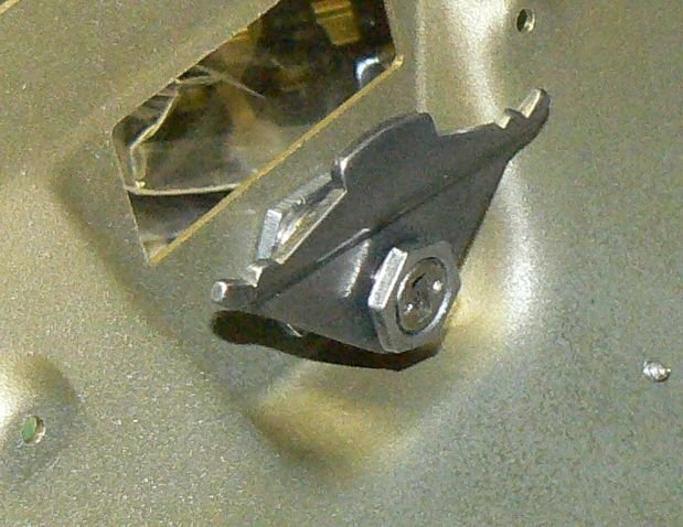

The parts that attach to the lock that provide interlocking of the switch between fwd and rev.
Yes I missed that and thank you for bringing it up. I’ll ask the guy if he has that portion.
