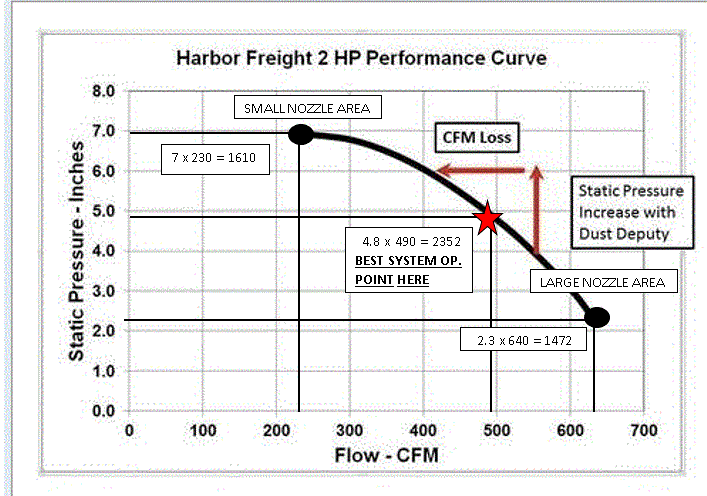

A pressure vs flow "pump curve" describes all the "operating points" of the pump or compressor. Ideally we want to run the "system" (pump, pipes, valves etc) at the point on the curve where the product of flow X pressure is a maximum. The attached jpg, previously displayed, shows (approximately) where that op point is.
Every pump fan, compressor has such a curve, either supplied by the mfgr or can be plotted from measurements.
In reality, keeping the system working exactly on that best op point is impossible. If we want more flow or pressure, we must get away from that op point.
- Capture.GIF (60.18 KiB) Viewed 13468 times

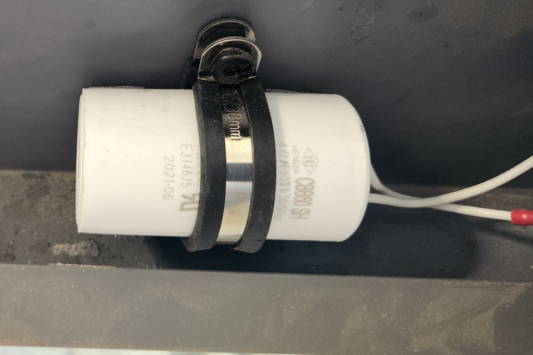

My DC3000 was over 20 years old. I performed the upgrade and am happy I did. My dust collector works better and quieter. I feel like it gave me a new dust collector for half the price of purchasing new.

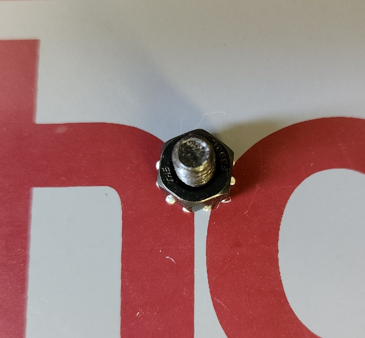

I did, however, run into one problem. After about 2 months of use, the starter capacitor adhesive mounting tape came loose, the capacitor dangled, and one of it's leads came out of the crimp terminal. Shopsmith replaced the capacitor at no charge. This time, I installed the capacitor with a 1-1/2" diameter clamp and am not relying on the adhesive mounting tape. See photos attached.
