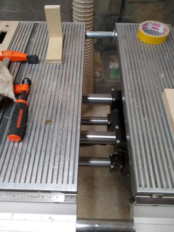

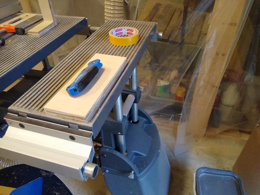

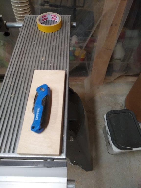

Yea- I don't have anything in the way of doing this on either my main table or my aux table.
Luck of the draw for this particular application I guess.

Thanks. Yeah, for a platform that A LOT of us tend to think of as being unchanging and mostly the same over the decades, surprisingly has quite a few manufacturing variations over the years. I know Russ has done well in quantifying some of these in his posts from time to time for us (thanks Russ!), but still it is hard to keep track of all of the different versions of Mark V hardware. Sorry for any confusion in my prior post, but clearly it wouldn't have worked on my Mark V main table!

On a sample of two 520/M7 extension tables I checked, the front and rear extrusions were slightly proud, on both sides, of the 'straight' part of the table. (Which wasn't all that straight and may or may no be true to the blade.) This would be easy to remedy, but this ain't for me. It's a variation on the guide strip method that typically runs the strip on the fence, for me the con's outweigh the pro's. Mainly because I want to be able to observe that contact between the strip and whatever is acting as the fence so I know I'm guiding it straight and can adjust if needed.
