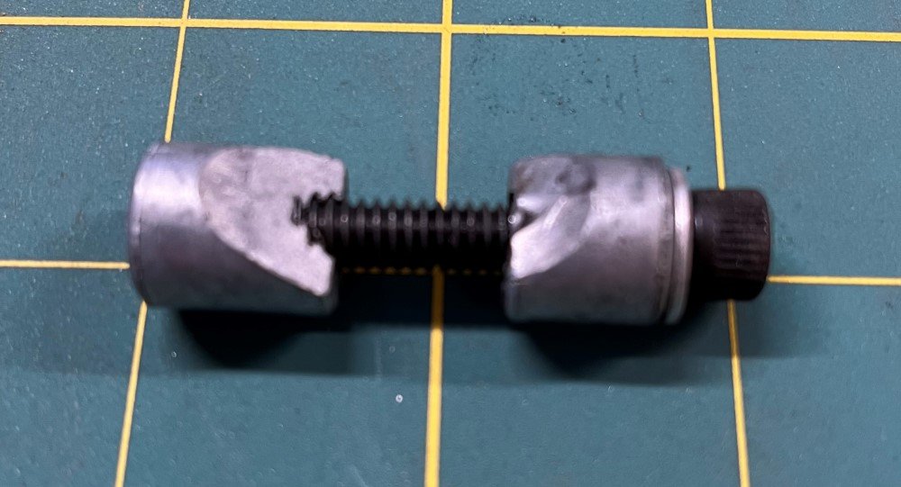

I went out to the shop and measured the wedges in case you wanted to try and make a pair. They are approximately 35/64" in diameter. The plain wedge is 1/2" long and the threaded wedge is 5/8" long. They are a soft alloy metal. The Screw 505583 is 1/4" - 20 x 1-1/2" long using a 5/32" Allen Wrench. The pictures below show the wedge parts and the wedge parts assembled.
Wedge Parts.jpg (192.61 KiB) Viewed 1095 times
Wedge Parts assembled.jpg (83.23 KiB) Viewed 1095 times

Making your own replacement I would think aluminum rod may be a suitable material. You might be able to use 1/2" rod stock which may sit a bit loose in the Jig Saw Base but still provide enough grip to keep the arm in place. You could use a slightly larger rod stock (9/16") if you can find it and "size" it down to the correct diameter to have a better fit. When I measured the wedges, they are just under 9/16" but test fitting as you go will get them the needed diameter.
