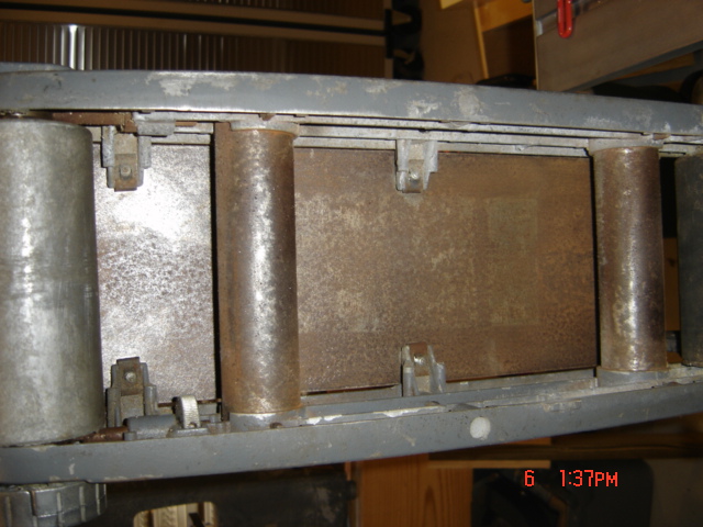

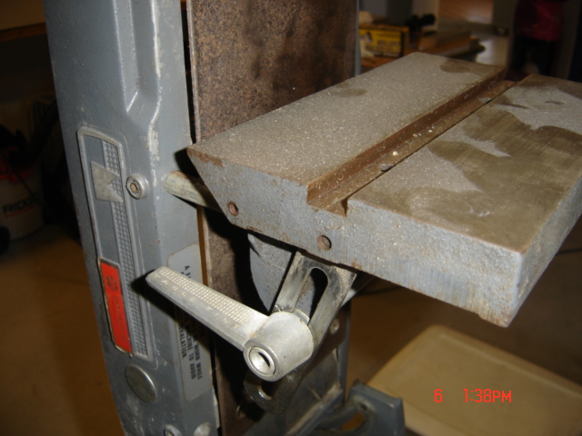

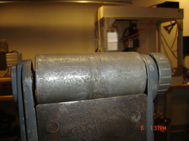

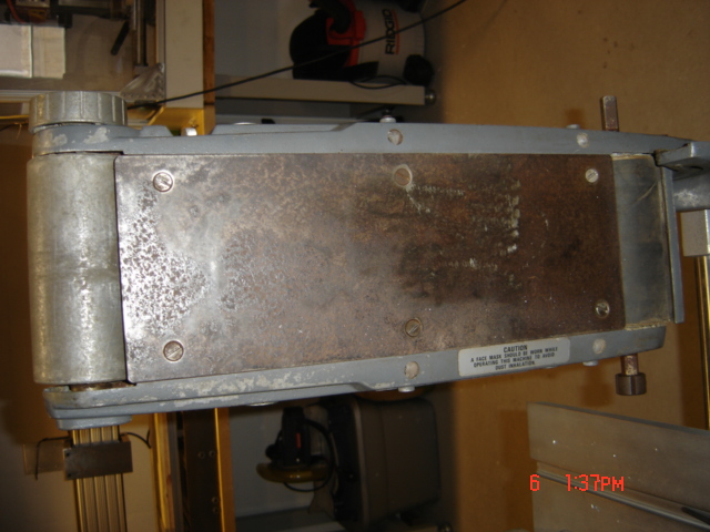

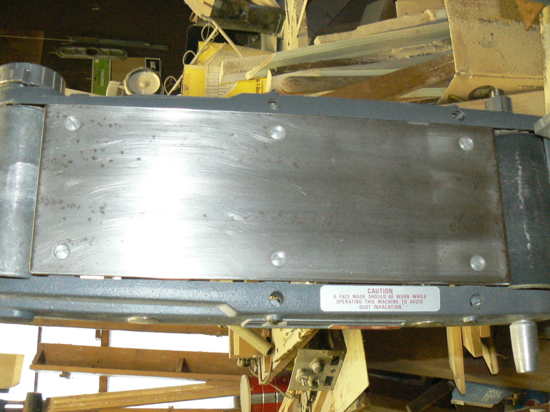

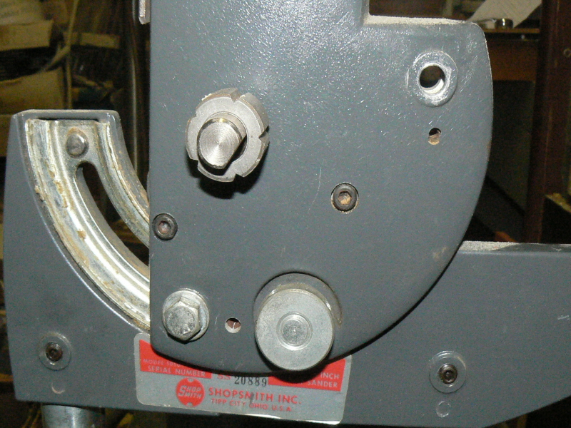

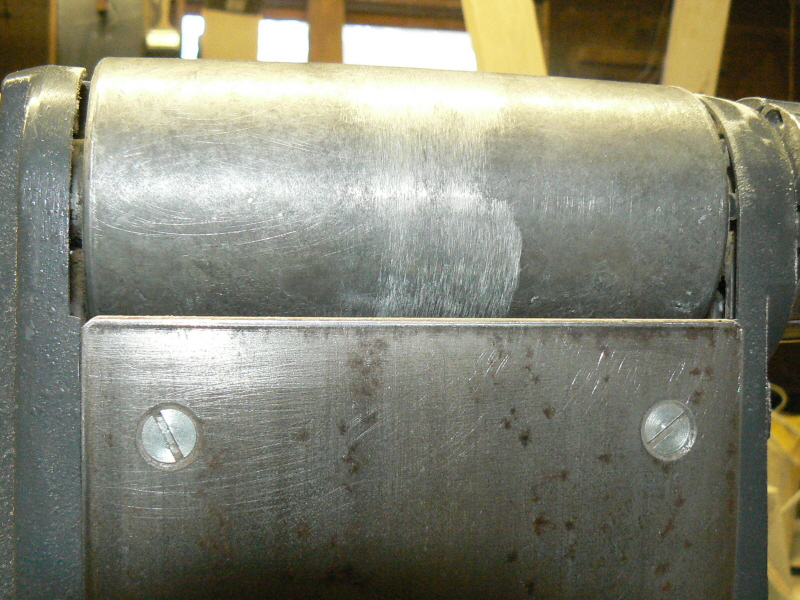

Well I have finished up a MkV a few month ago and now it is the belt sanders turn. I have looked over the part breakdown and a few photos I can find online of the Belt sander but I feel I am missing something. I have 2 empty holes around the pivot point and the pivot point tightening nut doenst have a handle. I dont know if it is suppose to or not but if someone could take a picture of this area I would be more than greatful. I can also document my progress to let everyone know how it goes and how it turns out. I plan on doing a complete dissasembly with complete stripping and alodine and painting. Let me know if your interested. Josh
- DSC02551.JPG (156.13 KiB) Viewed 9956 times
- DSC02555.JPG (147.59 KiB) Viewed 9947 times
- DSC02554.JPG (132.87 KiB) Viewed 9934 times
- DSC02553.JPG (144.57 KiB) Viewed 9932 times
- DSC02552.JPG (135.95 KiB) Viewed 9932 times

Regnar,

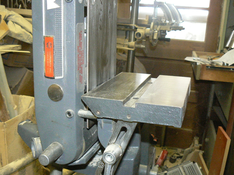

The two extra holes are for a 3/8" x 2" bolt and washer set to give better rigidity in the vertical and horizontal position of the sander. You will find them as #76,77,78 in the parts breakdown. Your 5/32 hex key serves as the handle for the trunnion lock #36. Have fun rebuilding it. Great little sander.
ldh

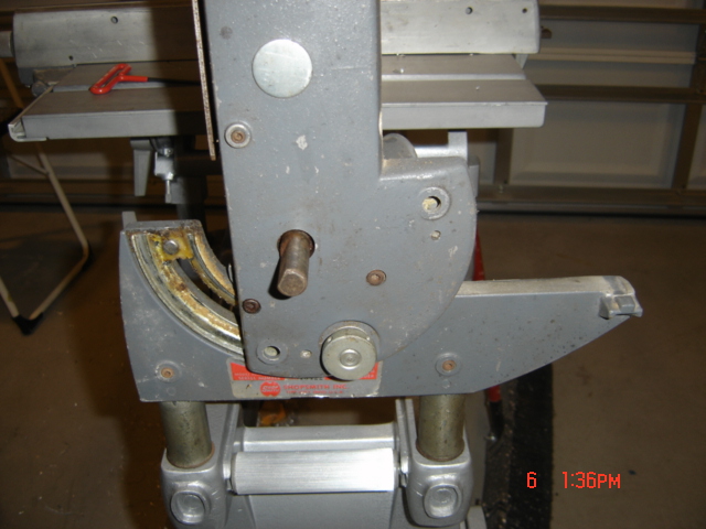

- bs1.jpg (358.12 KiB) Viewed 10009 times
- bs2.jpg (375.85 KiB) Viewed 9961 times
- bs3.jpg (350.02 KiB) Viewed 9944 times
- bs4.jpg (366.28 KiB) Viewed 9944 times
- bs5.jpg (374.26 KiB) Viewed 9946 times
Regnar - not to worry about the missing 3/8" bolt and nut. I have never needed mine. It comes with a tag on it saying it can be used for more stability if needed. Found mine in a drawer the other day. Had completely forgotten I had that part. Got by 10 yrs without it.
