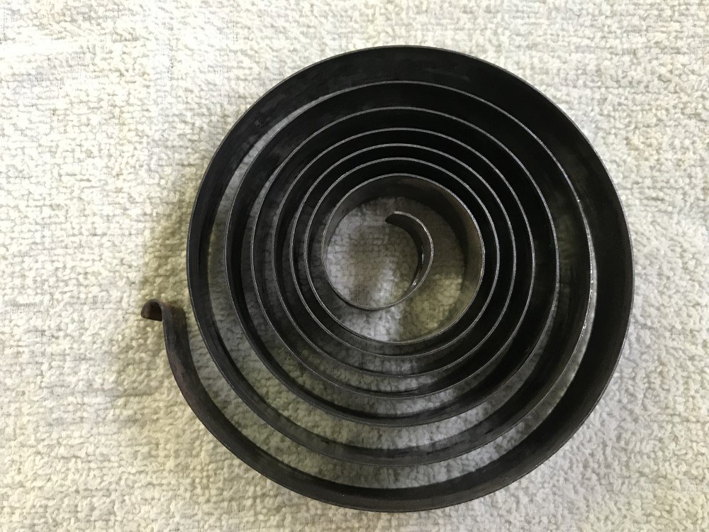

Below is a picture of a relatively good Quill Return Spring from a Model 10ER. The narrow end of the keyhole is closest to the end of the spring. As John said the Quill Return Spring is the same for the Model 10's as it is for the Mark Series Headstocks today. I used a new, from Shopsmith, Quill Return Spring a few years ago in a Model 10 restoration.
_ .
Putting a new keyhole in the old spring will only "cost" you some time and effort. I have done that and it worked fine, just a bit of a pain to do.
_ .

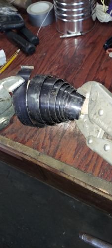

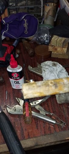

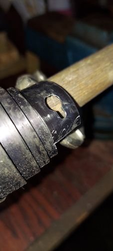

I was able to get the spring keyhole remade into the existing spring.
I removed the spring from the housing a spread it along the axes on a 1 inch wooden dowel and clamped it to provide a way to control the spring.
Then I lifted the interior end over the coil and it helped stabilize the spring in a position where I could drill. I took the original broken off piece of the spring and straightened it out to get the dimensions for the keyhole. The spring material wasn't very hard, a standard drill bit went through without issue, I did a test hole in the broken off section first.
I drilled out two holes at the same size as the minor diameter for the keyhole then drilled the larger diameter for the clearance hole. I used a small Dremel cutoff wheel to complete the slot. Caution when drilling the larger hole, take you time the spring material burrs easily. To reinstall the spring into the housing, I put a small screw into the side of the 1 inch wooden dowel and hand wound the spring until the diameter was small enough to slide into the housing. That was a little dicey!! if the spring would have made its way loose. I ended up reinstalling the spring twice, because I didn't pay attention to the orientation the first time. ugg!! Next step is to get the spring to be relaxed at a smaller diameter, thinking a tee handle with a screw in the side and keep turning until the spring returns relaxed at a small diameter, as JPG recommended. that's tomorrow, need to cleanup the shaft for reinstallation first, some burrs and damage on the handle ends to touch up, cleaning and rust removal.
Thanks everyone for the help and recommendations,
Tom
Tom
