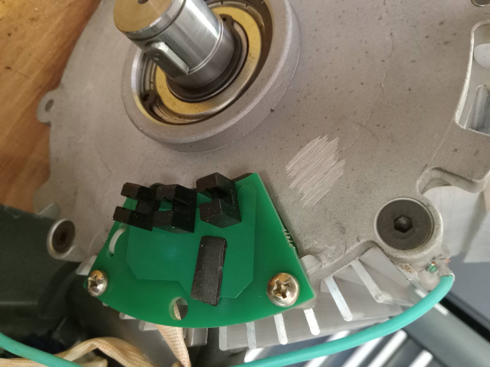

I have some PowerPro maintenance to do today (got the Power Supply I ordered in March) so my curiosity got the better of me:
Cable disconnected, system reports RPS State Error 1.
Fan removed (no sensor(s) blocked) system reports RPS State Error 1.
All sensors blocked, system reports RPS State Error 0 (but only if commanded to run).
Corrections and observations: Regular snap ring, not an "E" clip. There are eight mechanical features on the non-fan side of the fan for RPM/position detection, not six as I said earlier. Three sensors was correct. I don't think the fan can be out of position as the SS documentation suggests. There is a seat to prevent it getting too close and the snap ring. There is very little free play for the fan to move axially on the shaft. SS's descriptions are correct, at least for the PowerPro, in terms of all light paths blocked relating to "0" and all light paths unblocked relating to "1."
ETA Pics of Sensor and Fan Features
Note: I couldn't see any circuitry on the sensor board beyond the IR Receiver/Transmitter devices.
- David

Good analysis and thanks for looking into thi. Should I edit my prior post and take out the Teknatool stuff or at least put a disclaimer for it so it doesn't confuse future readers? It is possible that the Teknatool version differs from the PowerPro, i.e. they could have easily swapped the two in digital HW implementation and/or firmware. Could also be a documentation error on their part.

I'd say leave it as is or add a disclaimer. Shopsmith doesn't publish as much info as Teknatool, I think we should keep what we have unless it is known to be wrong. It's as you say, I don't necessarily think Teknatool's info is wrong, just doesn't apply to PowerPro. Even a different signal name could change whether 'light path 2 blocked' is a 0 or a 1.RFGuy wrote: Mon Nov 07, 2022 10:02 am David,

I would suggest that this is characteristic of Shopsmith. They have historically had items that are unique to Shopsmith. The motor on the 510 is but one simple example. It is a standard motor except for size, shape and mounting; otherwise just a 110vac motor that runs at 3450rpm (except for some that run at 3580rpm (as does mine).
I would bet that Teknatool treats the Power Pro as "proprietary". Try to order parts direct from them if you can even identify the Teknatool PN that you need. I tried, years ago, to order parts from Emerson and was told by Emerson that they sold those part only to Shopsmith.

The Shopsmith Wiki has a page on the RPS Error 0 problem. It consolidates much of the info in this thread, but no comment regarding the RPS Error 1 condition. It does seem like a disconnected or faulty cable is a likely cause of RPS Error 1 reports but there must be potential causes much worse than a simple cable problem.
