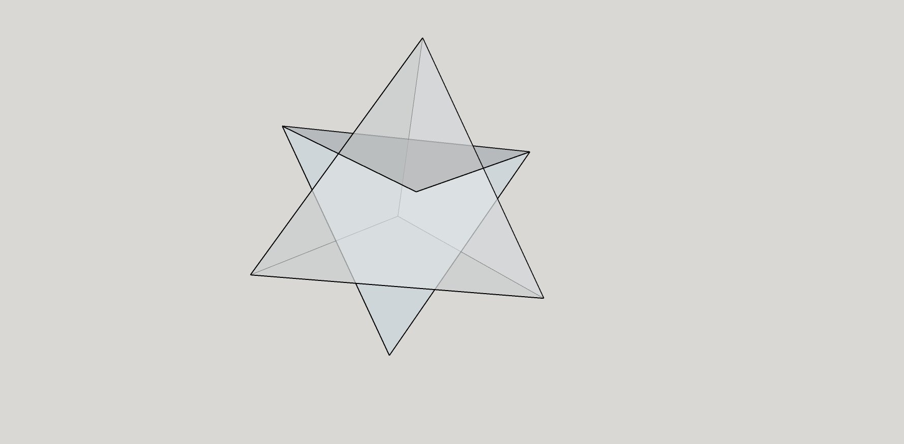

]Thanks for the challenge. Now that I can draw it maybe I can make it.

Re: Three Deminsional Eight Pointed Srar
JPG wrote: Wed May 03, 2023 6:54 pm Ahhh - so it be a solid, not any of that other stuff?
It be a solid if you make it that way but that is not what I intended.
`Star Not a Solid.jpg (27.3 KiB) Viewed 7896 times
Whatever is wanted:
`Star Not a Solid Unless You Want It to Be.jpg (33.17 KiB) Viewed 7894 times

Just to be clear a pyramid can have a square base, a triangular base, circular base or any other polygonal or otherwise shaped base. Triangular based pyramids are common, though I guess when I said I saw pyramids intersecting in the earlier picture, some may have assumed I meant a square based pyramid like an Egyptian pyramid as an example. That was NOT what I meant. FYI...a triangular based pyramid is ALSO known as a tetrahedron, but a tetrahedron is a special type of triangular based pyramid in which all edges are of equal length and all angles are equal, so it is a subset. IF Glenn's construction on this thread has equal angles and equal length edges (before merge of course), then it qualifies as a tetrahedron. Otherwise, it is the merging of two triangular based pyramids.

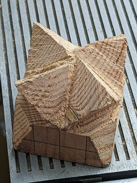

I'm running out of scrap wood (aka, cutoffs) trying to figure out how to cut one of these.

I have half of one of these emerging from a block of pine. It's rough, I started with some unnecessary cuts, you can see that on the bottom corners. It's only material that would get removed later from other cuts, but it helped me solidify the concept in my head. Glenn provided enough hints on how to make this. If I make another one I'll take pix of each step. It's not that difficult, if I can work out the compound angles it should be workable on the bandsaw. If you do this with a handsaw make sure you have a good sharp one. Wish I had one right now. Some useful info about this shape: Glenn already pointed out that it can circumscribed by a cube. There's also a square formed by the points where the two tetrhedra intersect.
