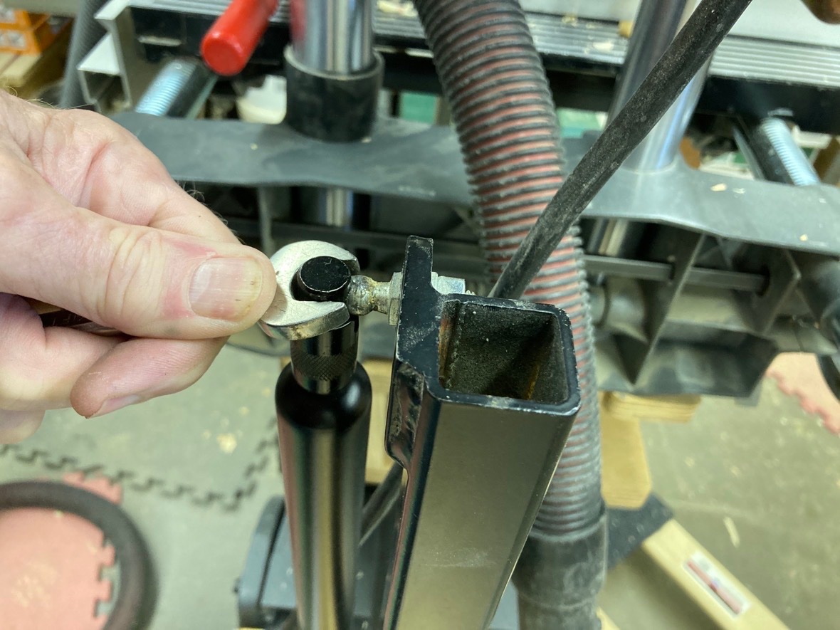

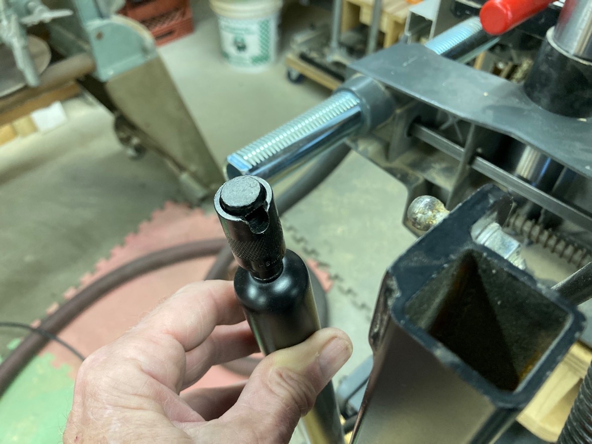

. Some days my fingers won’t grip and push the quick release so I use a wrench for extra push. You do disconnect it while it’s fully extended and in drill press mode? I slide everything to the right, tip up to drill press mode and disconnect or reconnect.

Thanks Larry - I havent tried the wrench method- next time I'll give that a try !
