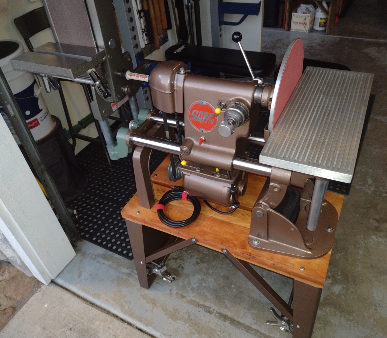

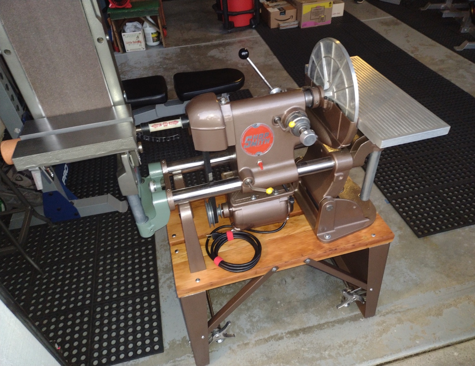

A model 10 makes a fantastic dedicated drill press as well as a dedicated sanding station.
Re: Am I missing any valid reasons to opt for a traditional drill press instead?
YEP! All one needs is a couple of very rare spt adapters for a M10.
OR
Make one a sanding station from a very short M5/V

As for DarrenDD's Sanding Station it is a beautiful looking tool but as JPG said
JPG is referring to the green mounting bracket aka the Power Mount Adapter "A" and the special Headstock Pulley with the Power Coupler Hub molded on. As noted, these are rare items for the Model 10's actually made for them after they were out of production to use the SPT made for the Mark 5.
EDIT:
DarrenDD is actually using two of the Power Mount Adapter "A" brackets. The second one is for the Extension Table.

That is a beautiful sanding station!!! I tried to find a 10E/ER in my area for a while but could never find one either for the right price to fix up and/or in decent condition. I really wanted to have one as a dedicated, mounted on the wall drill press, but I must say that dedicated sanding station is impressive. If only I had more floor space in my small shop to accommodate one... :(
