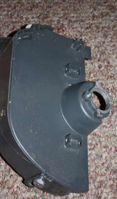

Check out http://www.shopsmith.com/ownersite/catalog/sn_dustchute.htm or search on part # 555167. It is the part you need without the extras. They can be moved over from the bent one.
Jim in Bakersfield:D
jimthej wrote:Check out http://www.shopsmith.com/ownersite/catalog/sn_dustchute.htm or search on part # 555167. It is the part you need without the extras. They can be moved over from the bent one.
Do I understand you correctly? This 'model 500 DUST CHUTE' is a subset of the lower saw guard?
I think 521981 is the part he needs. #213
http://www.shopsmith.com/ownersite/part ... 10_520.htm

Jim, thanks for that link... Is it the same? At least they have it in stock.
Tim, Ahhh, got it.

Yes it is. I got one before I did the 520 upgrade.The picture shows all the correct holes, lugs and other parts.

On order (with a few extras!).
Thanks for that tip - I was bidding on one through eBay, but the price with shipping got to more than this new unit. Shipping to Alaska can be ridiculous to say the least.

colday wrote:Just bought a 2004 model Mark V 510... Yippie!
Did a complete cleaning & PM as it has been largely neglected for most of its years. Got to the part about setting up the Upper Saw Guard Assy (514336). No matter what, the Riving Knife will NOT line up with the saw blade. It seems as the back side of the Lower Saw Guard Assy (514358) is angled sharply towards the headstock.
This can be best told with pictures...
See: http://gallery.me.com/colday#100006
(Must read up about posting me.com linked photos!)
The item clamped where the riving knife should be (photos 1, 2 & 6) is a metal rule (not bent!). In photos 1 & 2 the saw blade is pulled out from the arbor enough for the rule to contact the leading edge of the blade (as not to bend the rule {no pun intended}).
A bit confusing - but hopefully they make sense to some of you.

This can't be right, is it?
The budget officer & the LOML has authorized the purchase of a new Lower Guard (as this IS a safety item), but I do not want to spend the $ just to find that it IS me.
