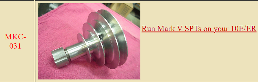

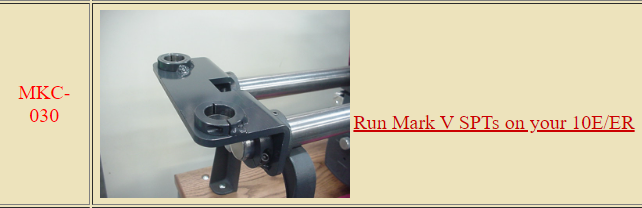

It just dawned on me when you wrote that your jointer drive pulley is 1 3/4 that the model 620 appears to uses the SPT drive and not a pulley, fortunately Skip is making me new pulleys with his optional SPT drive adapter, will that SPT adapter line up and work with the 620 mounted with my adapter kit or do I need to find a pulley for the 620 jointer?
I spoke with Skip yesterday checking on my order and he said that a new supplier for his SPT adapter mount might be working out but got the impression it would not be anytime soon, correct me if I am wrong but wouldn't Skip's SPT mount and drive pulley adapter allow me to add most any SS model jointer and bandsaw option to my machine.

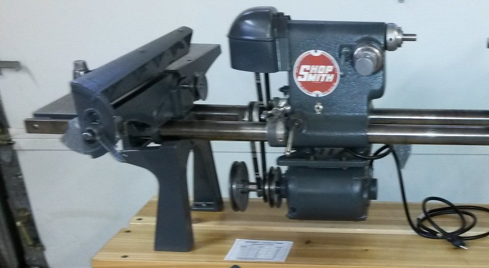

Below is a picture of my Model 4E Jointer mounted on my Model 10ER. As you can see the Jointer's shaft does not align to the Headstock's Drive Sleeve. All Magna/Shopsmith Jointers from the Model 4E through the current model have the shaft from the Cutter Head in the same position and can be driven either by a pulley or the Hub and Power Coupler from a Headstock or Power Station. Having the Jointer mounted on the Jointer Mounting Kit you have to use the special Motor Pulleys and a Pulley on the Jointer. Incidentally the picture is showing a larger than 1-3/4" pulley on the Jointer as I hadn't found the correct one when it was taken several years ago when the Jointer was restored.

Using Skip's SPT Mount and his special Drive Sleeve Pulley you should be able to use any SPT except the Mark Mount Planer on a Model 10. Do understand it may require different length Mounting Posts than the tool originally came with to achieve the correct alignment from the Headstock Drive Sleeve to the shaft of the SPT. Since Skip only has the one SPT Mount similar to the "A" Adapter you will have to adjust Mounting Posts for that. I cannot confirm if all the SPT's can work on this single Adapter. Skip would know.
The 2nd Power Mount Adapter Kit (see attachment PDF instructions below) came out as more Add-A-Tools (SPT's) were introduced and included an "A" and "B" Mount, the Special Headstock Pulley with Integral Hub and a pair of longer Mounting Posts for the Jointer. At the time all SPT's had straight Mounting Posts. Some with snap rings like the Jig Saw while others had stop collars like the Bandsaw. The stop collars allow more adjustment for use on the Power Mounts. Eccentric Mounting Posts could offer additional challenges.

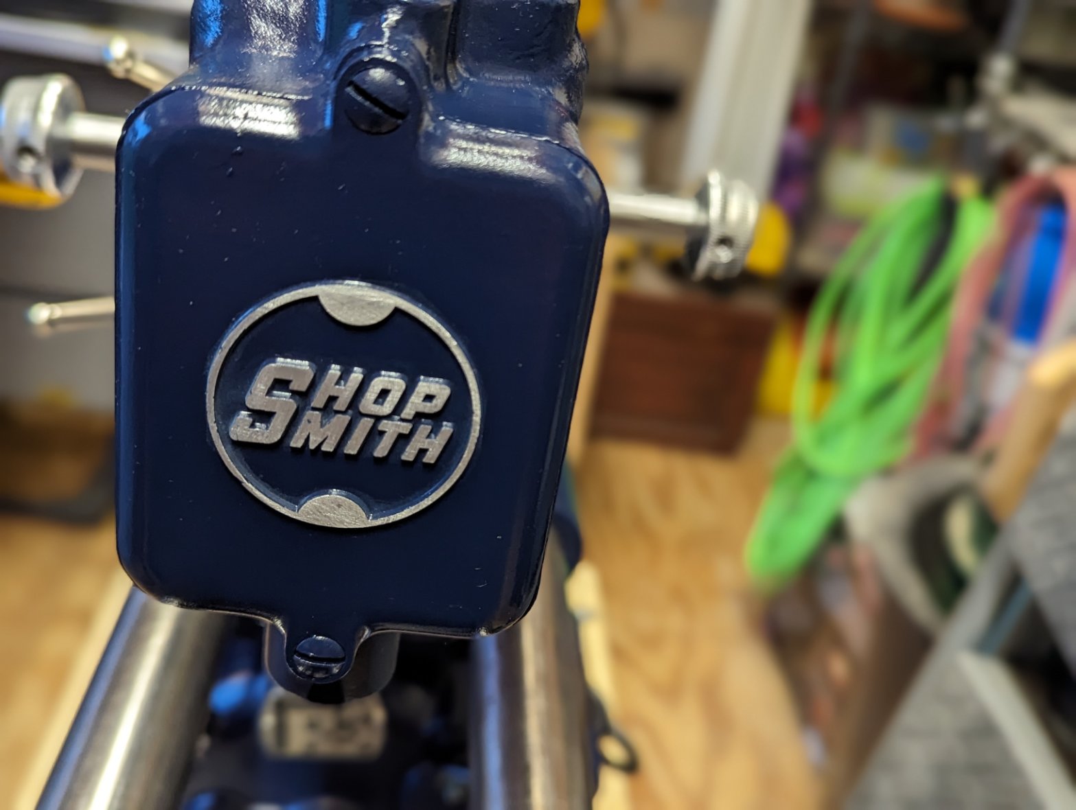

Restoration is almost complete as I finished refurbishing the jigsaw yesterday, just need a few parts from Skip to call it done! Thanks for the pics of highly detailed restoration on this board as I don't feel toooo obsessive after seeing some them.
