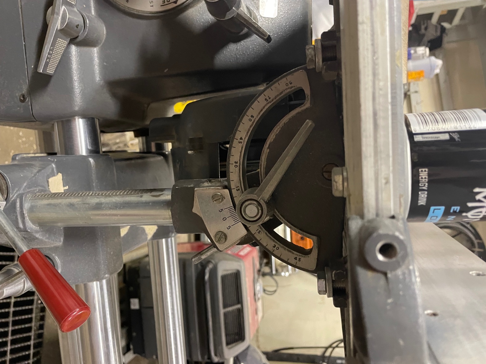

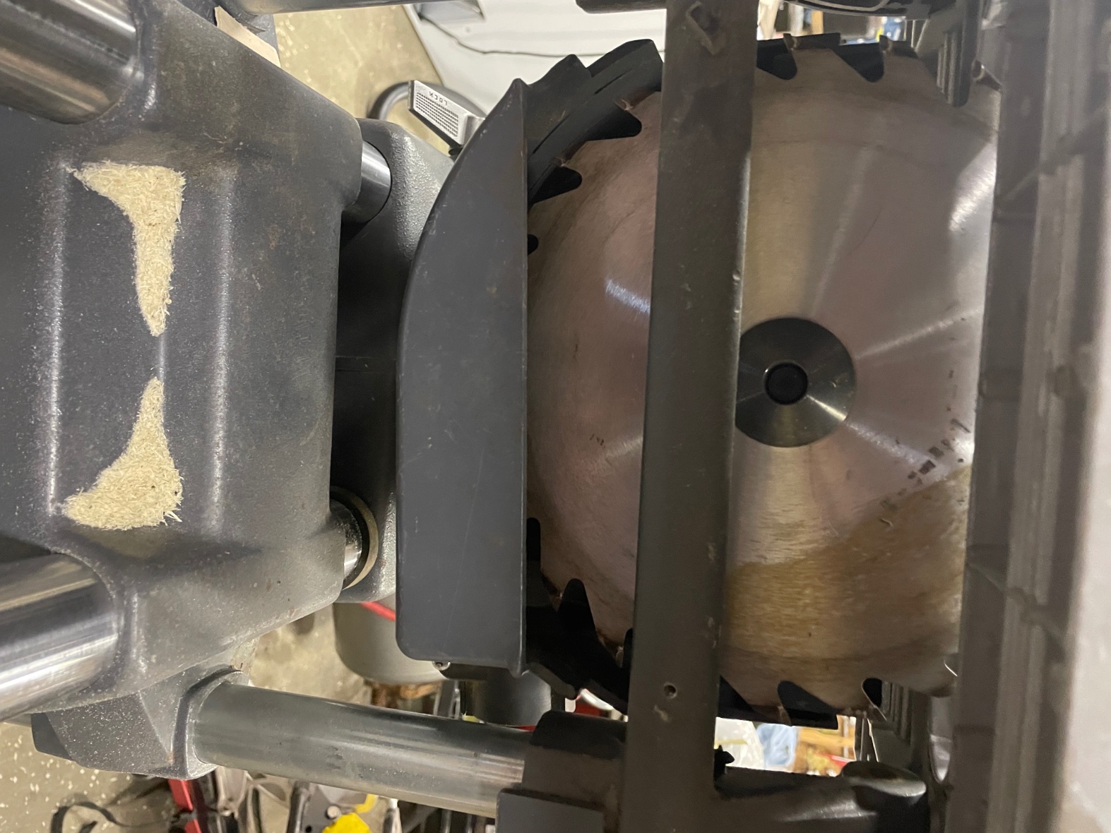

That seems like a last resort and you've only just begun the process. Since you used the lathe feature, how well were you able to align centers on the headstock and tailstock?
I was able to align those to as close to perfect as I could imagine getting when viewed from both the side and from above. It took a few attempts but it came together.
Ok, we can now see you have the 500 table system. If you had no trouble aligning the lathe centers you can still check your measurements again with the headstock and table in different positions on the way tubes. If there are no other alignment issues you can detect then perhaps you will need to provide more adjustment space in the trunnion bolt holes to get it right.
That extra wooden device is interesting though. I assume that was intended to improve table stability, and I would assume you've made sure that wasn't a factor in the alignment either.

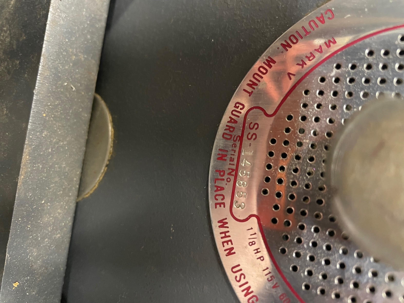

From what you have posted so far you have a Mark V with the original Table System that predates the introduction of the Mark V 510/505 Table System and the original Table System being called the 500. If you want to know when it was made post the serial number or refer to the chart below.
_
Mark V Serial Numbers.pdf
(138.9 KiB) Downloaded 499 times
If your serial number is lower than SS18859 than it was made prior to January 1978. Starting with Shopsmith Inc. in 1973 those serial number have SS as a prefix. The serial number along with other information like the manufacturer is found on the Vent Plate on the Belt Cover where the lower shaft comes through.

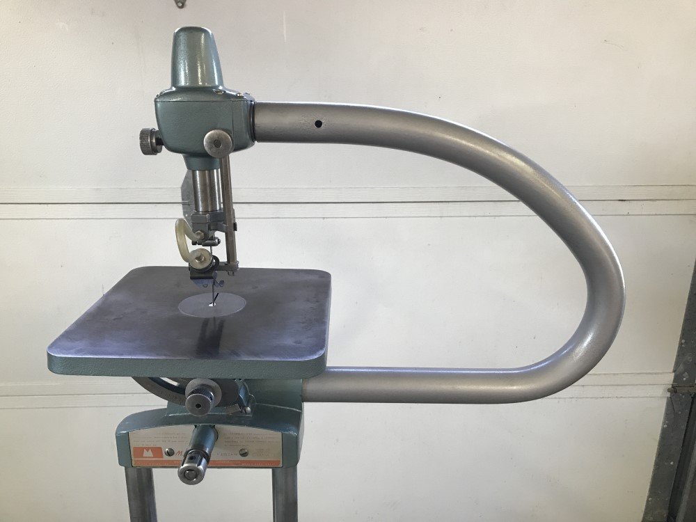

You mentioned having a Jig Saw (Scroll Saw) so if it is the Jig Saw a word of warning - DO NOT USE IT WITHOUT OIL IN THE GEAR HOUSING. Below is a picture of a Magna/Shopsmith Jig Saw for reference. It differs from the Scroll Saw in how it functions and maintenance needed.
_
Jig Saw 1957 Greenie.jpg (84.21 KiB) Viewed 2920 times
This one made in 1957 may not look exactly like yours which is likely gray with a black arm but functions the same. Hopefully you have manuals for all the SPT's (Jig Saw, Bandsaw, etc.) that came with the Mark V.

One thing that I noticed today while fiddling around with the system is that both the blade and the table significantly shift when the tube clamps are engaged, which surprised me a fair bit. I’ll have to dig out my dial indicator to see just how much.
I got the table aligned to the blade as near perfect as I could make it, squared the fence to the table, and things would still end up in places other than where I set them if the power head clamps or the table were loosened then retightened (without moving the unit from left to right) so I’m a bit flummoxed by that.
The pivot point for the table and the post clamp tubes are all tightened and not sloppy/worn out etc. their sockets are all tight. The unit appears to have seen very little use. I am going to inspect the frame tubes next just to see if they are true and properly seated and tightened at the legs.
Anyone else have ideas as to what causes a situation like I described?

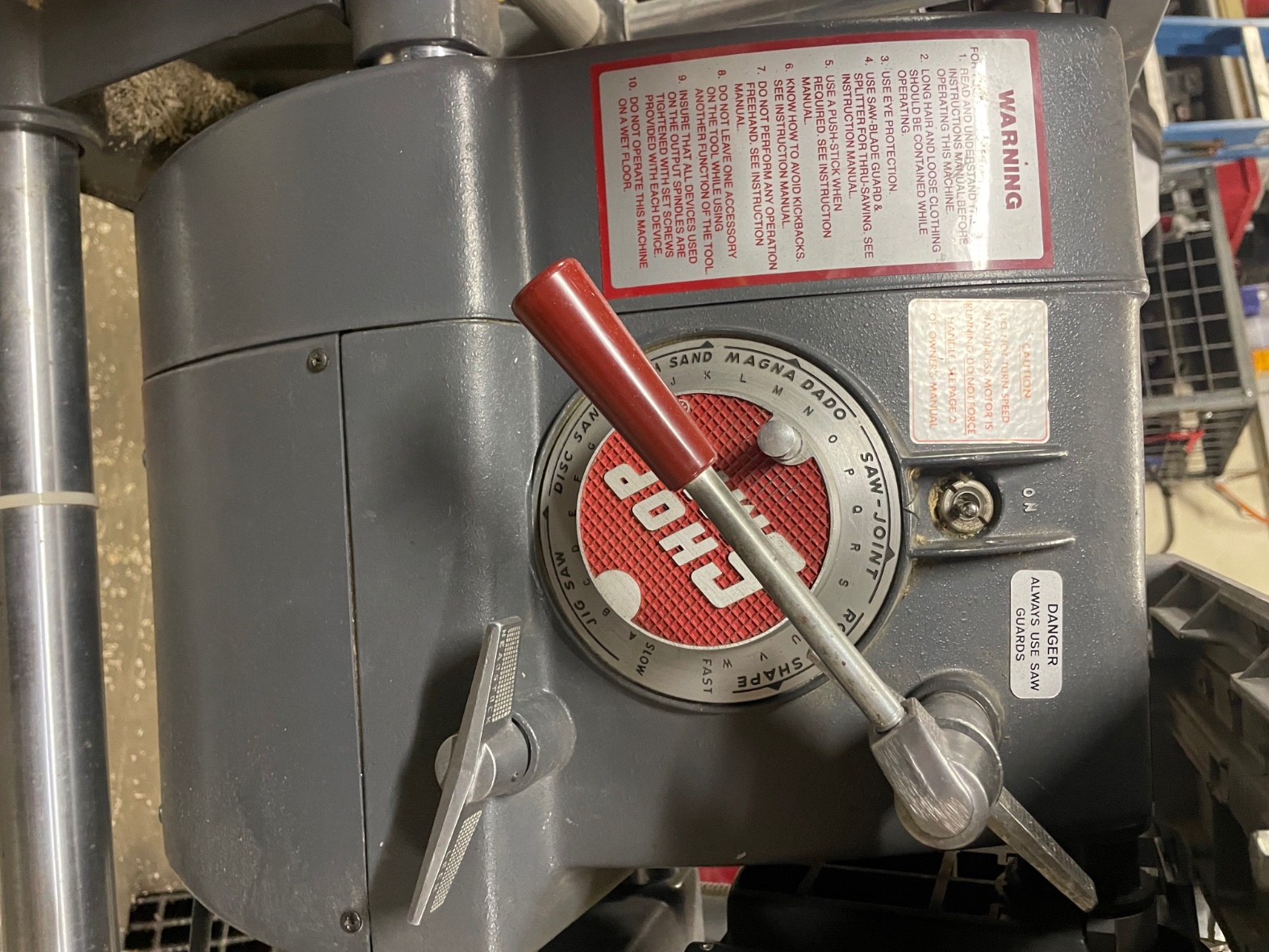

Proof of existence and authenticity is now posted, the serial number indicates a build date of March 1983.
