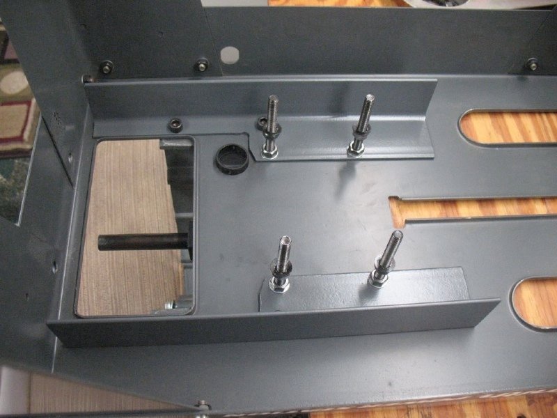

There was a thread some time back where someone (I can't recall who) added angle iron stiffeners to the underside of the bench as shown below. It may be able to be used on the Crafter's Station depending on any interference with the mounting of the Carriage. The Carriage bolts through the bench top in the same area where the angle iron is.

Bracket dimensions are shown in the PDF attached below. Make the second bracket a mirror image of the first.

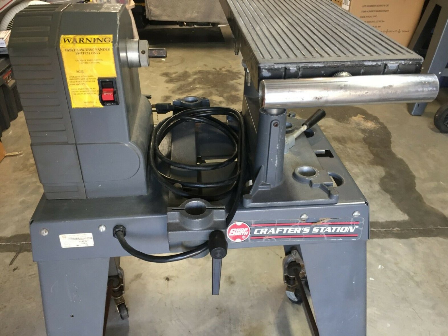

As for the "Carriage" you are right there is not much to it. The "Carriage" for those of you who are not that familiar with the Crafter's Station, can be seen below, under the power cord. There is no raising or lowering mechanism for the table like there is on the Marks. Mine came with Collars to help with setting the Table height but if I decide to use it much, I may get a pair of Adjustable Stop Collars for it.

The Crafter's Station was designed off the Power Station so there were limitations on what could be done. It certainly can't provide all the functions of a Mark V nor was it intended too.
